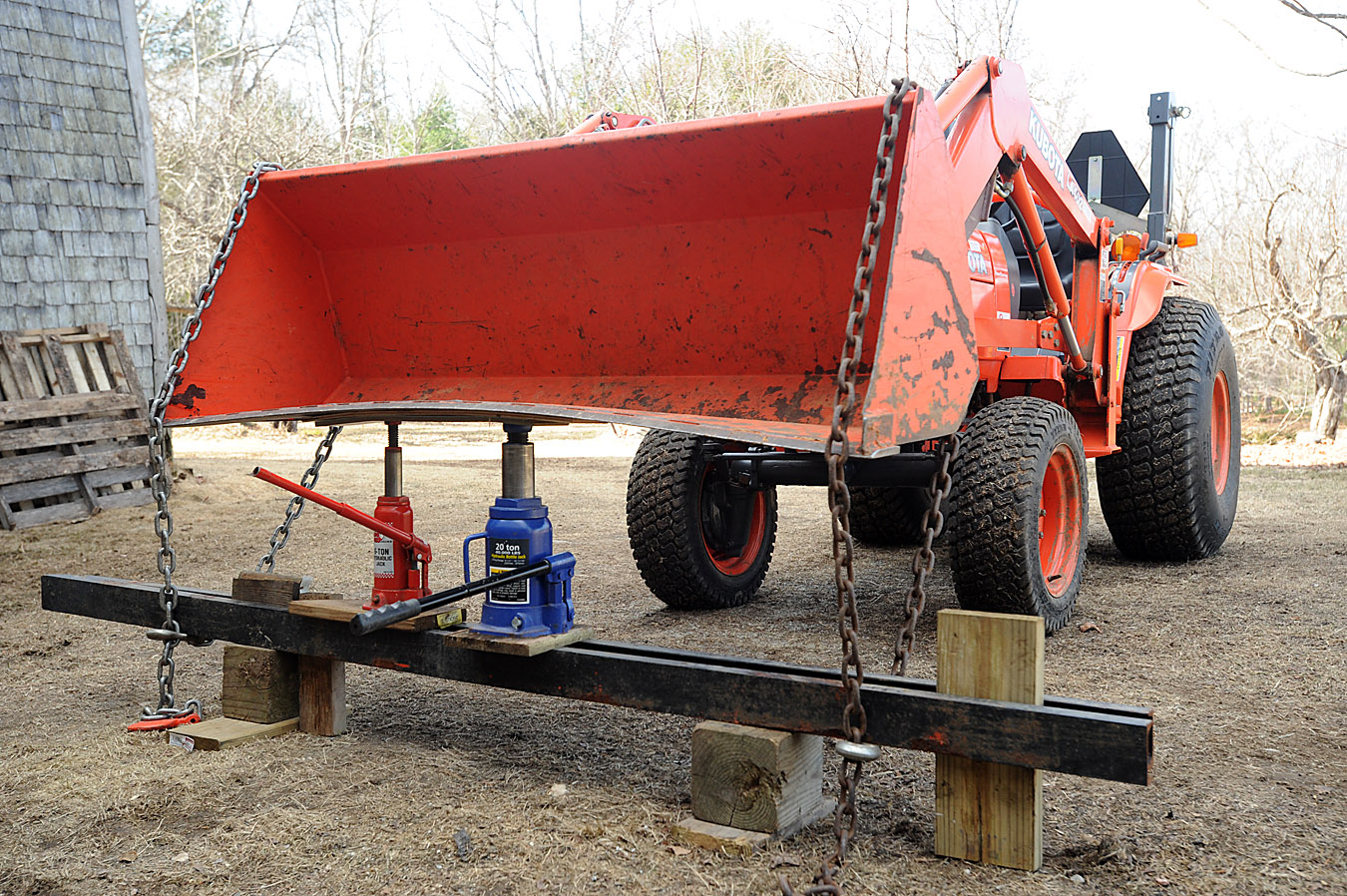

/ Oops Bent Bucket #28
That can be bent back. I don't think I would use the hydraulics to try and straighten it out. If you can get a good sized bottle jack wedged in between the top lip and the bottom edge. Maybe use a good strong piece of steel to fill the gap between the jack ram and the bucket edge. Just watch so that the jack doesn't pop out at you.
Hey at least you are alright. Getting caught between the bucket and tree would have left a real impression on you...:confused2:
I bent my bucket like that. I used a 20 ton bottle jack (Harbor Freight) and some 2x6s as cribbing to bend it back. It is very straight now. I have the top of the bucket reinforced with a piece of angle iron welded on, so pushing on the top of the bucket was no problem.

Suggest you get a proper cutting edge, say 1/2 in. by 5 in.. Cut the old one off. The bucket will be quite easy to straighten now. Weld the new cutting edge in place. Use the old cutting edge for reinforcing the leading edges of the bucket or as wear plates on the bottom. This will make the bucket much stiffer.:thumbsup:
