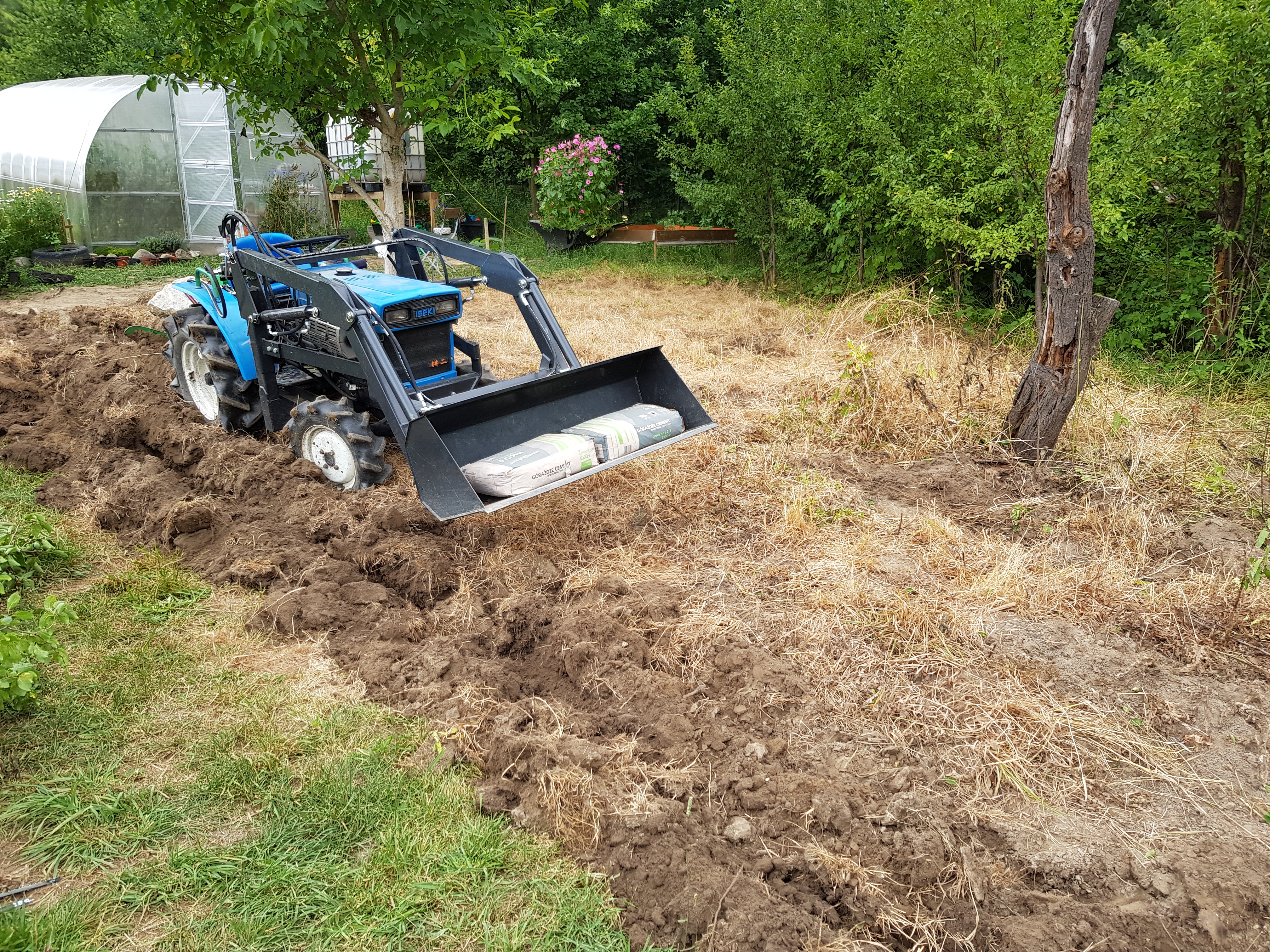

First, because my land has not been used/worked/cultivated in 20 years, i always start with putting the plow in the ground to take out old roots and stuff. I use a one-ski (?) plow, because of limited horsepower on the TX, and this way it makes nice deep holes. But it also changes relatively flat ground into 'rough seas'. Not sure if it shows on the photo:

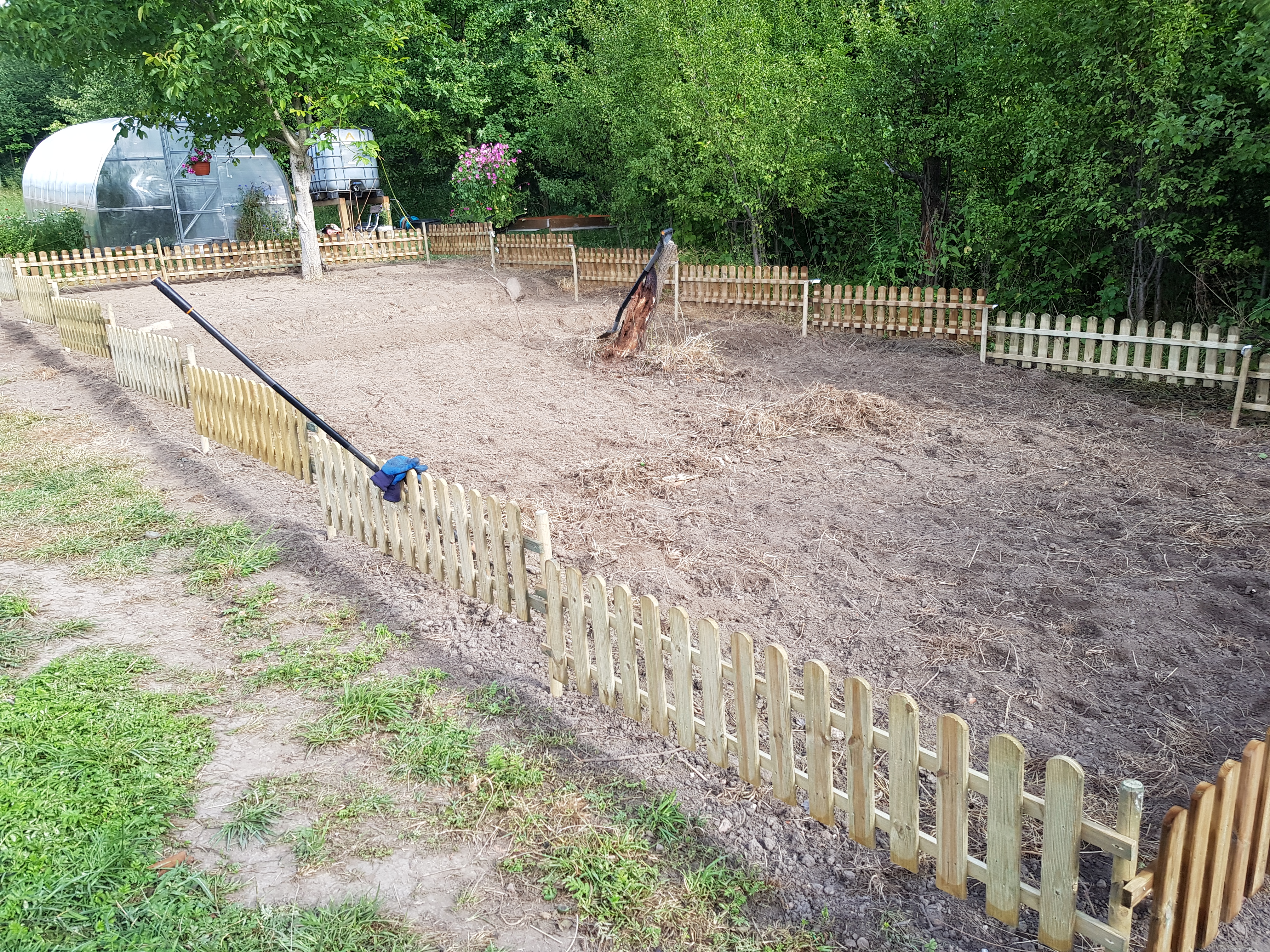

I always try to drive top-to-bottom for obvious reasons, but sometimes there is no other choice. And the slope on my hill can be steep at places. Here is the same piece of ground now that it is almost finished:

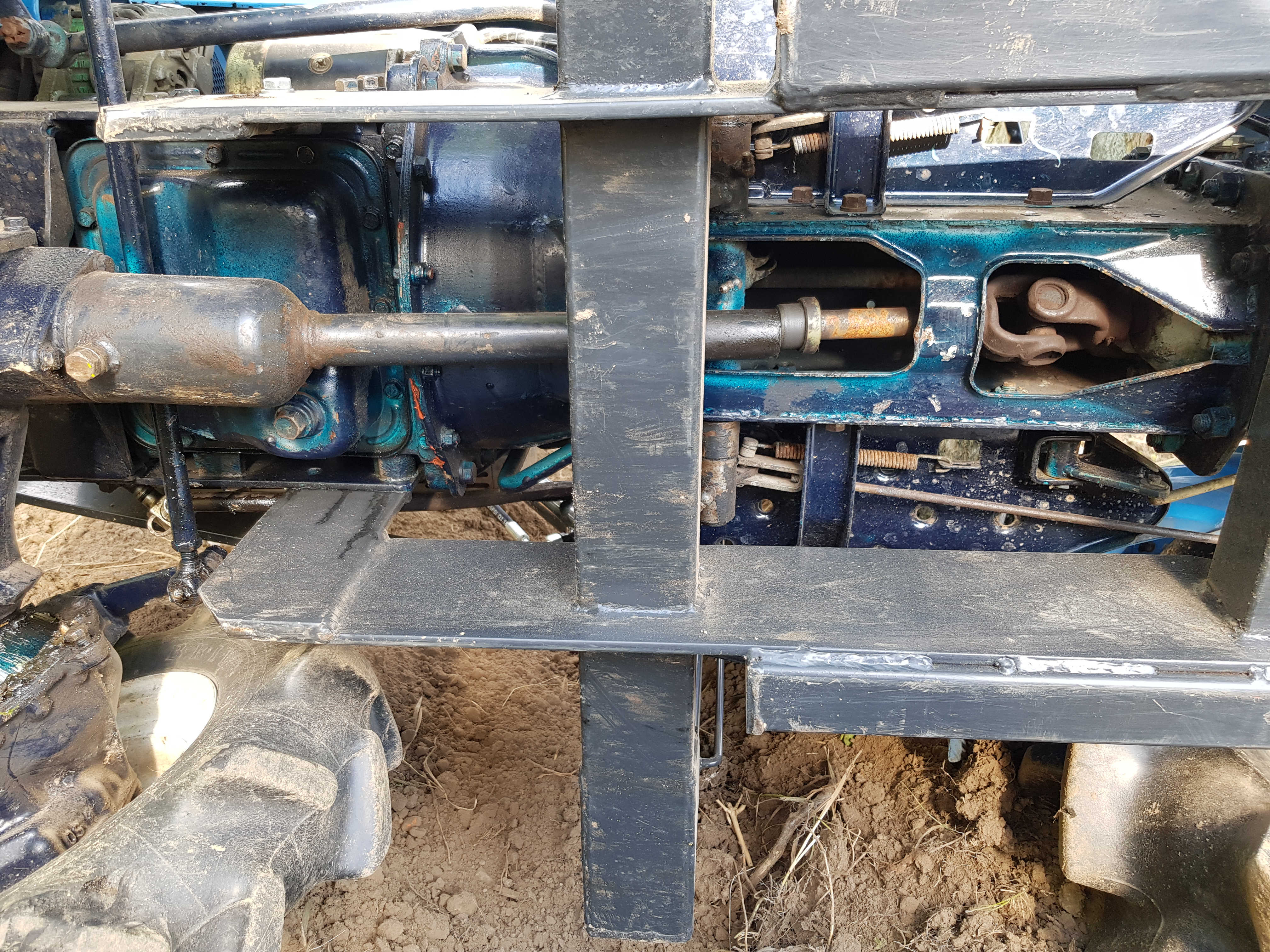

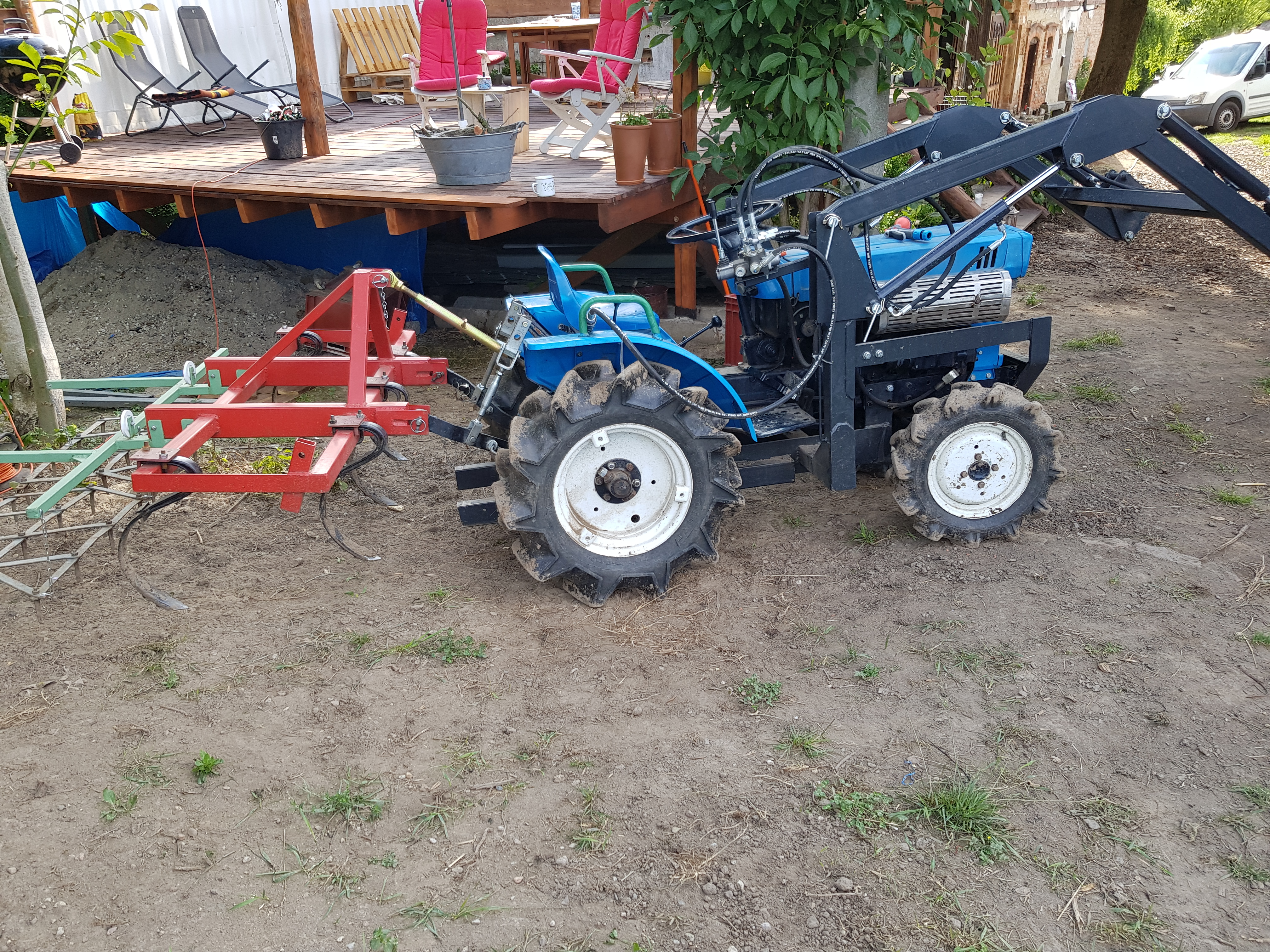

Also when i bought this FEL a few months ago, i had these people create a construction UNDER the tractor. First reason was to be able to connect my back hoe, but second reason was to get as much weight as possible on the lowest point. There is minimum 80 kilo of steel in this construct under the wheels/engine.
Here is what it looks like from below:
And from the side:

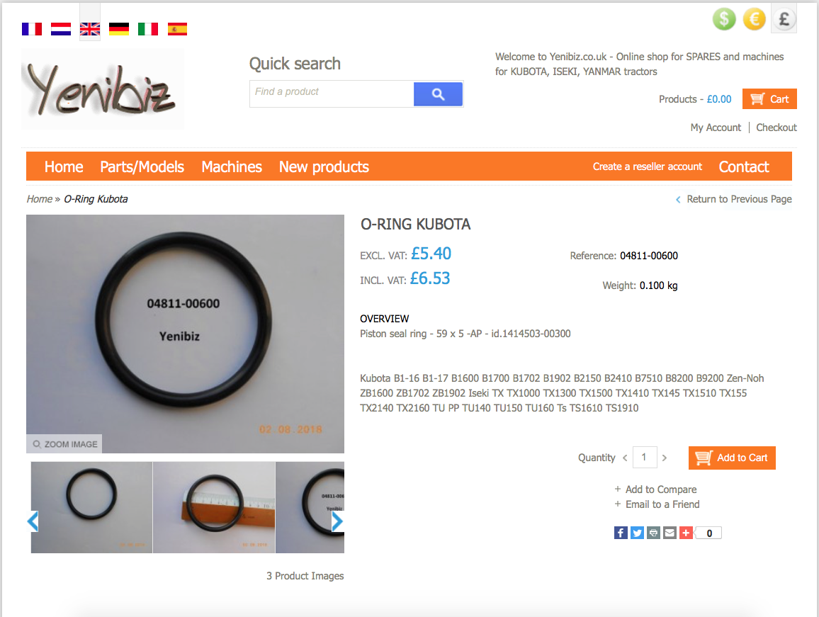

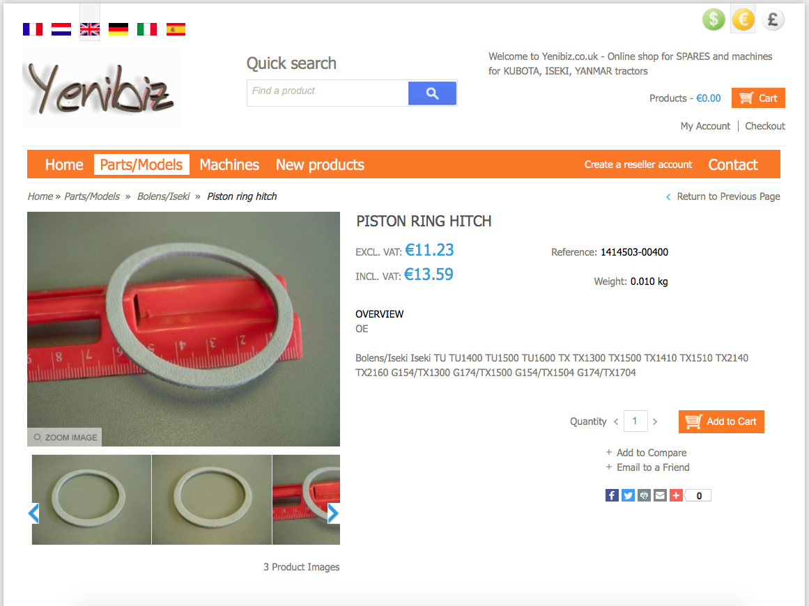

Well probably i will have to go the same way in looking for new o-rings and such. The o-rings for the piston are not the problem, it's the backup ring that is hard to find. Don/frx55 had a solution for this, i will try to find the post in which he explains.
Meanwhile you can have a look at traktor60.hu, this site (also english) has many parts. You can email them, they speak english. And ship throughout europe.

Hi M I found this on the internet i think its right for your tx well i think its right for all tx series for something they can put in an envelope they want £40 postage to the UK to dear for me think i;ll keep looking over here thought it might help you... regards terry
Screen Shot 2019-08-13 at 07.28.23.pngScreen Shot 2019-08-24 at 06.17.40.png

Hi Tom, thanks, it was just a stupid accident because of a combination of things. I always drive in low (slow) gear, almost full-time with 4wd engaged. It actually happened slowly, i had time to put gear on free position, and grab the tree that came towards me trying to stop the tractor from going over.
I am cleaning my ground (has not been used in 10, 20, or maybe even 30 years) taking tree roots out using the plough. At some moment in time plumb-trees have started to grow wild, creating this hard-to-kill network of roots in the ground. My plough actually makes pretty deep trails (?), and the ground then is very loose. Followed by rotary tiller, filling the holes/trails with very loose ground. So my left side wheels ended up on solid/hard/high ground, while both right wheels went deep into the loose stuff. Combined with the FEL being 1 meter up (trying not to destroy my wife's plants :) ) and the tiller being lifted up it just had to go. Lesson learned: make turns on ground not being worked on.
