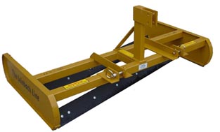

Just rolling around the idea of getting a utility grader attachment. The one I am looking at is made by Leinbach.
Utility grader
A question or three...I have a box blade, but was wondering if these graders can do a better job smoothing out a road than the box blade. Do any of you own one or used one and give an opinion? How well do they really work? With the angled blades, how well do they work to move soil/clay towards the middle of the road to build a crown or slope on the road bed? Or is a box blade as good?

Those are made for roads. Express intent and purpose was for roads and they do a great job. Better than a box blade, by far. But they are spendy. If you got the green and the need, it's a good deal. The ones in the link are fairly light duty, but should still be good.

My duragrader is a specialty attachment and does a far better job maintaining a road surface then a box blade. It depends on the type of surface and takes some practice. Grass or weeds will clog the blades. I don't use mine a lot but when it comes time to smooth the road it is without question the best thing out there for a CUT.

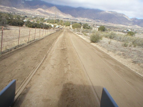

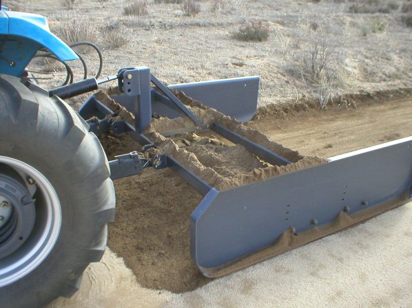

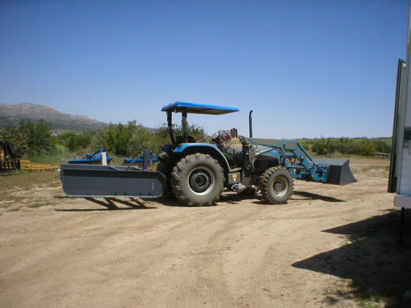

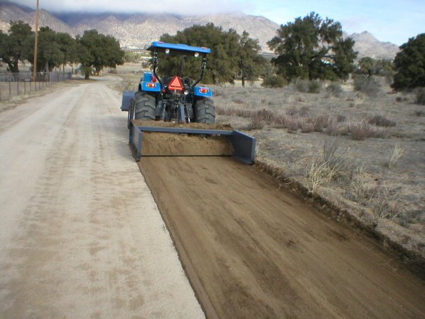

These grader blades work very well. Keep in mind that the heaver that one is, the better it will work for you. Just don't get one that is too big or too heavy for your tractor.
A lot of how well these blades work has to do with what type of ground that you have and the moisture content of the ground while you are working it. I typically will grade my roads when the ground is damp, like maybe a day or so after a good rain. My roads are decomposed granite (DG) and are fairly easy to maintain.
I too have not really had much luck relying on the angle of the blades to build up a crown on the road. Seems to maintain them fine, but does not build them up any higher. When I need to add dirt to raise the crown of the road, I will usually use my hydraulic side link to raise one side and deposit most of the material down the center of the road.
You can move a lot of dirt with one if all is right. I have pulled well over a cubic yard at a time with mine.
I own a landscape rake, a rear blade, Gannon box blade and a road grading type blade. Don't get me wrong, they all have their purpose and I have and do use each and everyone of them to maintain my roads, but if I could only have one of them for my road use, it would be my road grader blade.
Good luck with your decision.

Thanks Brian,
Your pictures show a thousand words. I noticed in one pic that the grader has quite a load of dirt inside the frame. That answers a question or two that I wondered about. I had originally thought that the grader would not move or hold that much dirt, but it looks like it will collect quite a lot between the framework. Thanks for the advise and pics.
/ Opinions about a utility grader attachment... #12
Dave, if my ground is very dry and I set the grader height to ground level and not let it dig in any lower, then that is when the dirt sort of just spoils over the blades and does not build up like it is in the picture. If you do get one of these blades, as I have said, be sure to get the right size for your tractor. If you get one that is too big or too heavy for your tractor, it will be a battle every time that you use it.
