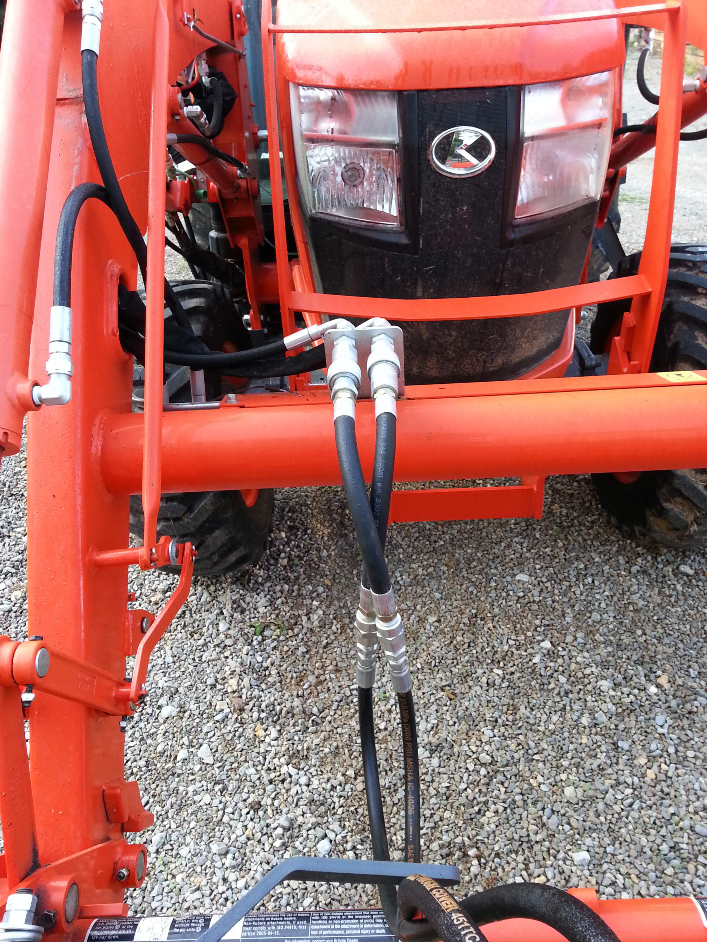

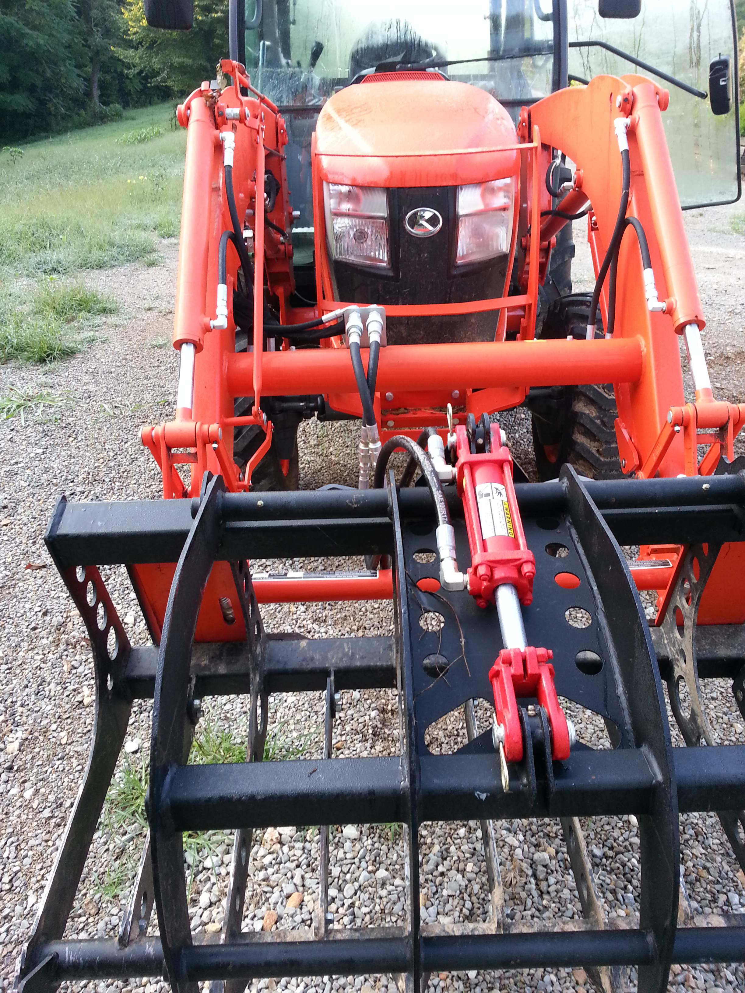

John,
When you get a chance, can you take a couple pics of where the 3rd function connectors/hoses are mounted to the FEL crossbar and where they go forward when you have an implement mounted?
I am probably going to order an ETA wicked root grapple and they will need me to tell them how long of hoses to ship with the grapple. So they want some measurements to help that.
I am hoping to figure out the measurements from your pic and measuring an LA1055 loader in person so that I can order the implements as soon as possible. My new tractor probably won't be done for a couple weeks, and since Travis of ETA says the implements I am interested in dont' get built until after the order I don't want to wait that long.
Thanks, Bill
I'll be glad to. I actually had to extend mine because I told Travis 42" would be plenty long. Of course I said that without measuring. :confused3:
   / Opinions on l60 vs l40, esp FEL hydraulics routing? #60
Bill,
Hope these help. My longest hose is 58" and the other is about 6" shorter.
