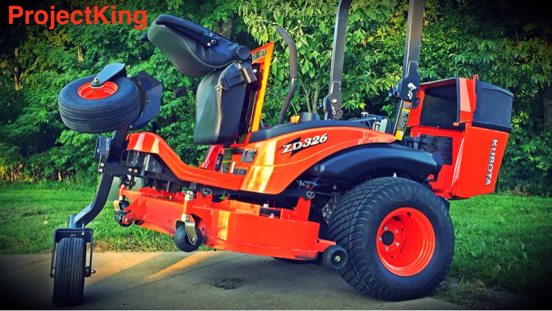

I really like my Kubota Diesel. But might be an overkill for the OP. Diesels are the way to go if you mow a lot. Very fuel efficient, tons of power, and super reliable. Here's a couple vids of mine.
https://youtu.be/DOYVLzbxeEg
https://youtu.be/DsZKBqIDUJw

I really like my Kubota Diesel. But might be an overkill for the OP. Diesels are the way to go if you mow a lot. Very fuel efficient, tons of power, and super reliable. Here's a couple vids of mine. https://youtu.be/DOYVLzbxeEg https://youtu.be/DsZKBqIDUJw <img src="http://www.tractorbynet.com/forums/files/buying-pricing-comparisons/444220-opinions-new-ztr-purchase-5-a-image-69665165-jpg"/>
I wouldn't mind having one of those either, but the used Grasshoppers are way cheaper. A diesel mower can blow away a gas motor in high grass even if the rated hp is less on the diesel.
