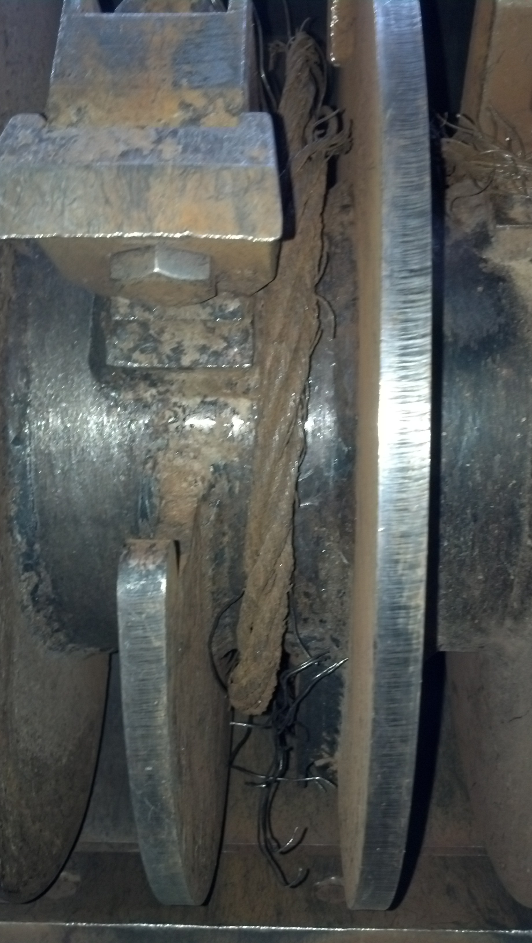

That's an interesting approach. A fella from Fecon called and mentioned you were a good source of knowledge. I've been wondering what different cutters would do for head vibration. Do you ever notice a change in operating vibes?
I hit some logging rope yesterday. Made a big fuss but didn't do too much damage to the cutters.
KW sorry been busy, no vibration at all, just make sure when you use different teeth you, what u do to one side do to the other keep the teeth even. I the center of the drum I run 7 chippers in the center, then from there, I stagger the chippers a carbides. I have ran 11 chippers in the center then King Kong chippers with carbide embedded chips, then on the 4 standard carbides on the out side.

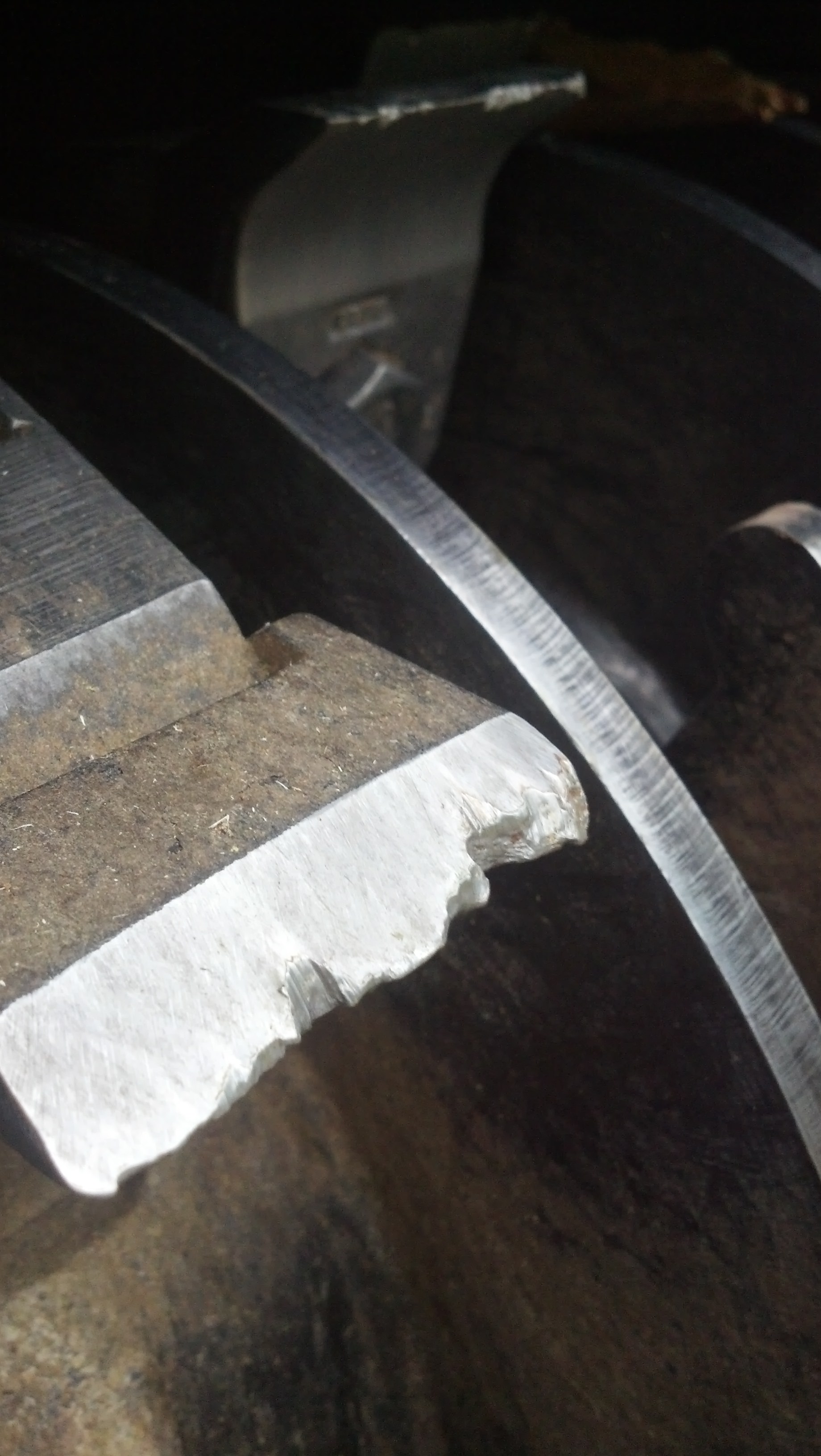

Not sure what we hit but it knocked out about 10 teeth. Perhaps Mike Tyson was hiding in a stack of logs. The majority might be sharpenable but the one below is out of service.
I called the folks at King Kong and the bear paw cutters were verified to be 75 each. I ordered some carbide stock to try some of my own ideas but for the mean time, we'll just run more Cimaf cutters.
In the interest of knowing what we had, I had a guy run it under a mass spectrometer and rockwell hardness tester. It came out to Rc 40 and was confirmed to be an alloy steel. Those spectral analyzers aren't ultra reliable for quantitative results so I didn't bother with writing down the numbers but it had a decent amount of chromium and trace of molybdenum and niobium, among other elements. It's naive of me to think that there's low hanging fruit following the Cimaf engineering team but that won't stop me. I'm going to cut out a slot to braze on some carbide and might try some other tool steels. They won't prevent the catastrophic failures as above but hopefully they'll reduce the frequency of sharpening. After a catastrophic failure, I'm hoping that I'll be able to replace the brazed on piece in the field w/o ever taking the cutter off of the machine.
I'm going to use the cutter pictured as my test mule and will try to fill the gaps with stainless filler. Although mass spectrometers don't detect small elements like carbon very well, they'll usually make a guess and I've been cautioned that it might have enough to make it a bear to weld. I'm expecting the stainless filler to dilute the carbon and reduce the tendency to crack. I'll post my results.
