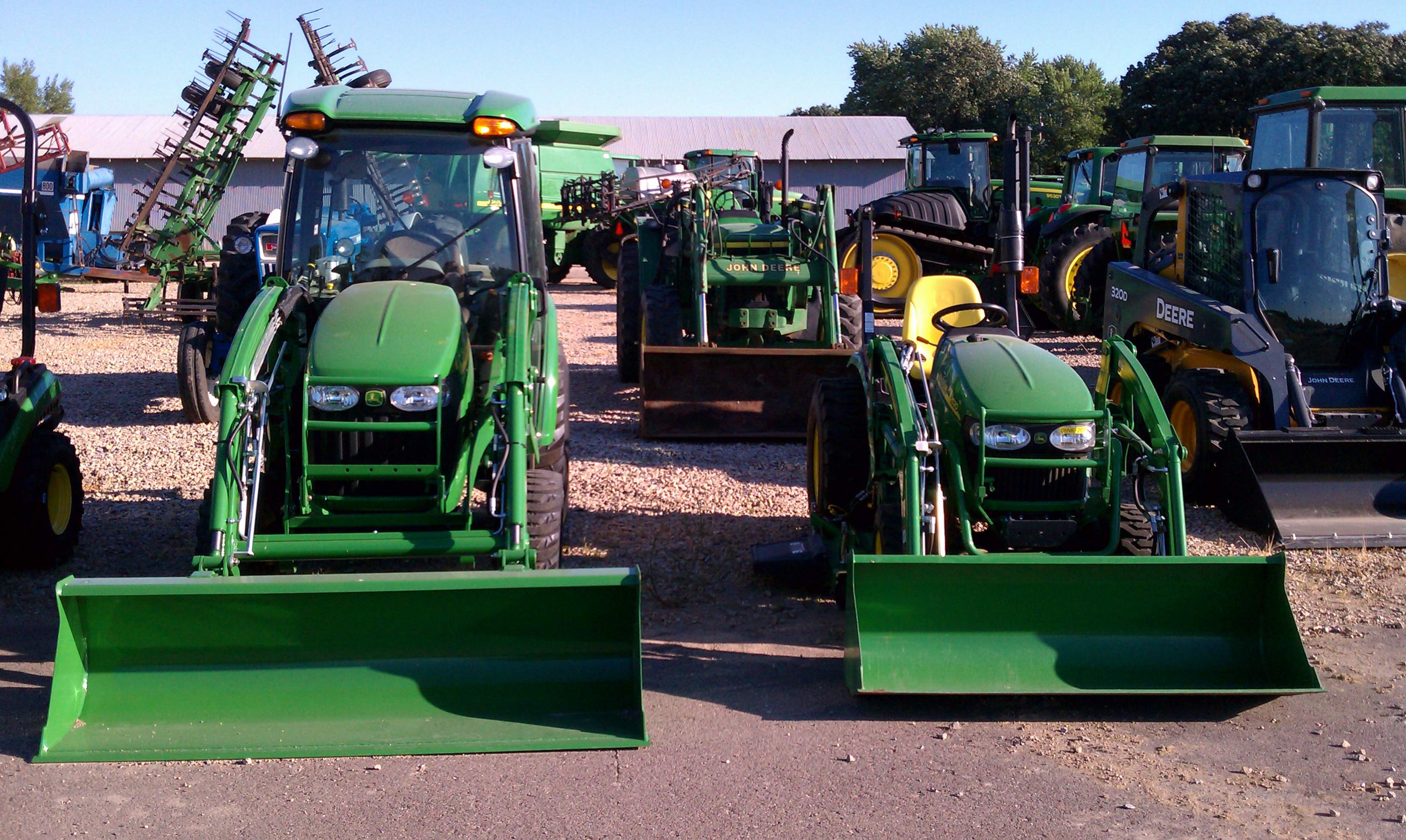

I ordered a 3320 cab not a 3520. I got to demo one and it was perfect for me. had more than enough power and the price came in where i was more comfortable.
2012 John Deere 3320 Cab
300CX loader 73" bucket
72" 7Iron MMM
Will add rear remotes later when i have the need for them. No more freezing my butt off in the winter t-shirt and hot coco snow removal coming my way :)

Good decision on the smaller bucket. Not sure why the larger one comes standard? Congrats on a nice new tractor though!

The reason that the larger buckets come "standard" is because most folks want their loaders for moving material. And, more material at a time is better (most times). Another very common use for a loader is moving snow or other similar material that the tractor might not easily drive through. In those cases, you want a wider bucket to move enough material so that the rears will have a clear path.
For those folks that are looking to dig below grade or move very dense materials, a smaller bucket makes sense.

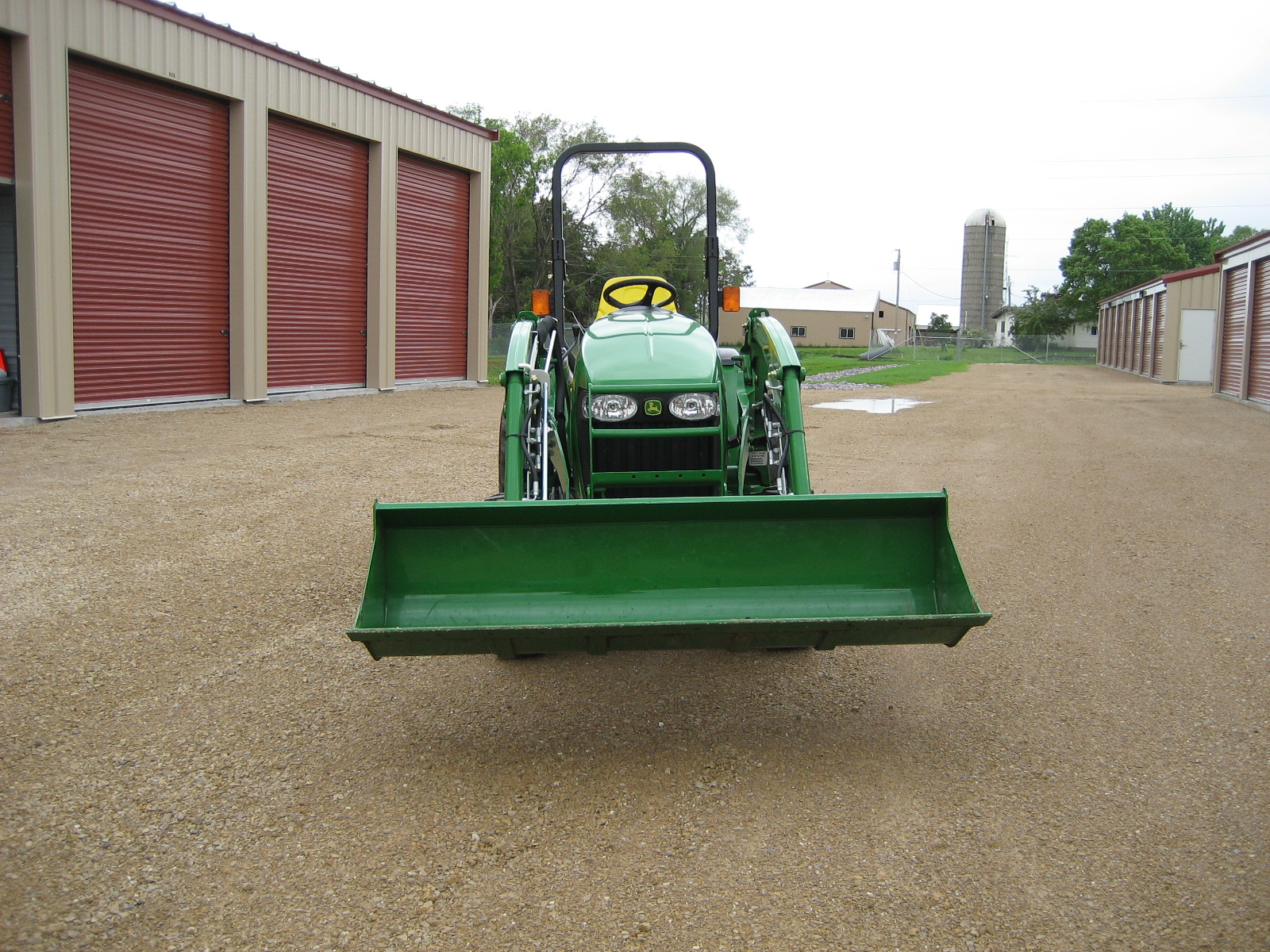

Whoops, looks like I misread:eek: I had a 3120 before my 110, and it had the 60" bucket. His 3320 with cab will be more equivalent to my OS 3120. No way would I be getting full loads of gravel with that size bucket. My 110's bucket is a 72"! There are plenty of times when it's working hard with that size bucket and it's a much larger more powerful machine. Unless all your doing is light material (snow/sand MAX) I'd get the smaller bucket. Don't take this the wrong way, just trying to help. But take a look at the buckets and size difference between the two. Picture doesn't really do it justice, but I'd be weary of the larger bucket.
I agree on giving the bucket sizes a lot of thought and understanding what works well where...
So, there's a couple of things that I think are worth mentioning...
1) I think most first-time buyers (myself included) go with the premise that they want the largest bucket available, especially when they see that the price difference from one to the next is comparatively small.
2) Having the larger bucket tends to not be an issue because they aren't regularly using it to move *heavy* material (like gravel).
3) After using the loader for a while, you realize that you can't "fill" the bucket, so having a larger bucket that you partially fill will move more material in one pass. Plus, by not trying to fill the bucket, you end up with a manageable amount of material that you can move without spilling.
4) If you find yourself doing a LOT of loader work, get a second bucket and go smaller in size. Having the choice will end up being very helpful.
5) Having the larger bucket (read: wider) means we can drop the loader and drive... And clear a path that the tractor will fit through. And, for a lot of us, that's a need.

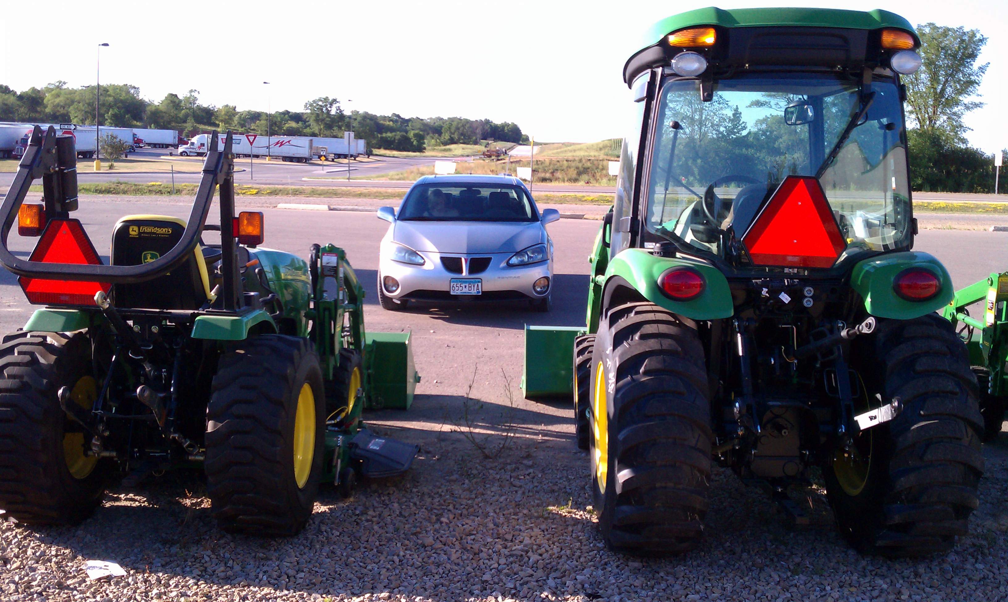

I have the 3520 with the larger bucket. I wish I had the smaller one. For me it tends to just stick out to far on each side and becomes a PITA when manuvering in tite spaces. Also start thinking about ballast. I loaded the tires and put 1k pounds behind it when moving large bucketfulls of material. Wish they made a size inbetween the two bucket options.

I'm guessing down the road i might pick up another 61" bucket for the smaller tasks. i agree on ballast. Cab does add a lot of weight but i'm also getting the tires filled.
I have a box blade that i've loaded down pretty good that also helps for ballast.
