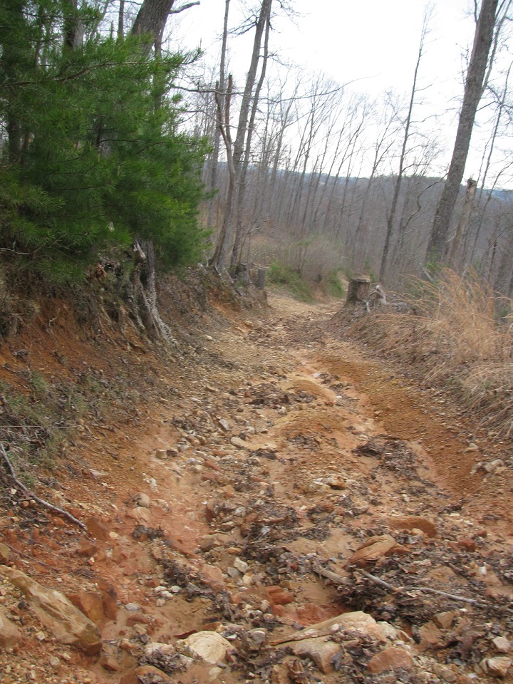

My first posts here were requests for input on selecting a tractor that could help me rebuild and maintain well over a mile of dirt road between us and the pavement, as well as handling later farm chores. The overwhelming feedback was to hire the initial roadwork, and get a suitable farm tractor later. I followed that guidance and had the road reworked last fall. In addition to road building we had him remove all stumps and overgrowth from the 7ish acres where we planned to build. He then leveled a spot for the 28x48 gambrel roofed 2-story barn we had planned.

The road before rework last fall:

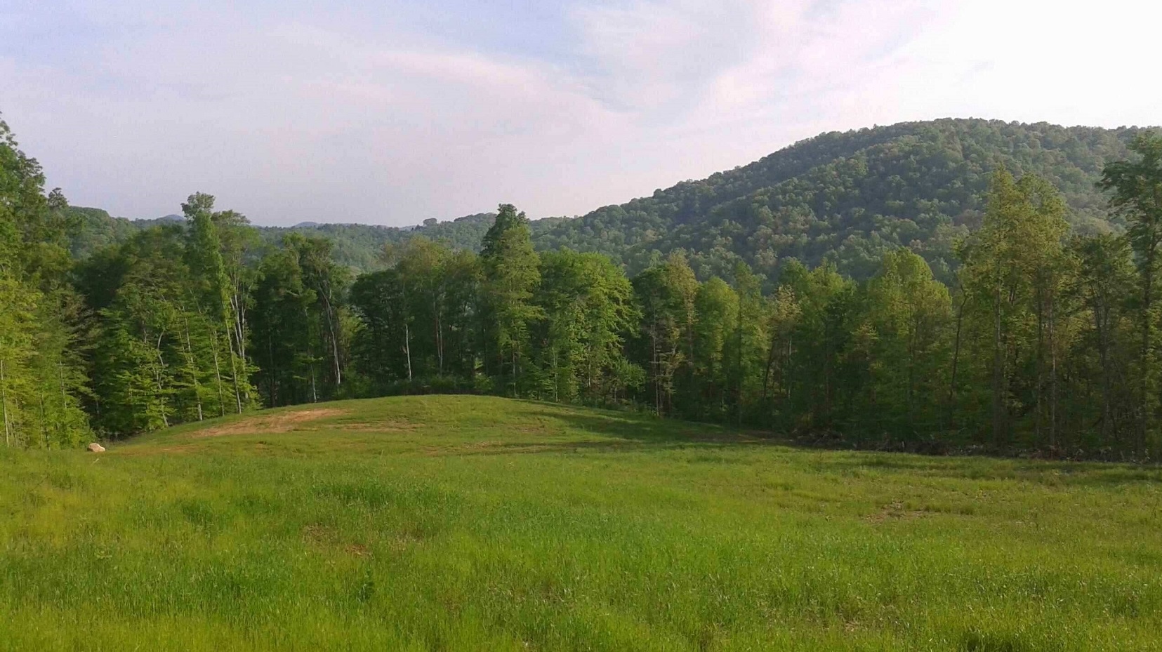

The build area looking from south to north. Barn is going up on the rise to the far north:

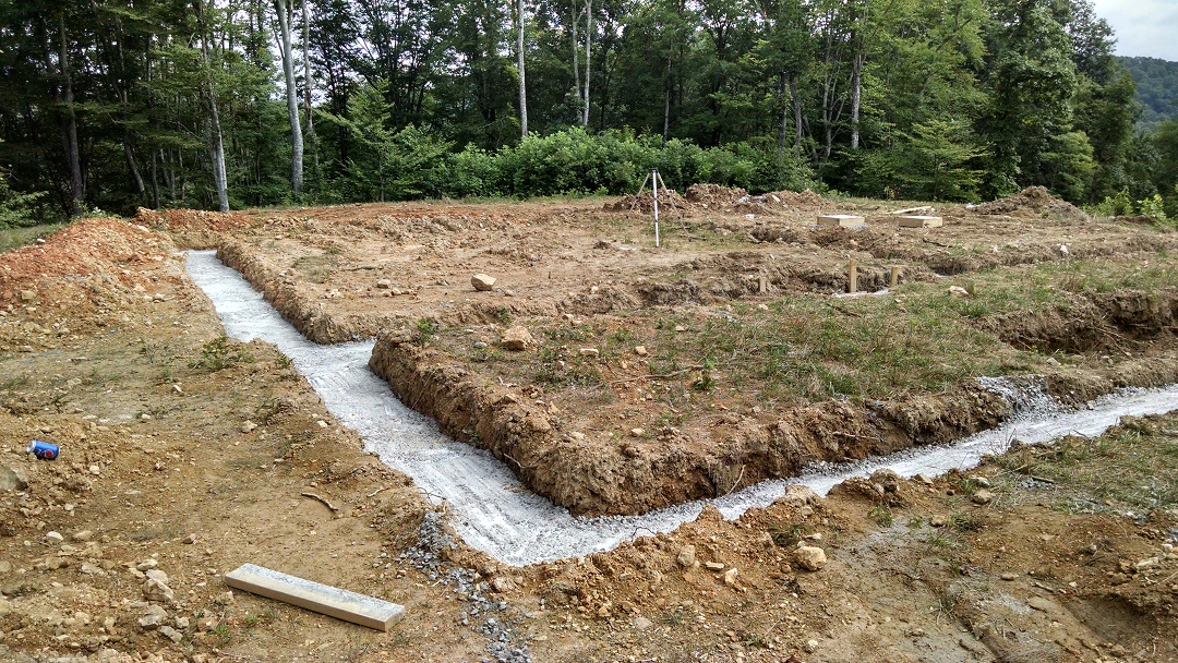

Dug the footings, set the rebar and poured concrete. Had 32 tons of stone spread on some bad spots in the road, got the mason rescheduled and headed for home.

Concrete in the ground !!

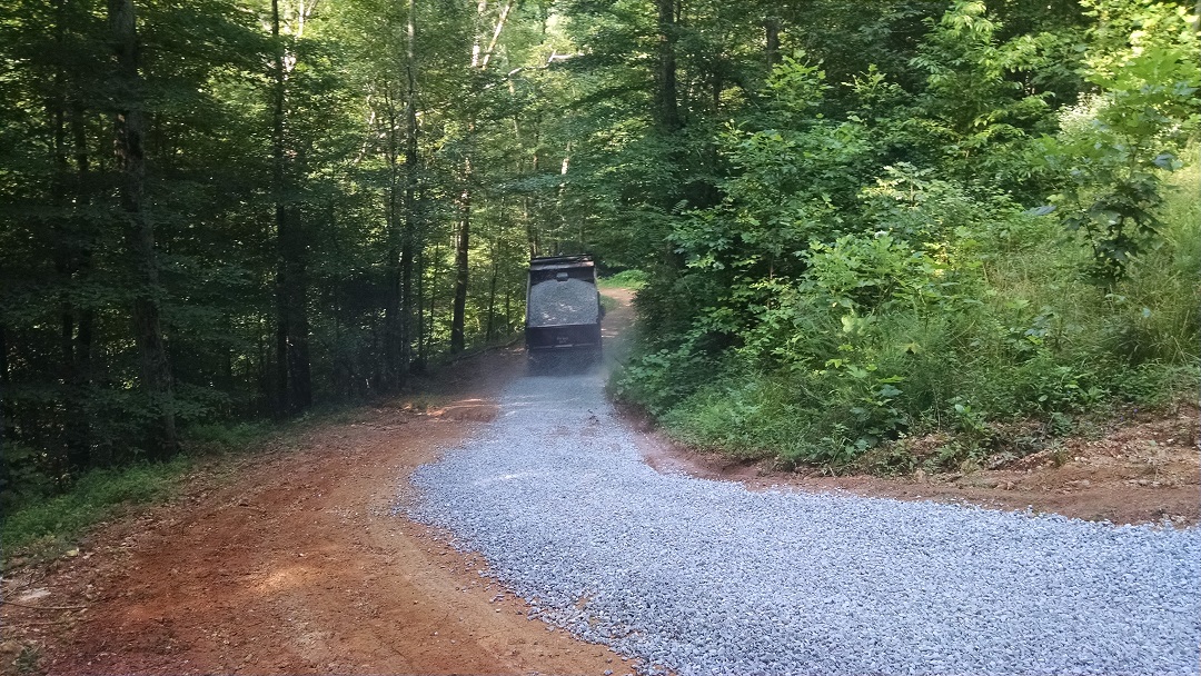

Traction improvement time

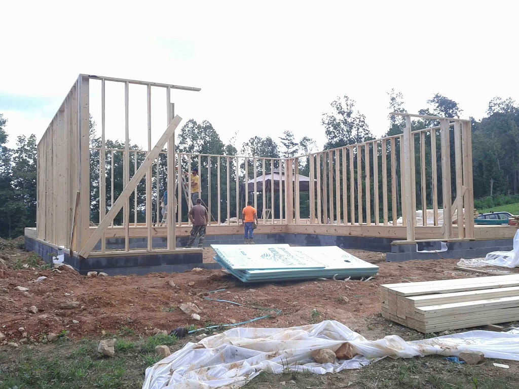

10' 2x6 studs here in garage.

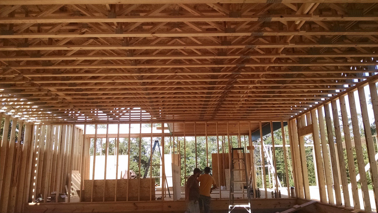

2 - 22' x 18" lvl (now 3) at far right to support roof and floor. 4 - 22' x 11-7/8" lvl at far end to hold up other end of floor joists

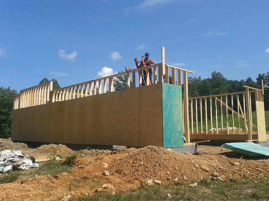

3 different wall heights - far left gets joists for ledge against gable end. Middle is against loft hole, so full height. Right will get 2' tall trusses. All end up at same 2nd floor height.

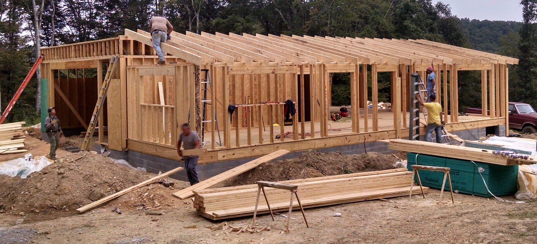

   / Our Tennessee Barn (now house) Build

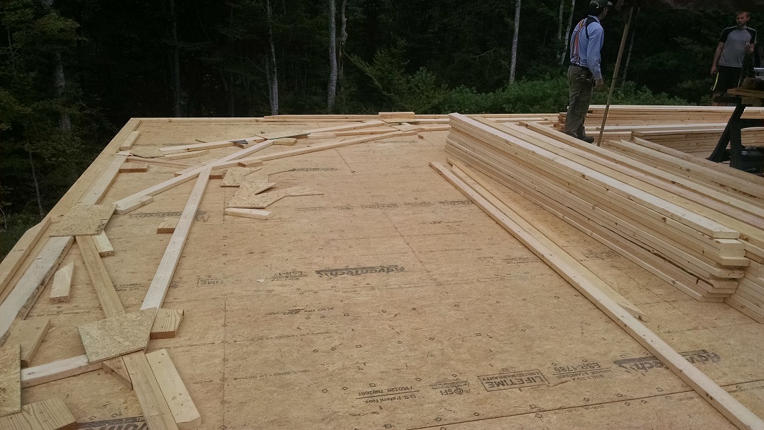

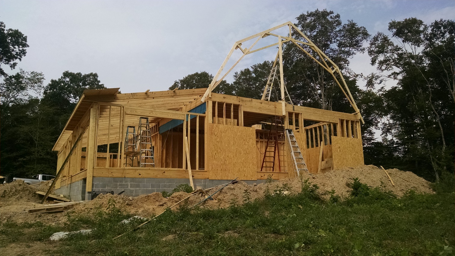

Arrived again in Tennessee expecting to start building and raising roof trusses, using Gambrel roof truss plans from Barnplans.com. Got there and found only 3 sheets of 2nd floor Advantech installed. Crew discovered that the open web trusses were so inconsistent that they could not put down the subfloor. It took 2 people 2 days to plane down and shim the trusses to get 'em flat. Put down the Advantech and got to work building the jig for the trusses.

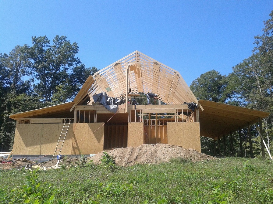

Finally got the jig perfect and laid out the first truss. Nice. Part of crew got busy cutting truss members and gussets, while others started building trusses. 20 gussets on each truss (only 10 on end trusses). Construction adhesive plus nails on 2" centers to hold gussets on trusses. 27 trusses. 23,000 galvanized 2" ring shank nails to hold gussets. Love the trusses.
Put a 4' wide walkway along east gable end at loft hole to stiffen the wall. It was easy and works great.

Stood up the first one

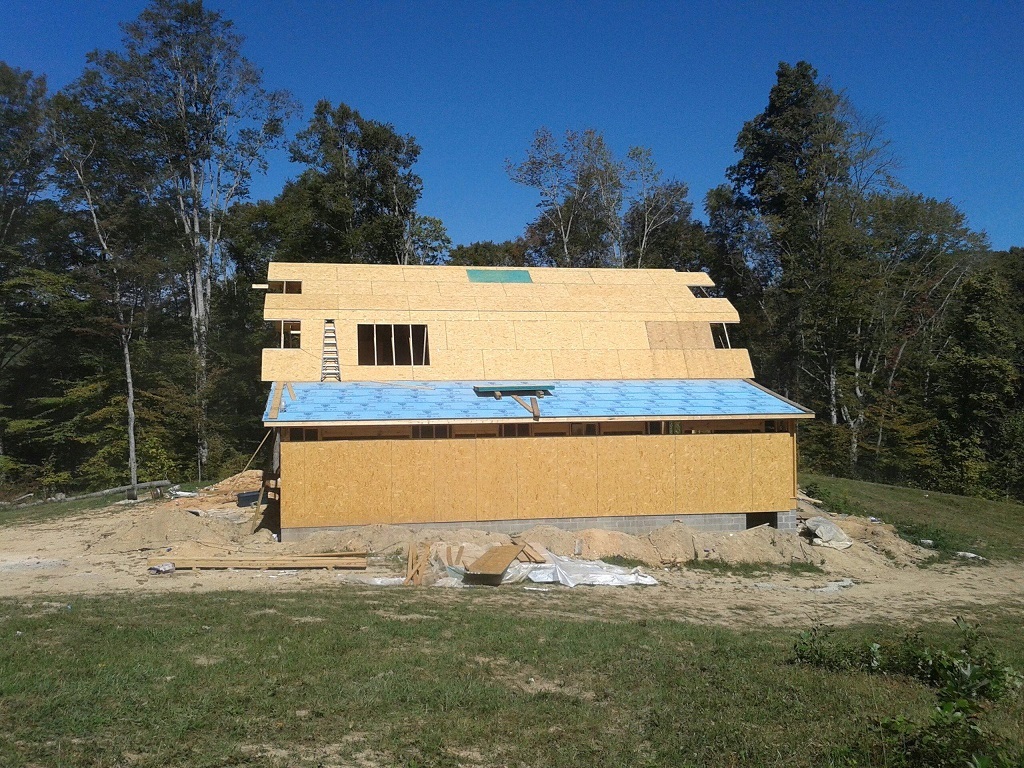

We got the roof sheathed in October, then had to start cutting the holes for dormers. Cutting the first one was tough.

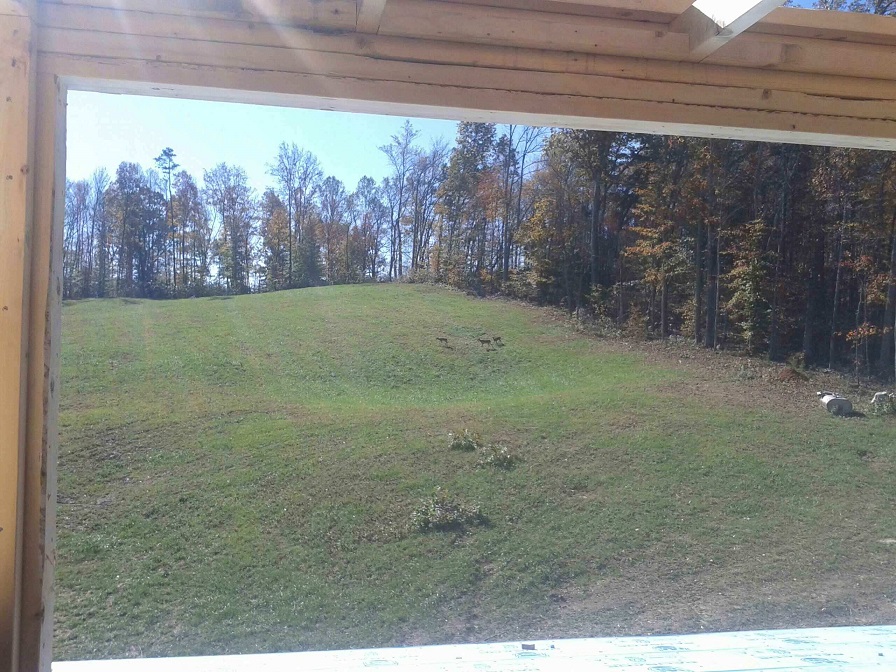

Nice view out that dormer window

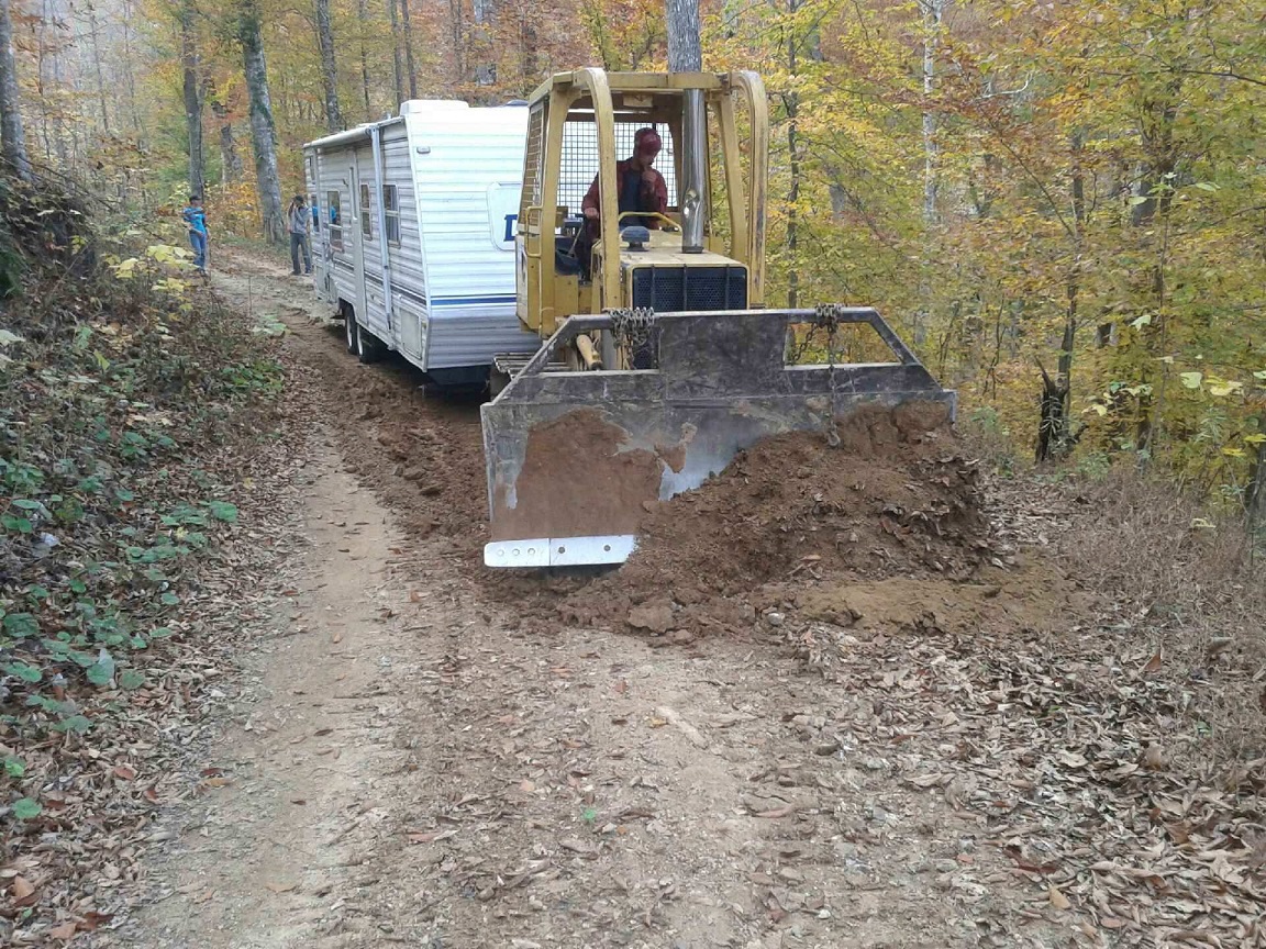

Wanted trailer brought up the hill for Thanksgiving, and needed grading done around building. Trevor got it all done in a day. He needed the road a little wider to make a turn.
