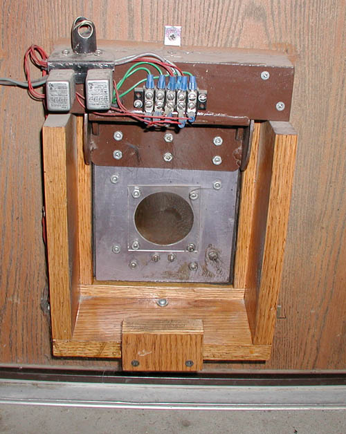

There are four cats here, three stay inside and one goes in and out what ever he wants. They were all strays and are neutered. I would like to keep them all in but one will spray if he can't get out. Attached is an image of a door I made him that only he can use to go in and out. He wears a collar with a magnet on it. The door has inside the upright wood piece a reed switch that senses the magnet. The reed controls a relay that energizes a solenoid hooked to a pin that unlatches the door so it can be pushed open. It swings from the top so it is self closing and then latches. It took him about a week to figure it out and me some time to make it. The other cats must wonder how he does it.

<font color=blue>...The door has inside the upright wood piece a reed switch that senses the magnet.</font color=blue>
So if I understand you correctly, you just published on the Internet everything the world needs to know in order to totally breach your security system. /w3tcompact/icons/wink.gif All a skunk or possum has to do is strap a magnet to its neck, and in it comes? No retinal scans? Nothing?? You are hereby demoted from Chief of Security. /w3tcompact/icons/laugh.gif
Actually, it looks like a great idea!! /w3tcompact/icons/wink.gif
