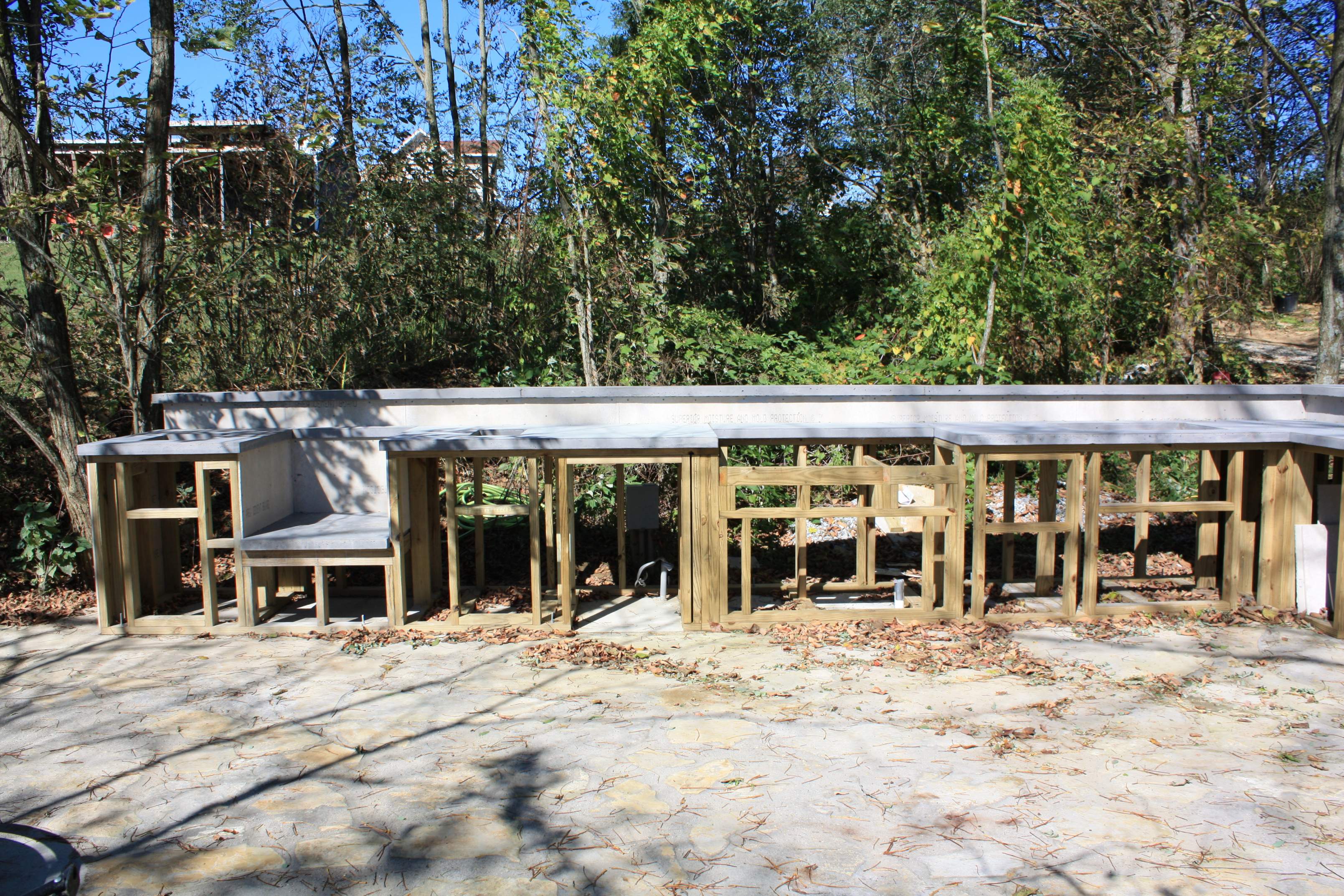

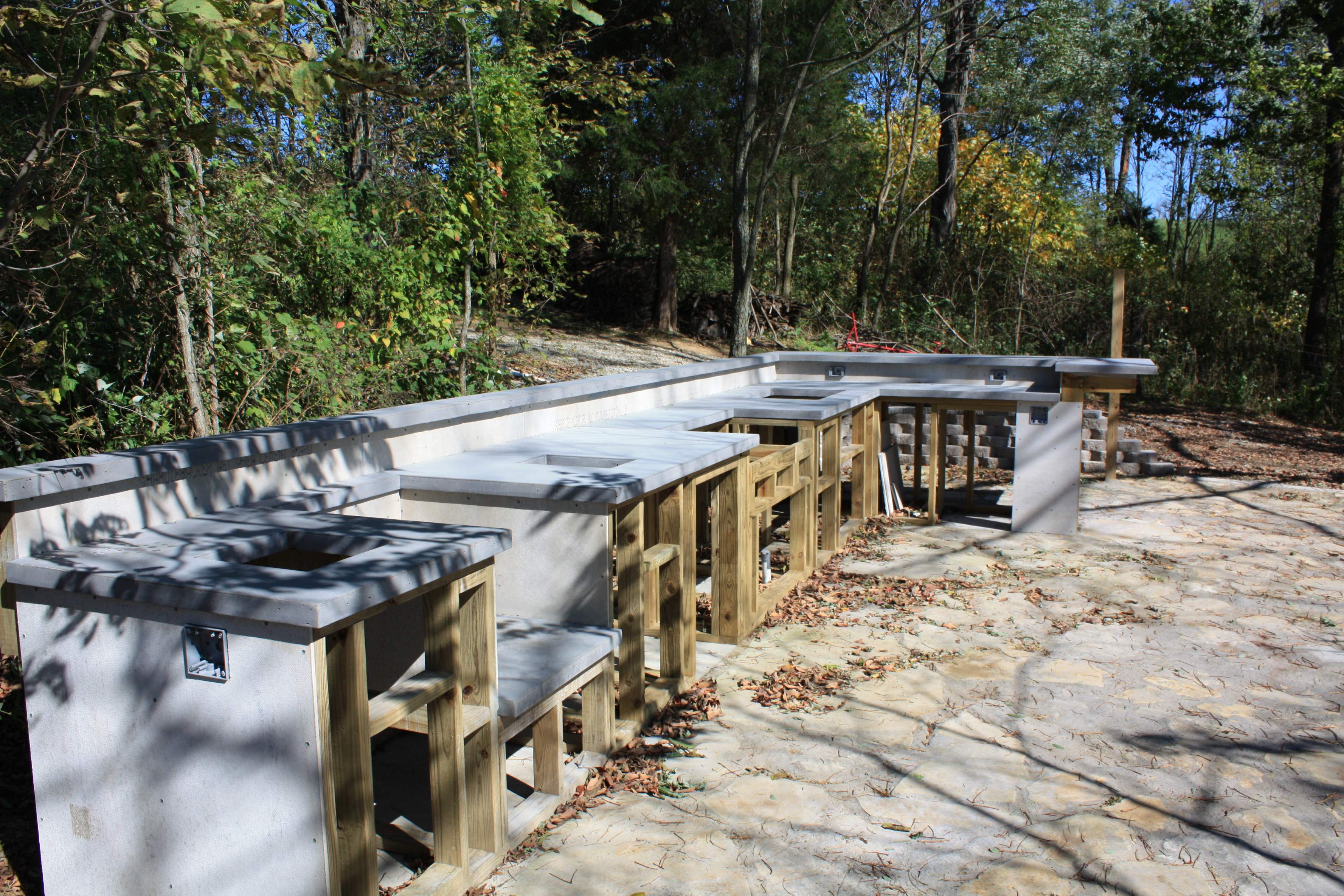

I was worried the backsplash tops would move around, but i tried to move them today, they are there, couldn't budge them.

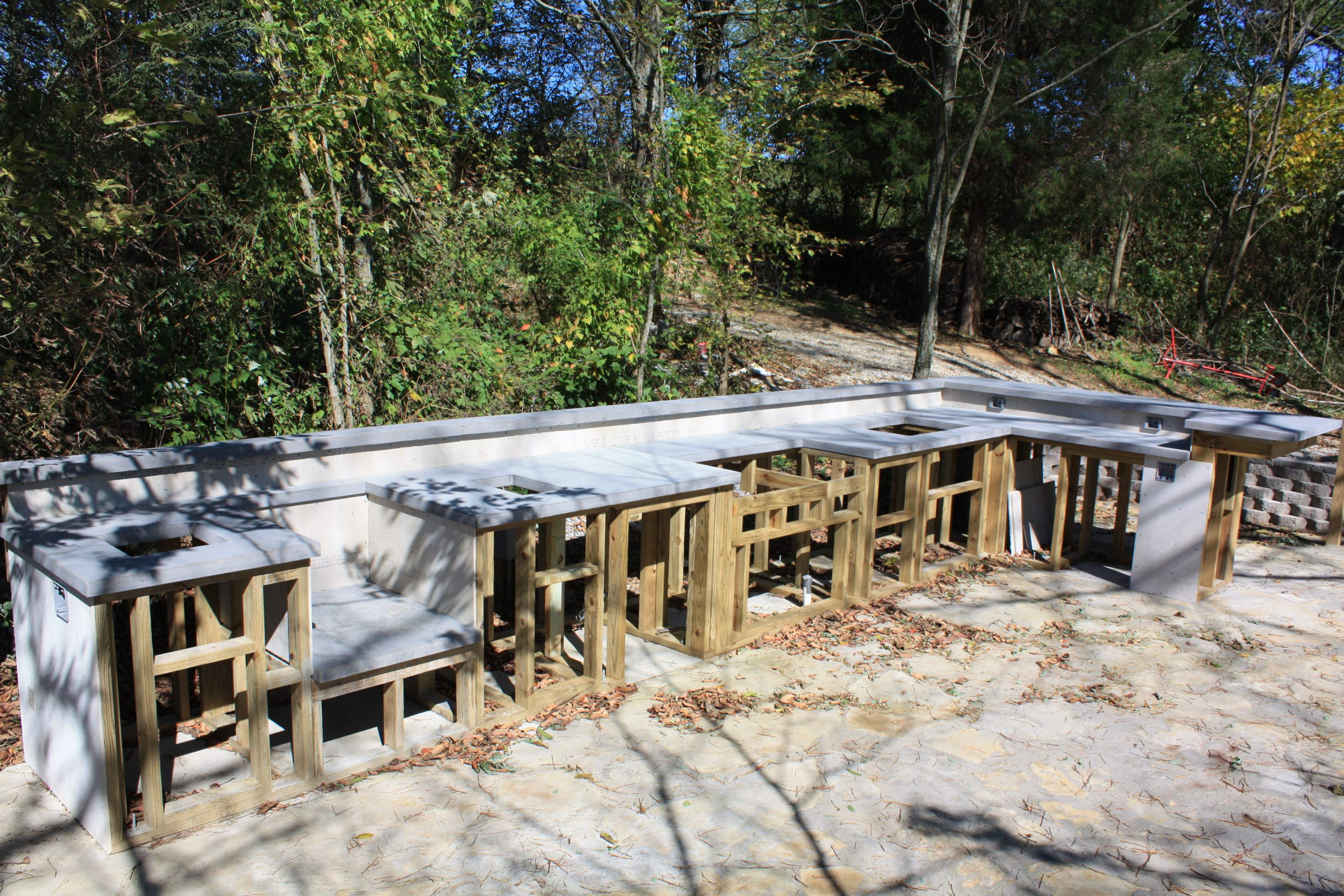

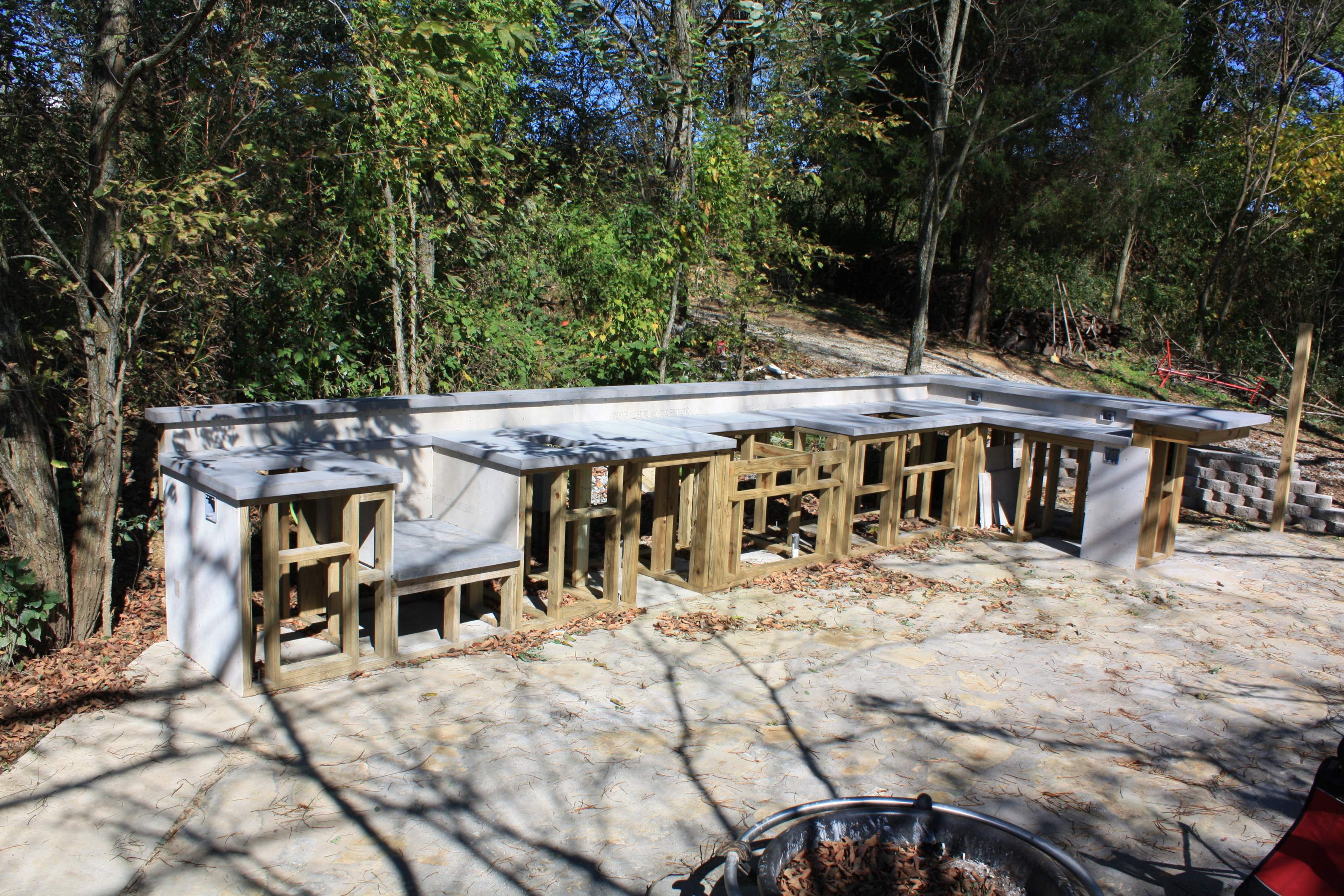

Last two pics. I may go ahead and pour the table top while i have the plywood bases level and ready. I think i'll use foam for the mold on it.
