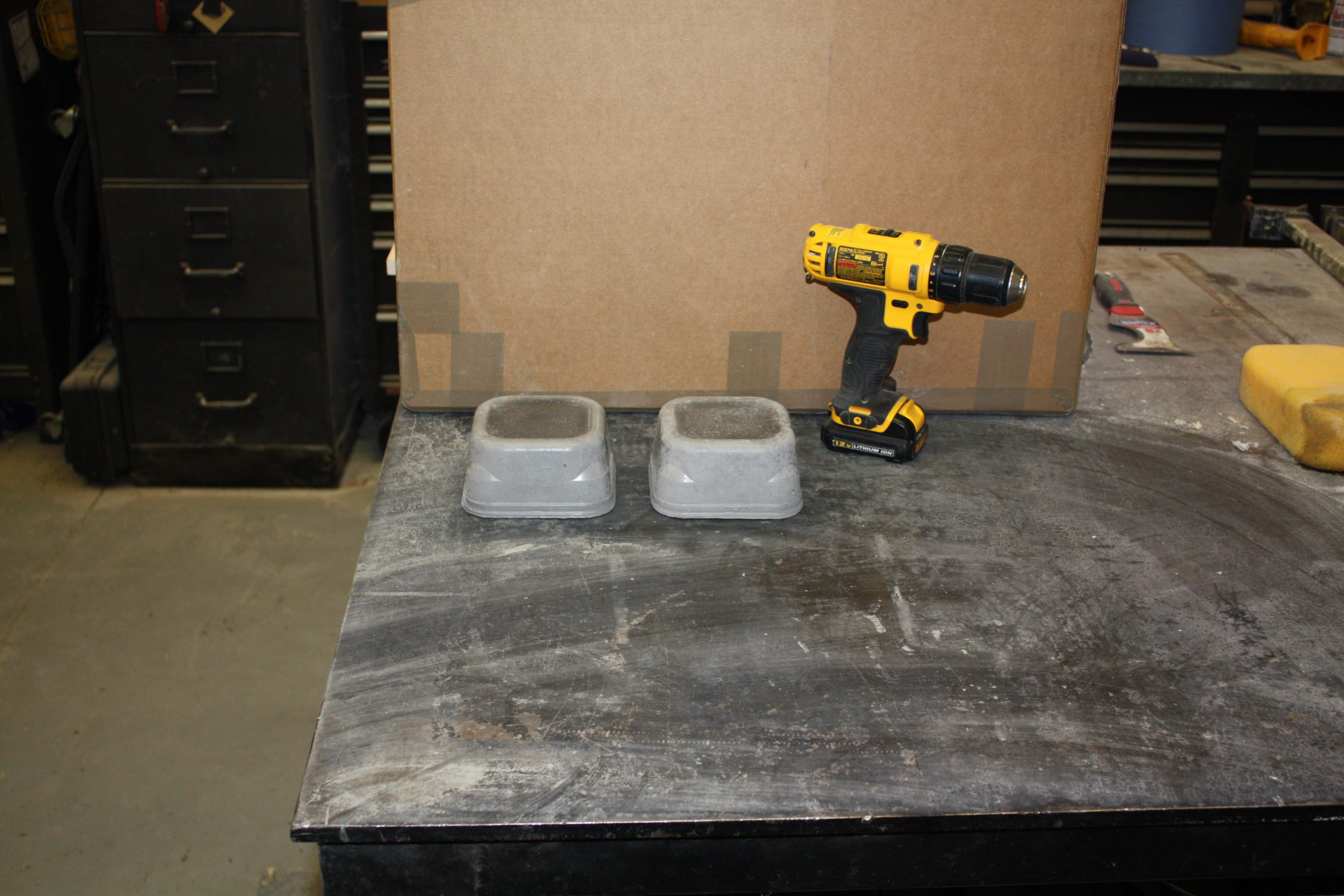

How lucky is this? Out of three different pours, 27 eighty pound bags, this is all the waist i had (the first two pours came out perfect). Thats pure luck.
