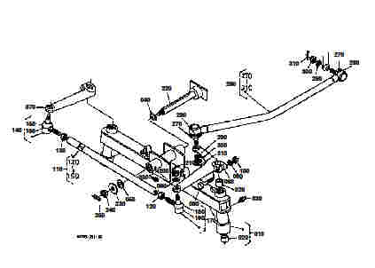

Pardon my ignorance, but what is a draglink?
   / P/S B7100/7200 #130
This is a drag link. It is the long rod that connects the steering box to the front wheels.
