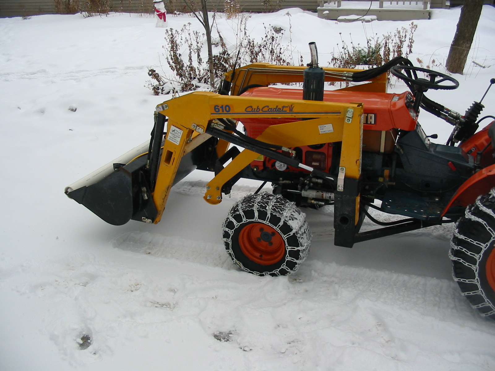

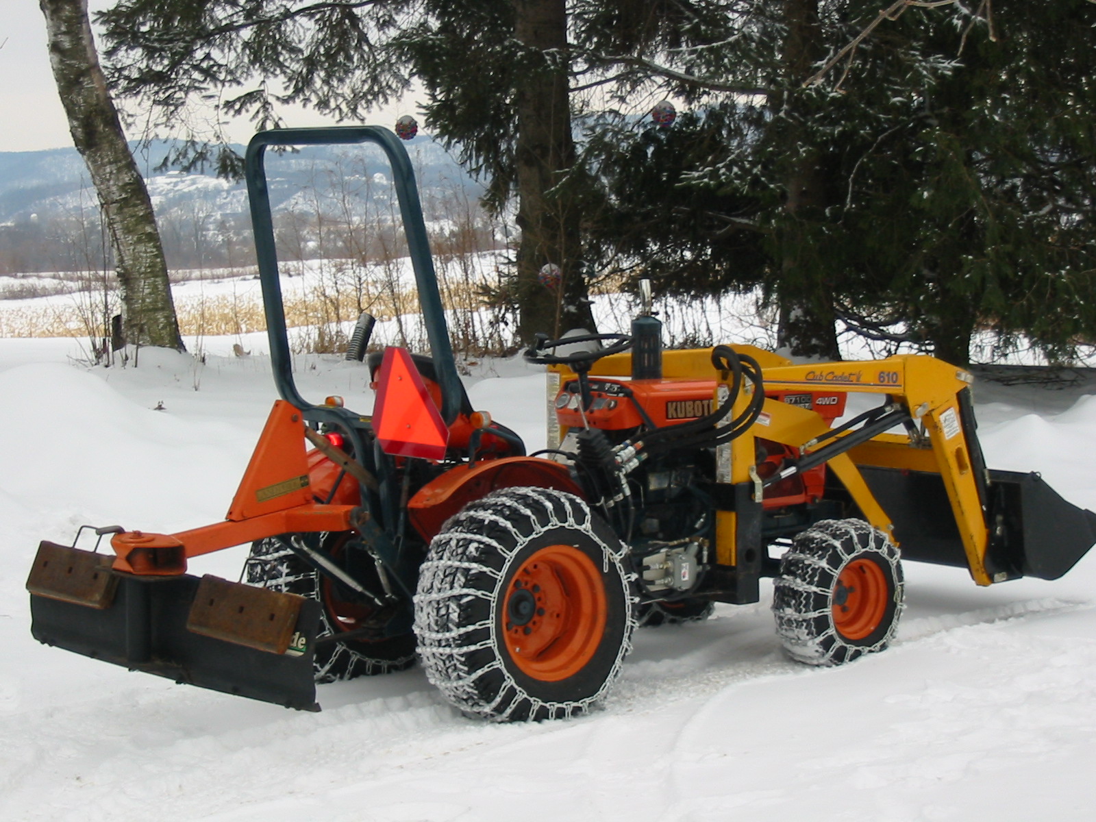

Here's clarkvg's picture's. Interesting how he has a Cub Cadet loader on his Kubota. How well does the PVC pipe trick work?

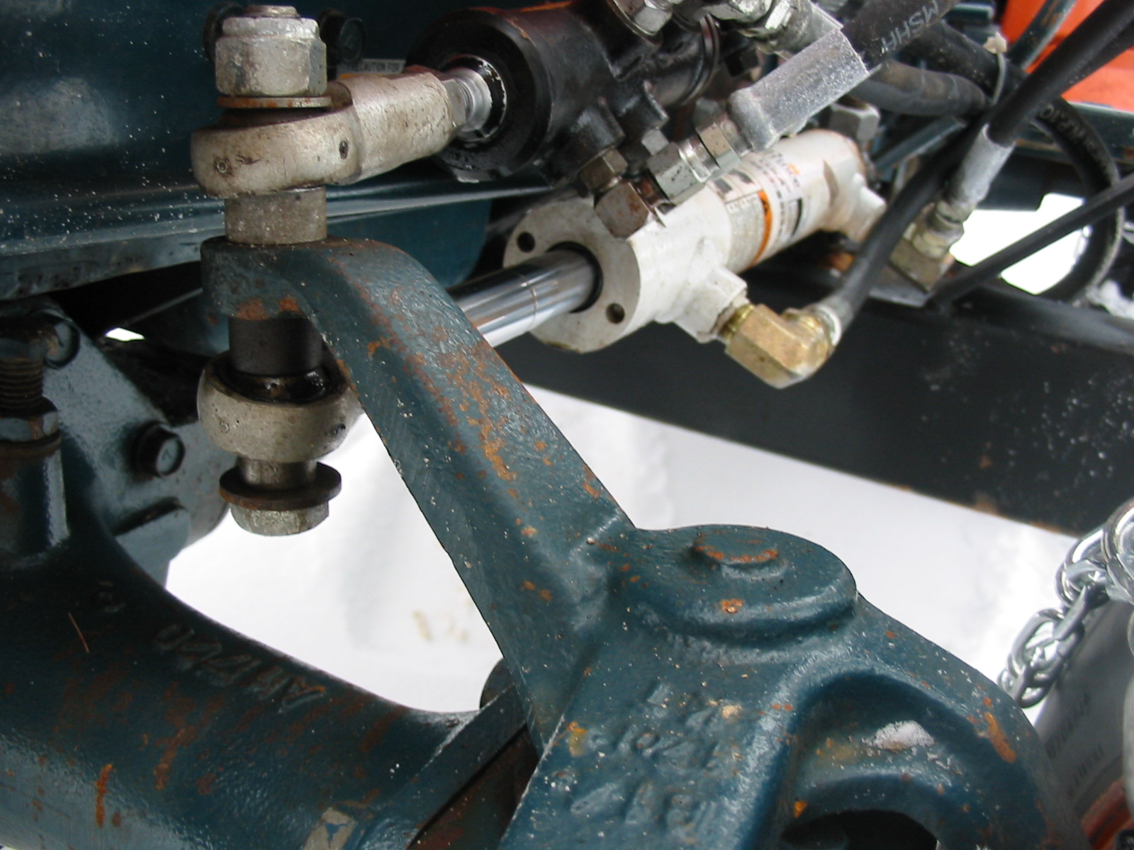

Thanks Mike for posting my pics, I was surprise to see all the salt on the paint in the pics. I never noticed it before.
I'm mixed about the PVC on the bucket. It does protect the blacktop and does slides over rough spot well, but it seems to leave more snow on the driveway than without it, also if the angle of the bucket isn't just right it tends to ride over the snow entirely(operator error). I think the scraper does a much better job than the bucket with or without the PVC. I use the bucket where I can't use the scraper.
It was 21 below here this AM so not much Kubota time planned for today.

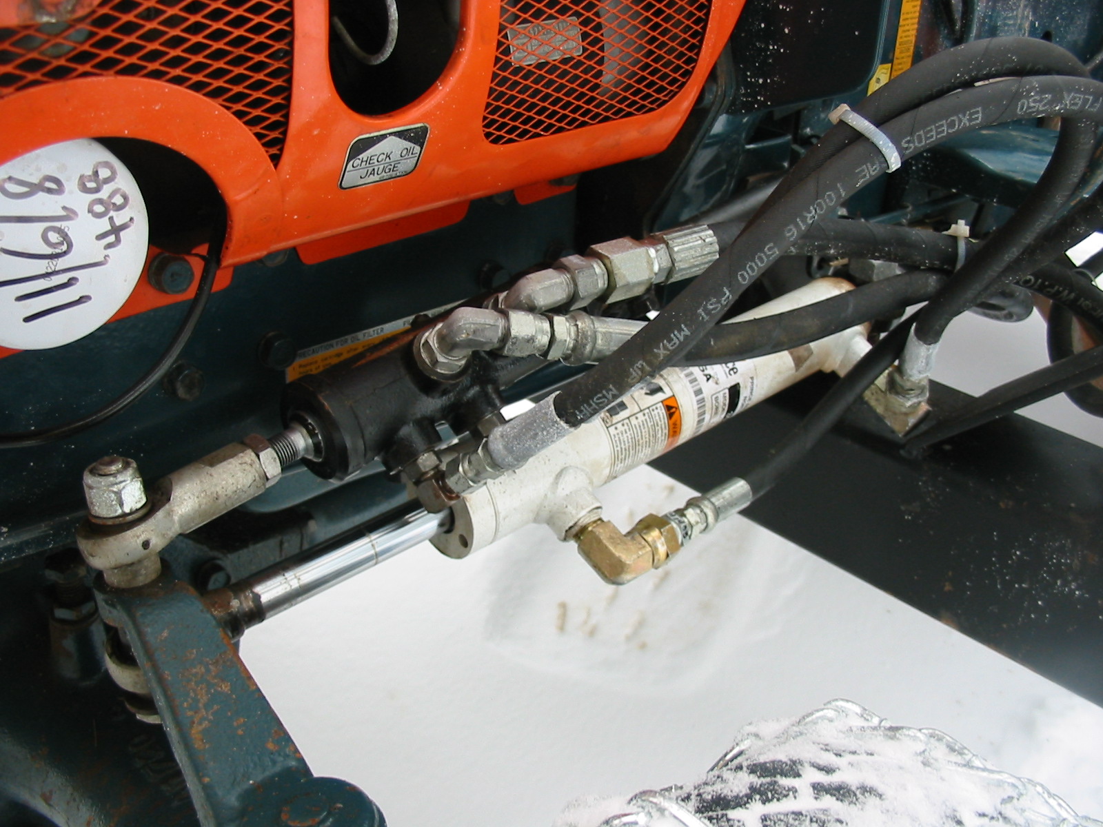

Finial note; after having power steering for about a month now I still think it a great improvement on my B7100 and would encourage everyone to consider it, but it does slow the bucket movements. It doesn't seem to affect the 3 point scraper with weights.

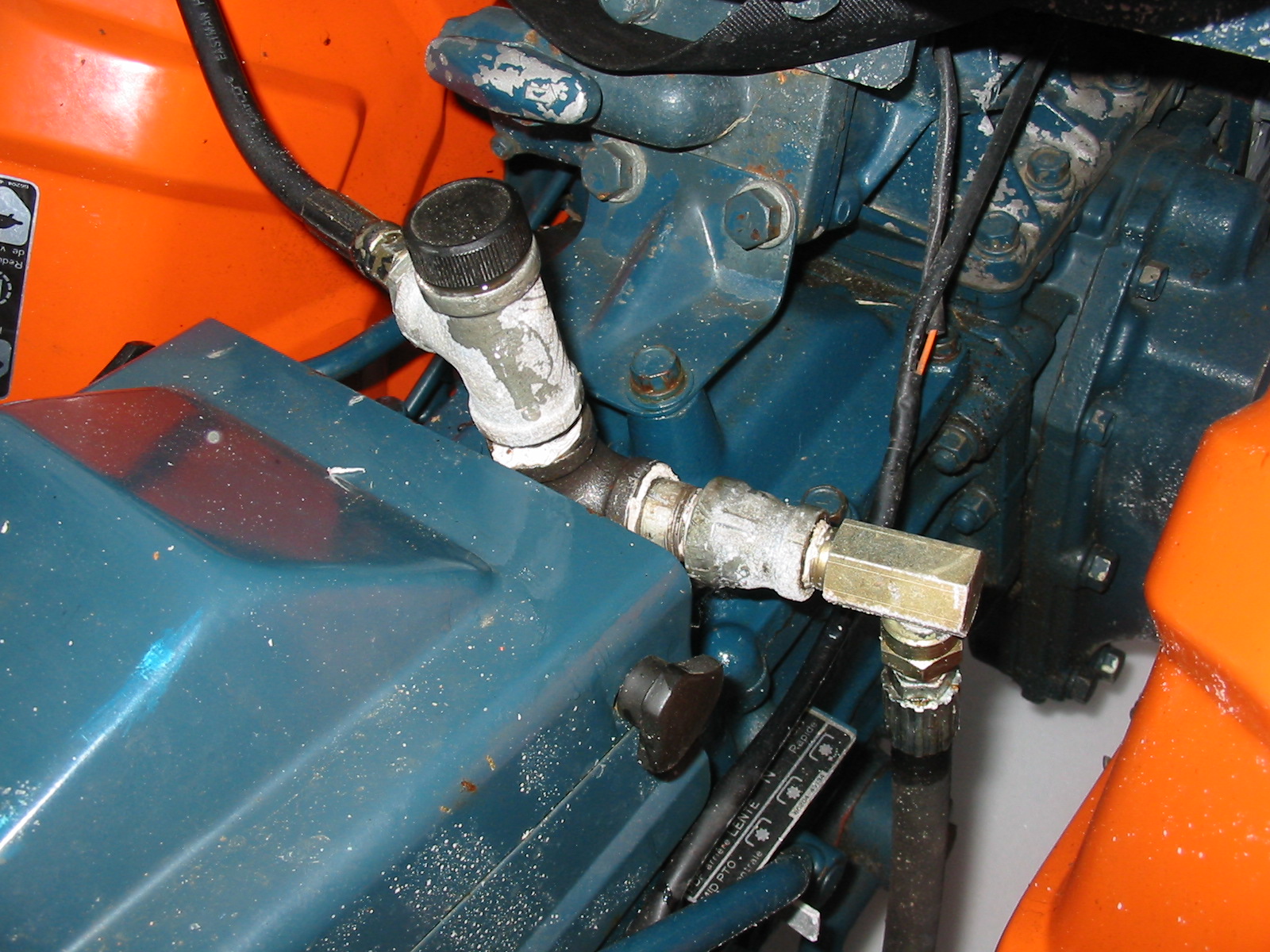

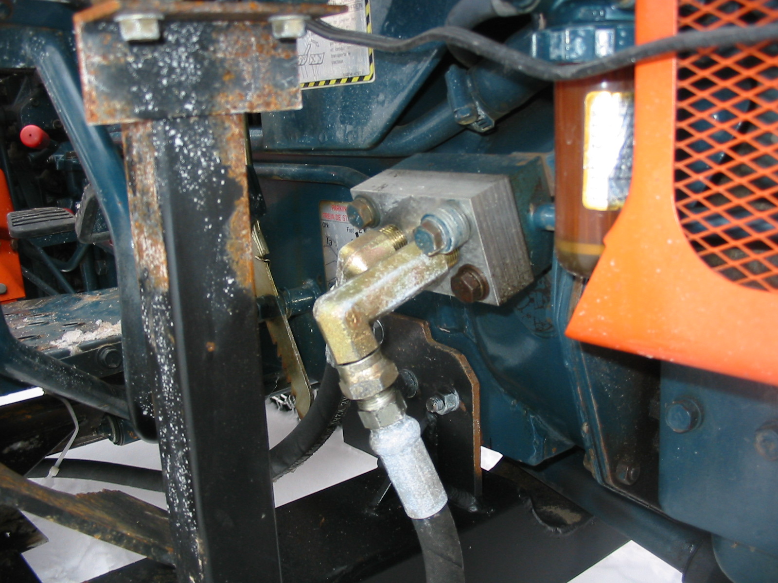

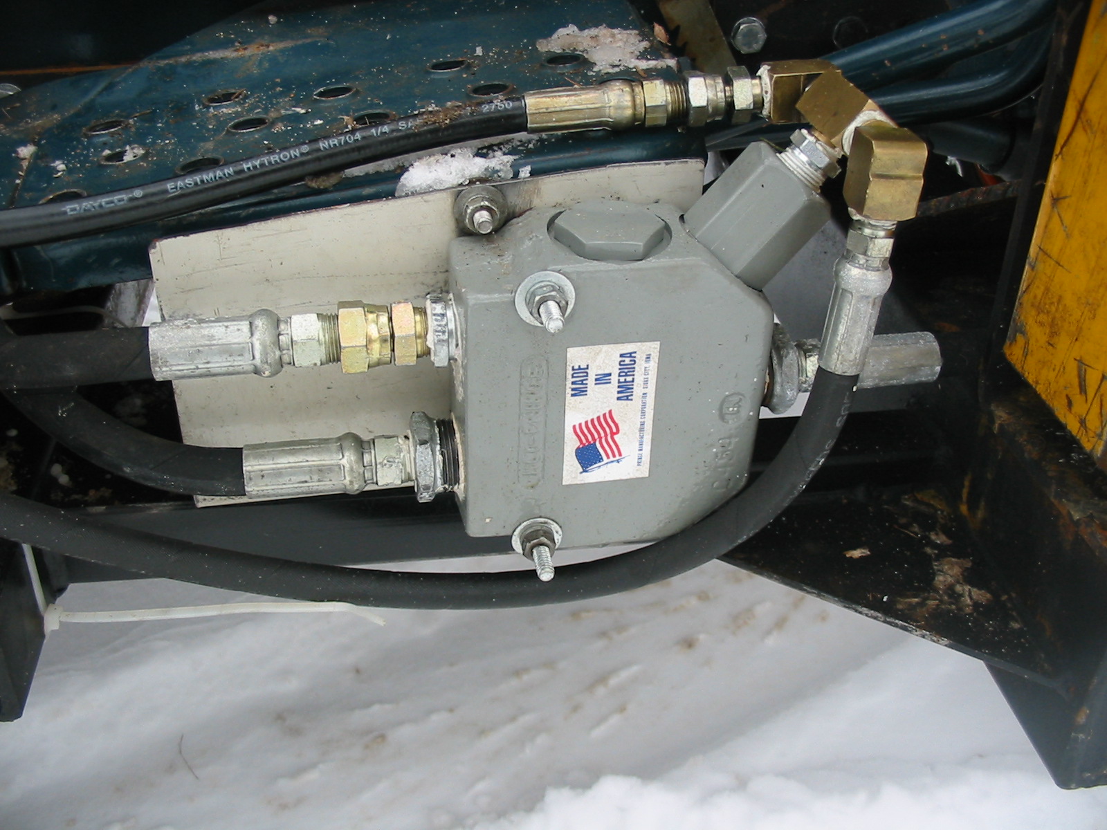

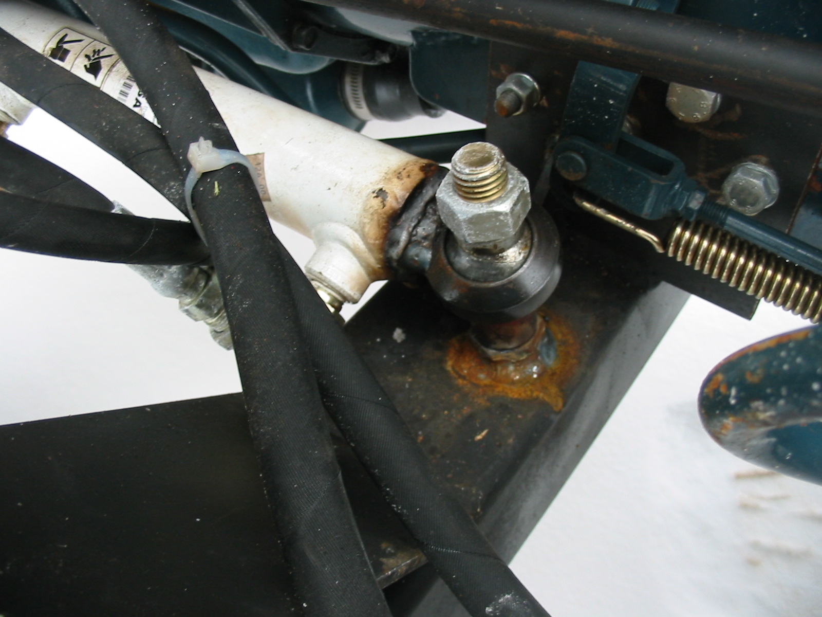

Clarkvg, thanks for sharing the pics. I like the chains, they look like you can drive through anything. When I first looked at the PVC pipe I thought, gee that's large...I wonder if it floats too much. Maybe 1 or 2 inch would be better?
On the P/S, can you give us a parts list and where you got them? Also a plumbing schematic or description of how it's setup? Thanks!

Clarkvg - Looks good. I hope it continues to work well for you. Question - I see all the lines hooked to your flow divider, but one has a two with two lines attached. What do those two lines go to? I would assume normally one high pressure line in, one regulated out to the power steering, and the third being the rest of the flow back to the tractor hydraulics for the hitch, loader, etc. I would assume the third line would go back to the hydraulic block. Did you T that line to your loader valve?
   / P/S B7100/7200 #110
The 2 lines that are teed at the diverter are the relief valves lines. One for the joy stick/loader and the other for the power steering. They go to the fitting under the fill cap as does the return line from the control valve.
As mentioned before the control valve line has to go back into the system directly otherwise you will have backflow problem.
The chains help a lot on ice. The road to my barn has a grade and a slope and there is ice under the snow. Without the chain I would slide down the slope into the snow bank. Some of you may know that feeling. We got a Bobcat stuck in there last week.
I read the posting on using PVC pipe and the only pipe I had was 3", so I used it. I plan on taking it off for snow removal.
