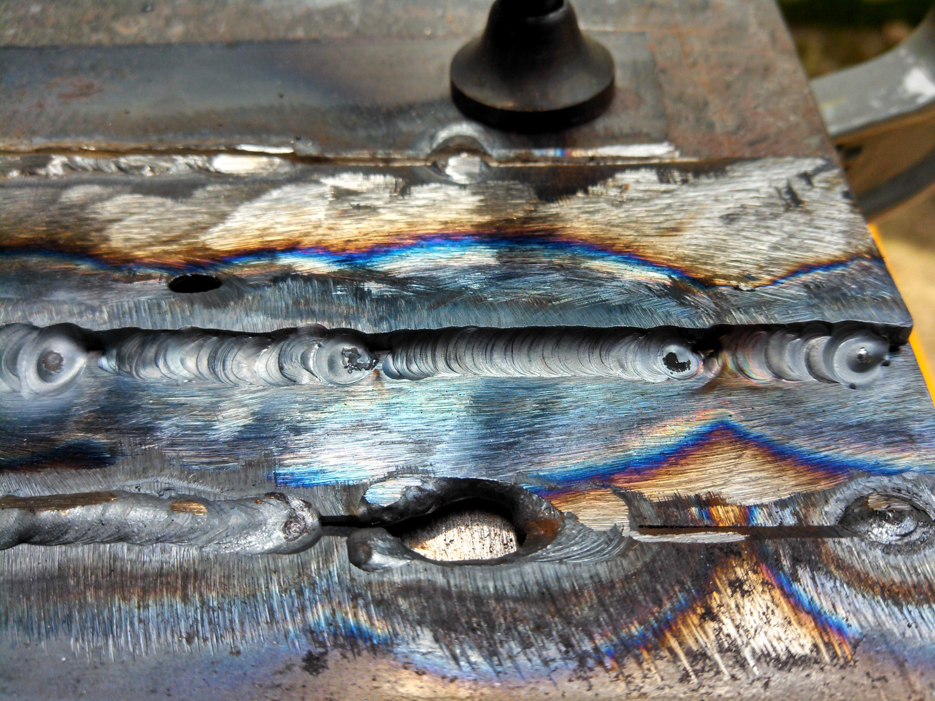

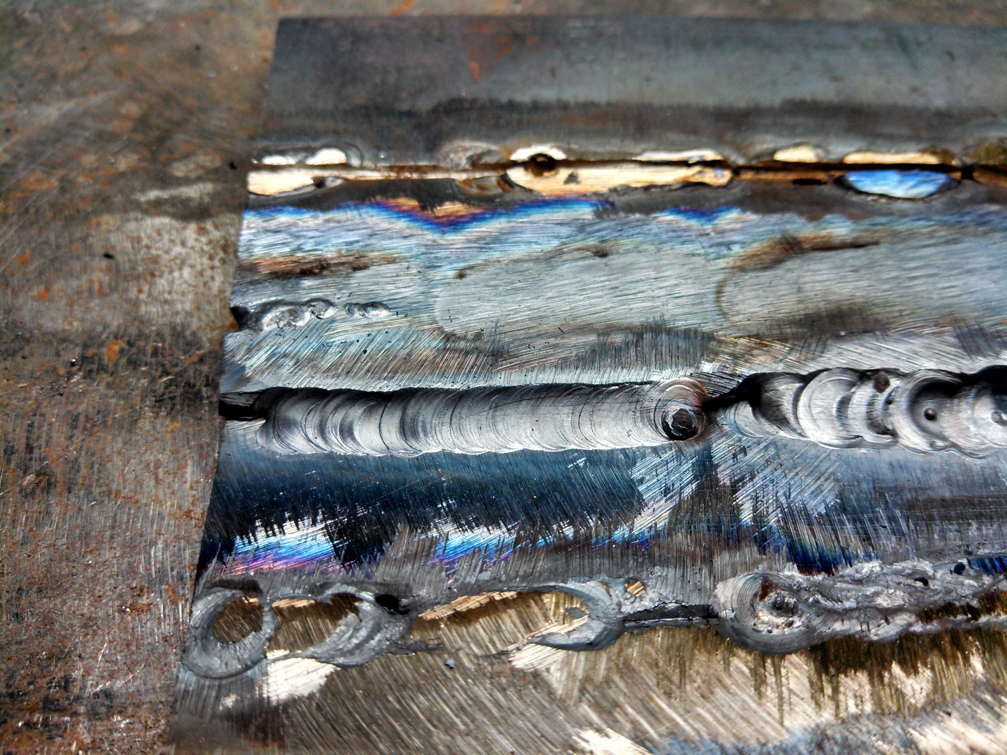

A small update for y'all, just for fun. Here's some lap joint work I did today. I was at about 100-110 amps max pedal. For simplicity, I used a lay-wire technique and tried to focus on torch angle and travel speed/consistency. Other settings were: 3/32" 2% lanthanated (blue) electrode, 1/16" and 3/32" filler, but mostly 1/16" as the 3/32" was really too much. About 5-6 lpm of gas, which I think was a bit too low, as I got some porosity on the back side--but there may have been contaminants, as there was also a little boiling and sputtering. Metal was 1/8" mild steel.

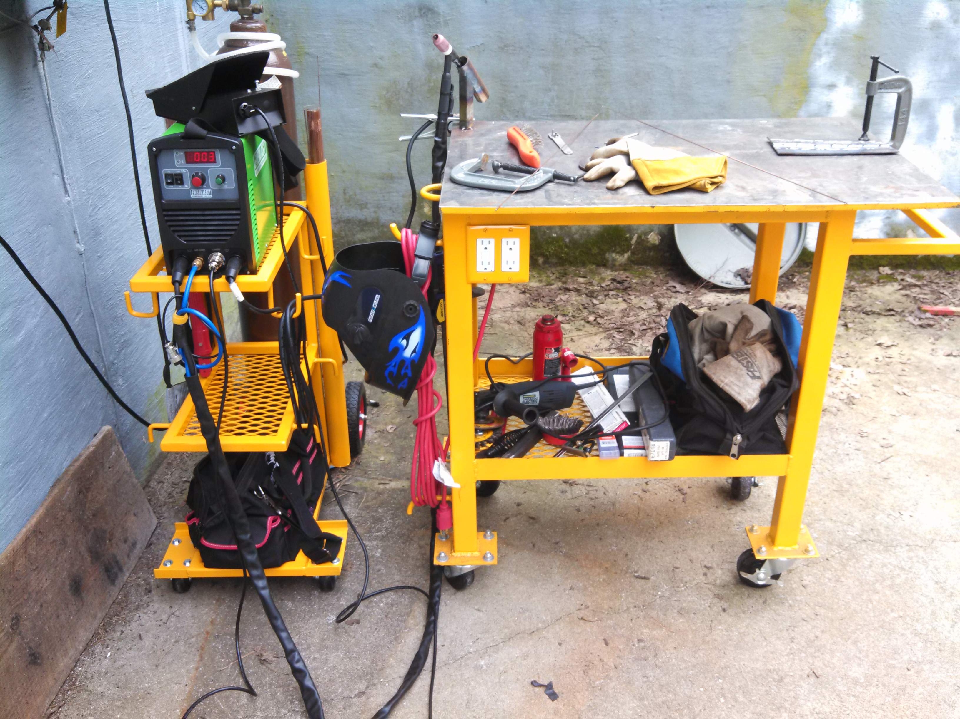

Here's my current setup.

Could use a bit more gas, unless you were using a very small cup.
And could use more filler. Some times one size of filler is too small, and the next bigger is too big for using lay wire technique. Time to start to learn to feed wire.
Have you wached all the TIG videos from www.weldingtipsandtricks.com
They are very good.
