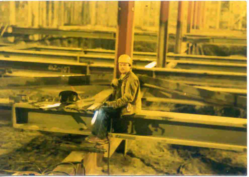

In my line of work we didn't always have the luxury of working to close tolerances. It was more blow and go! On this project we placed a million tons of falsework. We set these beams in place, and used two 100-ton jacks to jack against the vertical beams at the walls, then hard shimmed the beams before welding them. Right where this guy is setting, I seen a guy take a very heated a $ $ chewing for re-picking the beam because he missed the mark by 1/32 of an inch.
