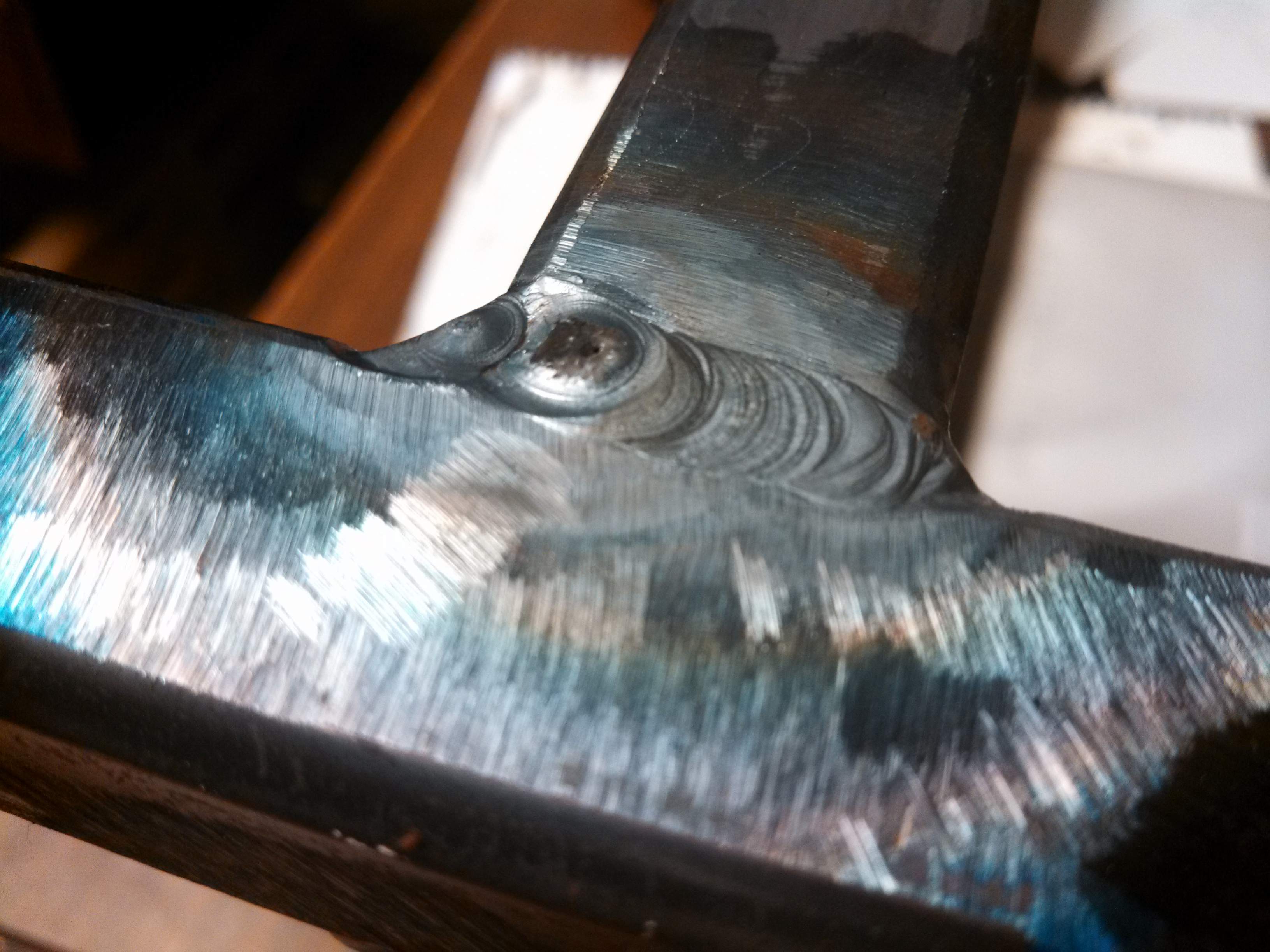

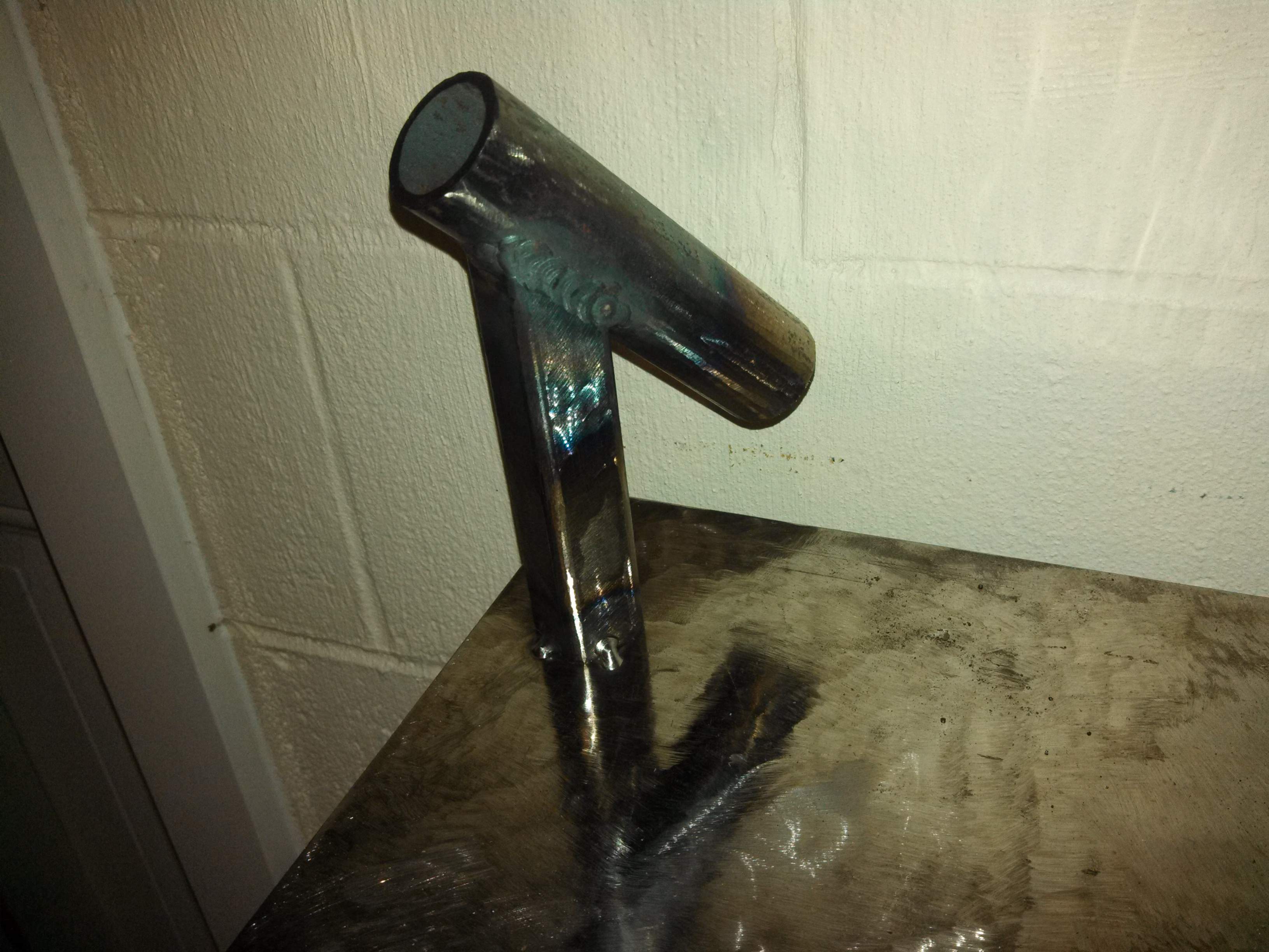

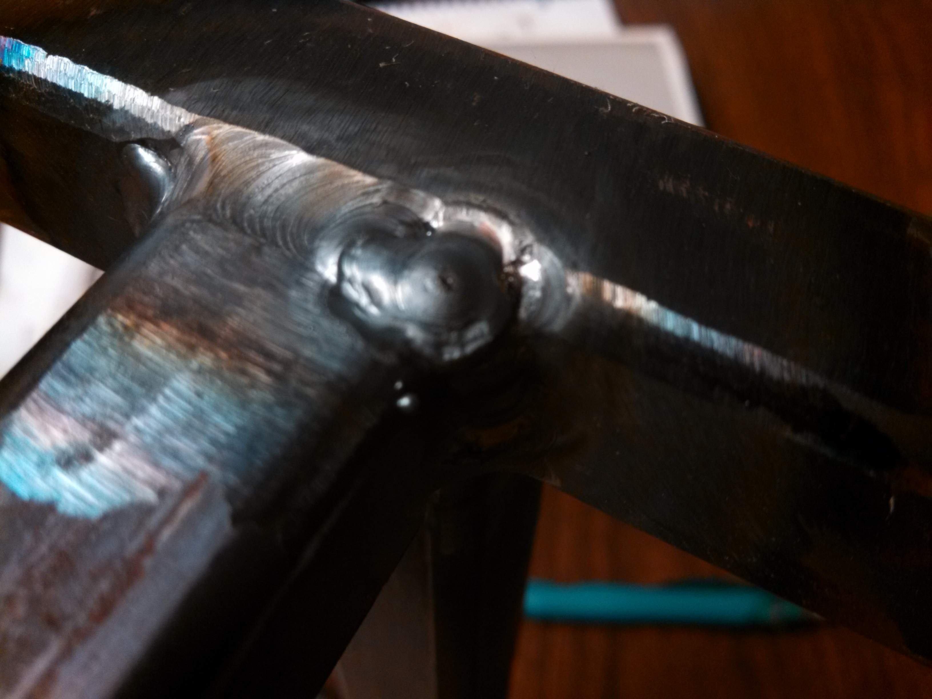

I made a holder for my TIG torch out of some scrap tubing. The most fun part was manually grinding the square tube to fit the round. Also, a few more shots of some welds. I am having a lot of trouble feeding enough filler to avoid cratering. The Miller calculator suggests 3/32" for 1/8" material, but I'm using 1/16" because somewhere else I got the idea that's what I should have. I suspect I would be a lot happier with the larger filler. I have been half tempted to hold two rods together and feed them at the same time, essentially making a 1/8" filler, but I just try stabbing the 1/16" in faster instead.

The rule of thumb for fillet welds (this was a 90 deg. corner) is the leg length should be equal to the thickness of the plate to have the same strength. Over this is a waste and an overestimation of strength. If you get some penetration to the inside is good but as long as you get penetration to the heel, you'll have the strength. It also leaves a very smooth rounded corner that requires very little clean up and/or grinding. The time savings are more than half. Consider if there wasn't a big enough opening to get at the inside to weld it? Many tanks are built this way with just the outside weld.
