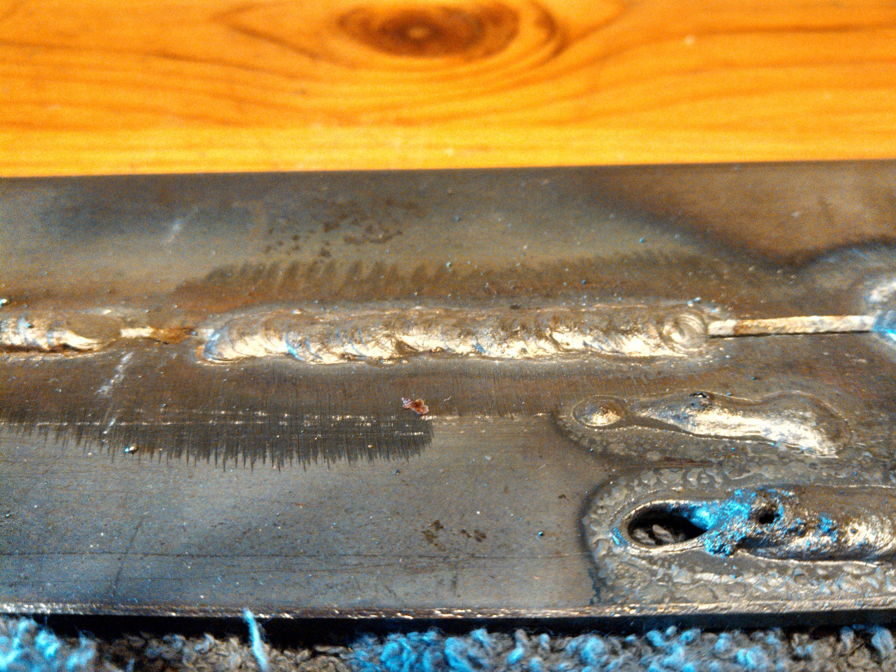

Honestly, I ran, like three inches of weld before it started raining and I had to run in. Technically, the last two inches of bead were in the rain! Here's what I'll give you, though:
This is the very first weld I ran: 130 amps, 3/32" 2% lanthanated, 1/8" material, butt weld, beveled. No filler wire--just getting a feel for the torch. I think I may have misread the chart when I looked up my amp range, because Miller's weld calculator shows a max of 120 amps for 1/8" material, and this weld did seem pretty hot. You should see the back side! Drippy! Anyway, there it is. I'll post some more pics when I have a little more time with it and feel like I've got something worth posting.

Actually that's not bad at all, in fact that is pretty dam good for just starting with Tig! :thumbsup::thumbsup:

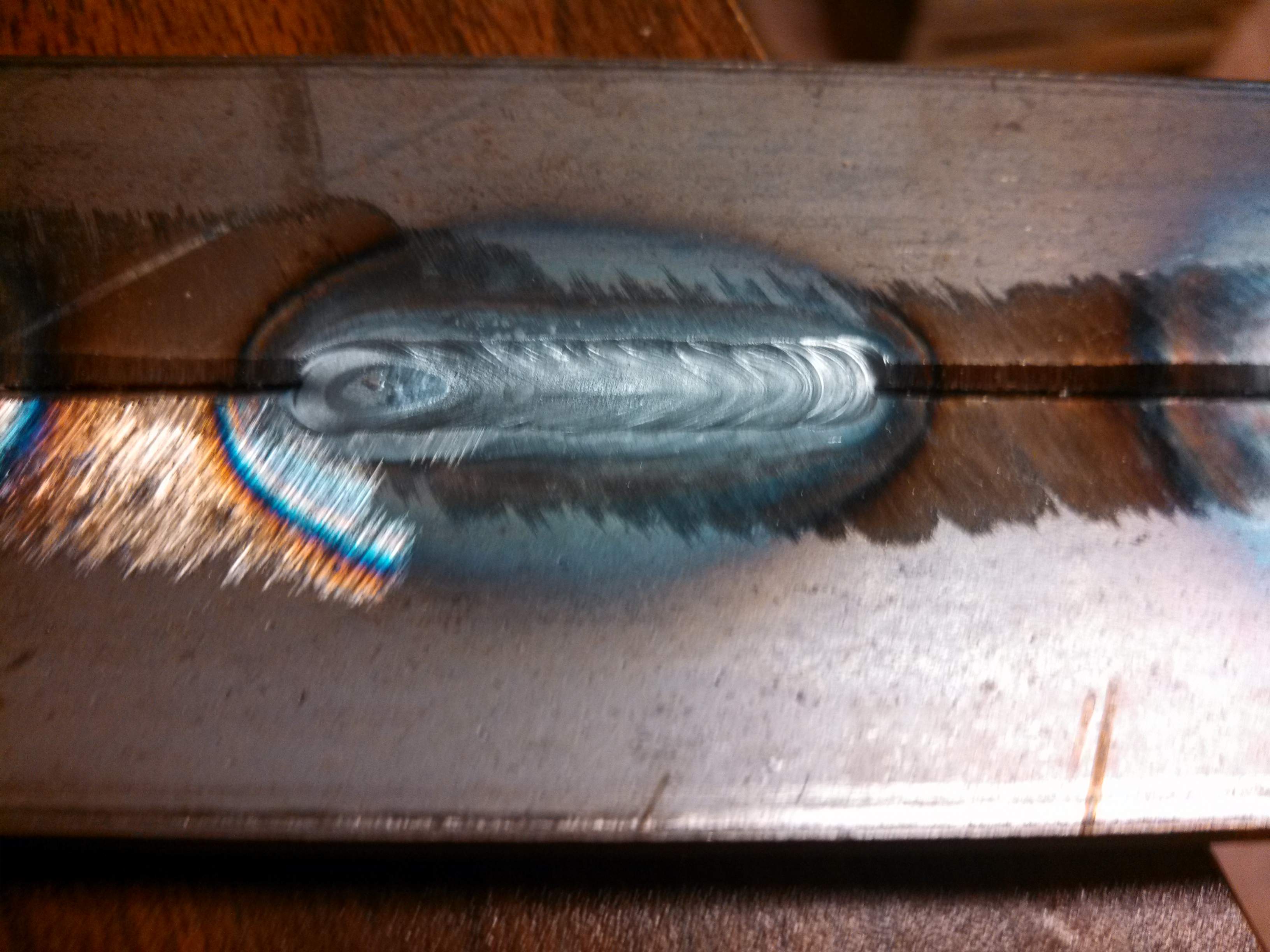

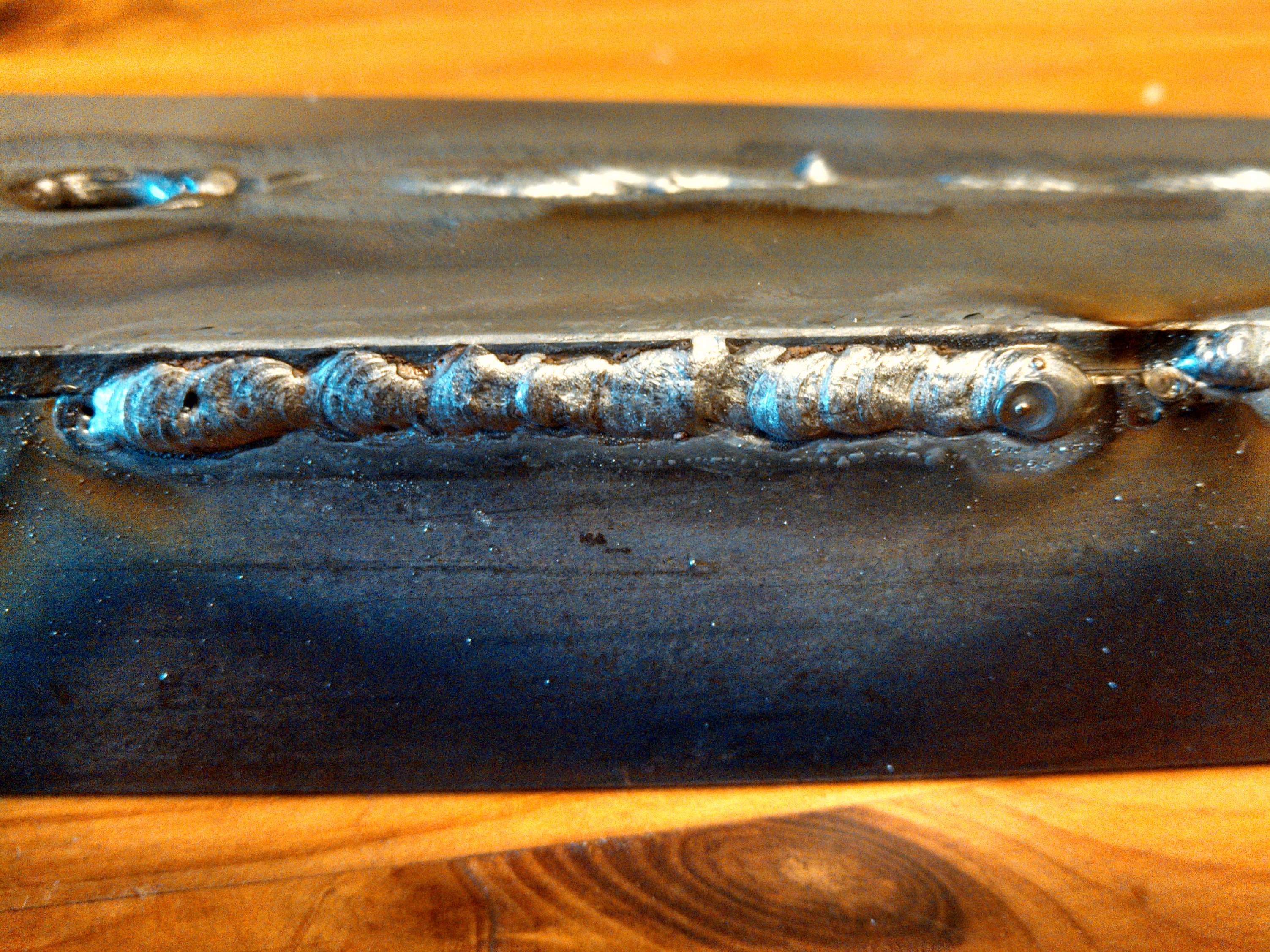

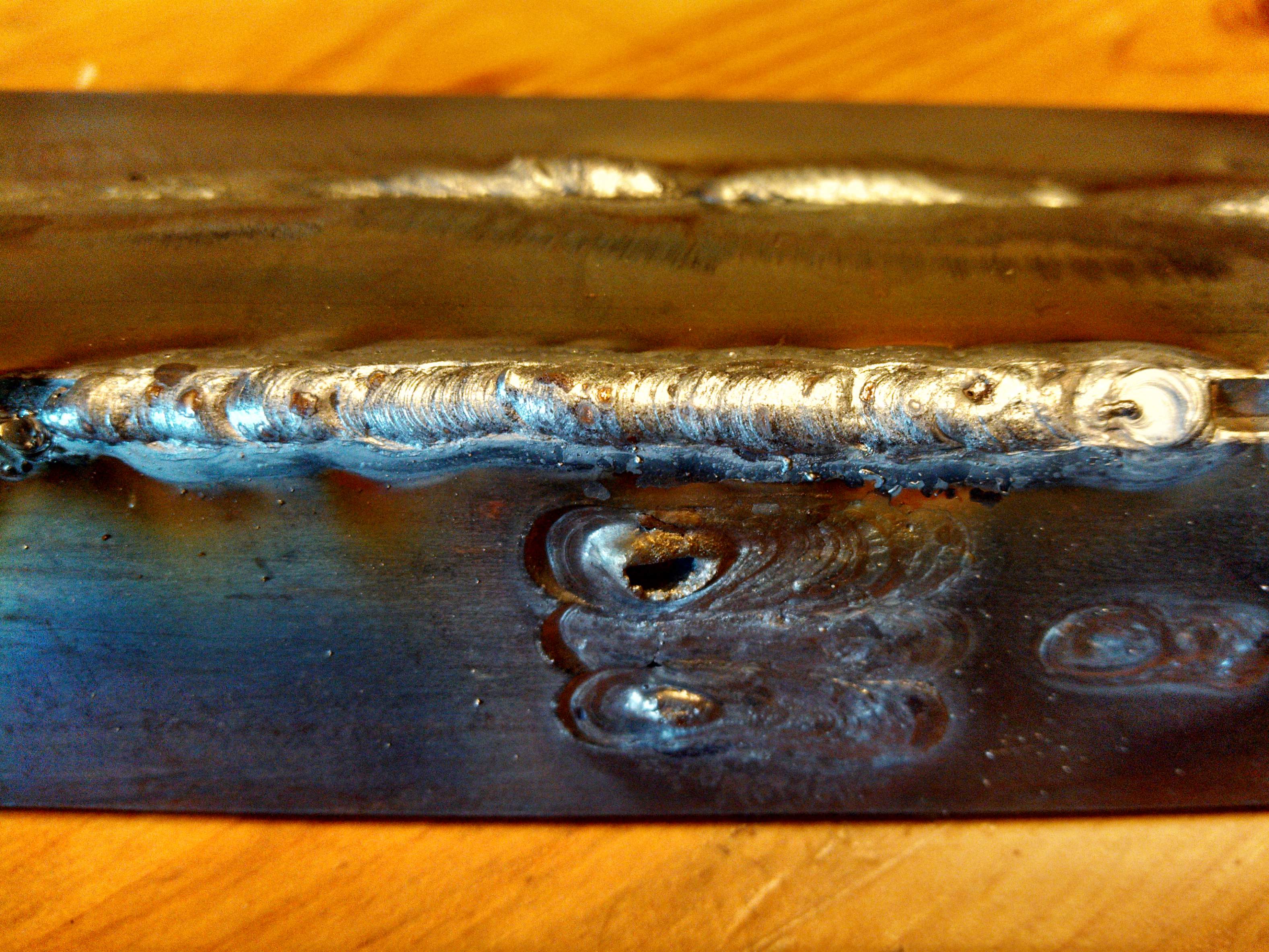

All right. Here are a few more pics. Only the best few, that don't look like an arthritic monkey was holding the torch. Ironically, my best TIG welds look not dissimilar to some of my worst stick welds. Take from that what you will.
Settings were: variable (pedal) amps, 3/32" 2% lanthanated electrode, 1/8" material, argon at up to 20 cfh, #4 cup.
Starting out, I was working with fixed amperage and the finger switch, but I got tired of seeing volcanoes at the end of my welds, so I switched to the pedal just so I could back off slowly at the end. I planned to still run flat-out / fixed amperage, using the pedal's rheostat to set the max output, but I immediately saw how useful it was to be able to adjust the heat mid-bead, and ended up throwing the plan to the wind and just going for it.
I fouled a lot of electrodes. I ground both ends of the electrodes to a point so that I could go twice as long without having to walk back to the barn and regrind.
Early in the process, I thought the electrode was eating itself up kind of fast. It ended up balling up. I turned the gas flow up from about 14 cfh to about 20 cfh and that fixed it. The Miller weld calculator only calls for 11 cfh for this joint, with between a #4 and #6 cup, so I'm not sure why my flow is so much higher. Possibly the gas flow wasn't the cause for the electrode balling up so fast. I dunno.
The Miller calculator only calls for a 1/16" electrode for this joint. What's the effect of using a larger electrode than is called for? I know larger electrodes have more current-carrying capacity, so the down-side of using too small an electrode is obvious, but what's the tradeoff for using a larger-than-necessary electrode?

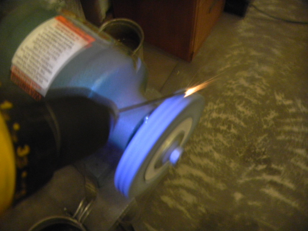

I've got to the point now where I just use ceriated (orange) tungsten for everything. Zap over on WW has a really great idea for sharpening tungsten with a drill motor and bench grinder. Don't get too hung up on everything you read. It's not a perfect world, you have to find what works best for you, and your equipment. ;)
