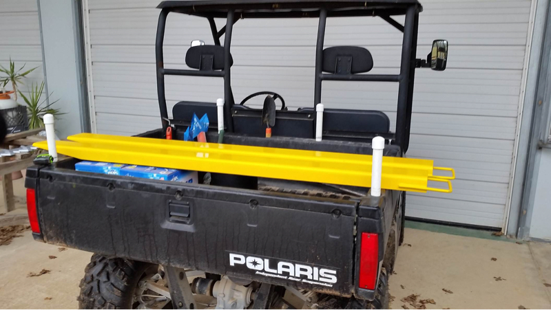

Tried out new Titan 72" fork extensions today placing newly painted diesel tank stand on its new base. Worked very well although not a heavy load. Used some sections of old inner tube to protect the paint on the stand.

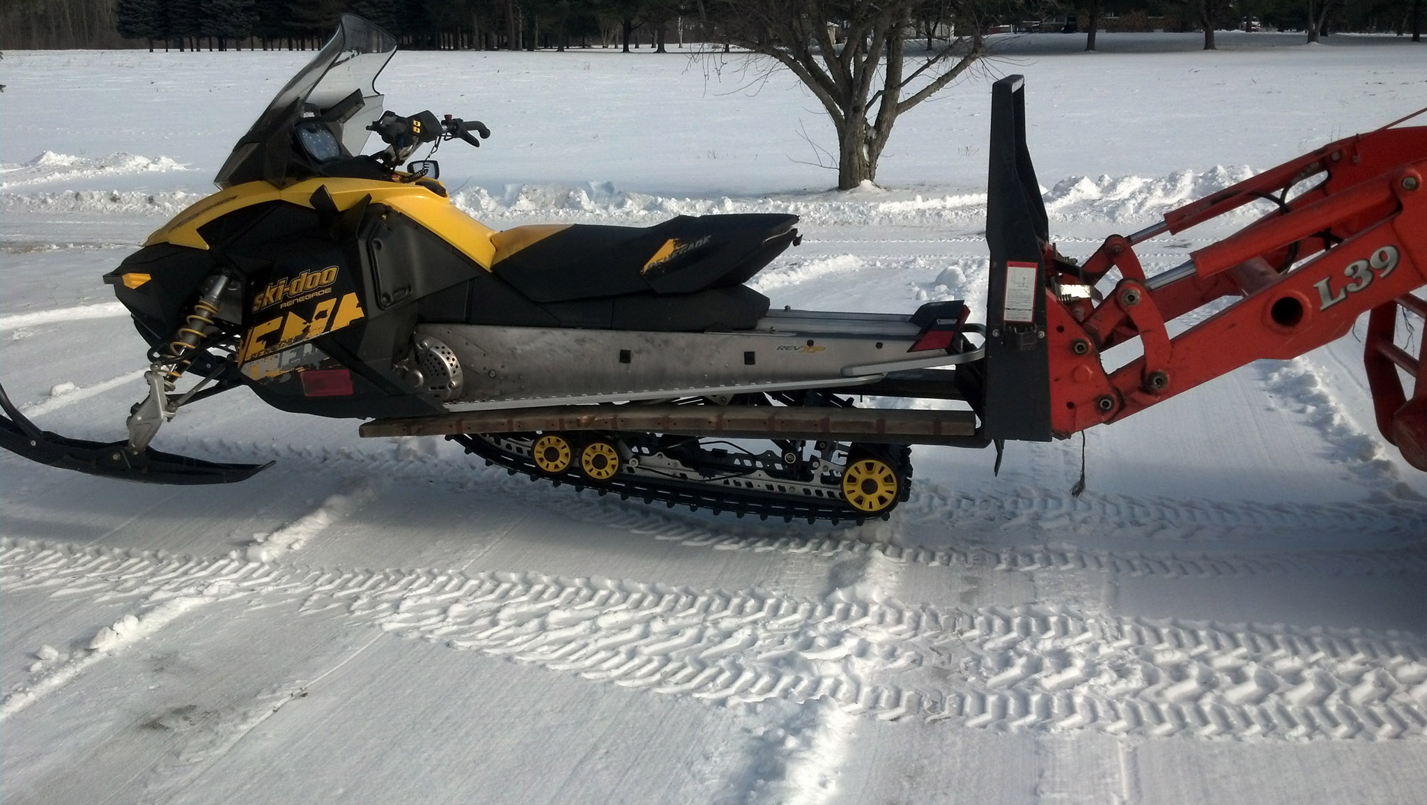

Thanks for the tip. Bought 84x4.5 forks from Titan for $179 shipped.
They only weigh 96 lbs. Seven feet should allow me to pick them up from the front. Current forks are not long enough because the skis extend out from the front. The existing forks support them the first three feet do they should be plenty strong.
This will be super convenient because we store them in a shed without fuel or battery. Probably use it to move firewood as well.

My 84” came last week, used them yesterday. They make moving around the snow machines a lot easier and faster.
This is a Yamaha Venture, a two-up 4 stroke sled that’s about as heavy as they get: probably over 700 lbs. No problem.
/ Pallet Fork extensions #28
Those look really helpful! have to put them on the santa list... yeah I pull the battery and belt when I put them away so this would save a lot of pulling and grunting to get into position..
