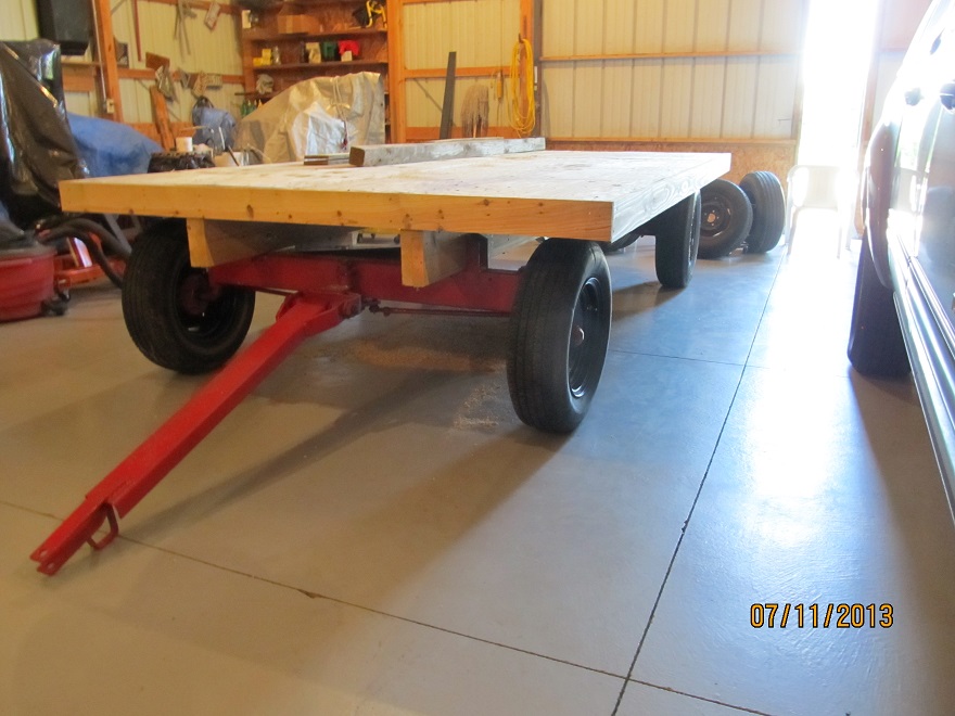

Kory will be a great gear and 2x8's will likely look the best for stringers. For your 4 x 4's it looks best to have one on either side of the tire and not over the top. You can have the same clearance but it looks more balanced. If you want a plank flooring take a look at the 1" pressure treated boards now sold that seem to have a less-rounded edge than the old style. If you use these I would nail down fast before they warp and leave no gap since they shrink a goodly amount. A problem with any plank floor is they can be somewhat uneven and people can pick up splinters or trip. I really think a plywood deck with a framed edge looks and feels better, shrinks less, and is easier to frame out for a quality look. Spend time picking out 4 x 4's with very little wind and nail/bolt everything together FAST/same day before things warp and wind.
All this is subjective personal opinion but I've built a number of wagons and think I understand the look you are going for. Here's one that's 7' by 12' I recently built that is just for storage of some awkward equipment but will likely double as a small parade wagon. Good luck.
The tire size that seems to look the best is a 7.60-15 rib implement farm tire or the passenger size equivalent of 205-75x15. I have the 205-75-15 on the wagon shown.
Also, if you use 2x8 stringers and 4 x4 posts you will need 1/2 x 12" carriage bolts to put them together. A 9/16 spade bit works best and drills the easiest. The bolts can be hard to find but Rural King Farm stores carries them for a ffair price. Hardware stores occasionally do but the price is often higher.
