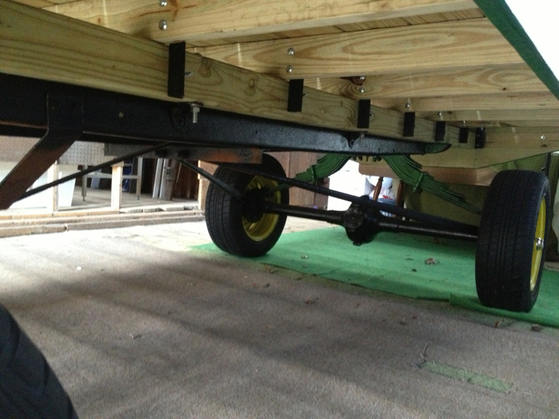

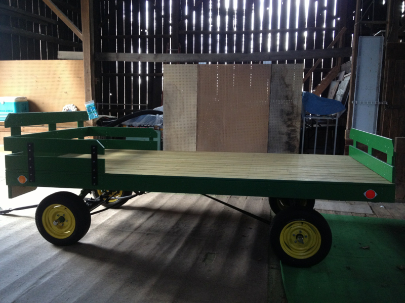

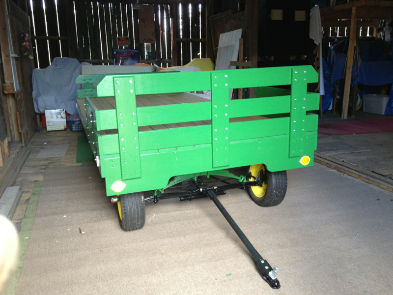

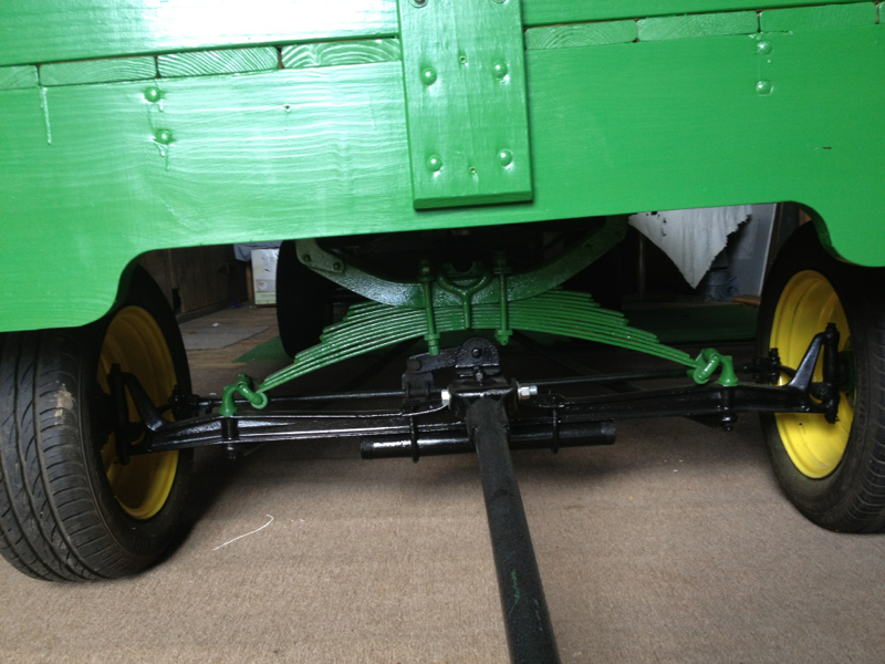

Here's one a friend of mine built from scrap minus the running gear which which he restored.
   / Parade/Hay Ride Wagon #50
Looks like a Ford Model T frame.
Bruce
