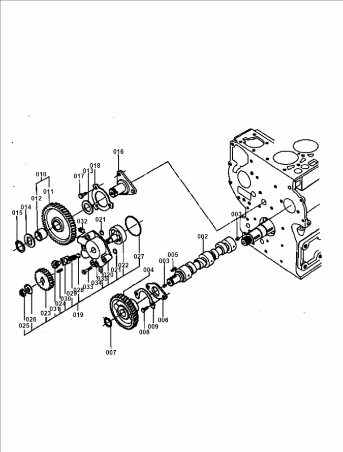

dunno what ill do if the lights still on. where is the pump anyway? /forums/images/graemlins/crazy.gif

<font color="blue">where is the pump anyway? </font>
Looks like it is behind the front engine cover. Never been that deep. Manual say's it is item #20.
Gary
