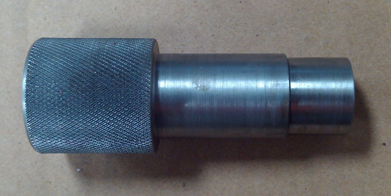

#38
I need to replace the piston pin bushing in the connecting rod. My Yanmar manual lists the dimensions for an SST to remove and replace the bushings and the source for the SST is "manufactured locally". So, I went over to a buddy's house and we used his lathe to turn out the SST. I used the critical dimensions for the tool as listed in the manual, but modified it's design a bit. Here's a picture of the tool:
