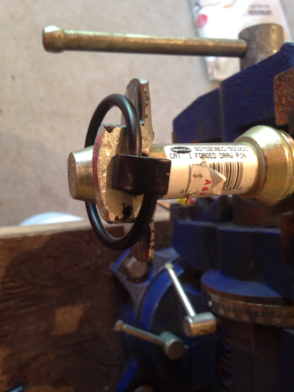

Here is picture I found of how I was installing the pin and washer. The nail on the pin would not fully close. Seems like it is hitting the bent part of the washer first. Is it recommended to grind away some of the bent part to allow the bail to completely close.
   / Pat's Easy Change Vs Quick Hitch #113
Hmmm...the bail hitting the washer may be a result of the larger washer used on a CAT 2 lift pin. If you look at the photos I posted (post #104), the CAT 2 washers are larger in diameter as is the center hole. Bending those, like OEM Pat's does, might result in what you have been experiencing with the bail not closing.
If you are bushing CAT 1 lift pins then you should be using the CAT 1 Pat's washers and not the CAT 2 (larger) washers.
In reality, you don't need the bend in the washers. They only are there to hold the washer in place to keep it out of the way for hooking up the Pat's from the tractor's seat.
You might try just buying some standard hardware store washers that match the diameter of the OEM Pat's CAT 1 washer (get some CAT 2 size as well for those implements). Then when you get off to hook up the top link just take off the OEM bent washers and put on regular washers. The bail on the lynch pin would be sure to close then.

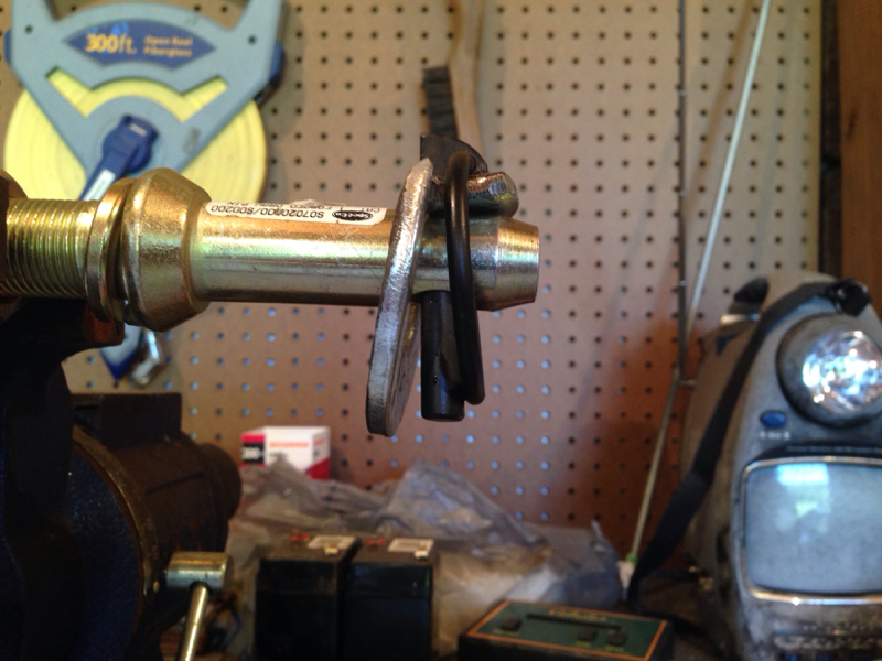

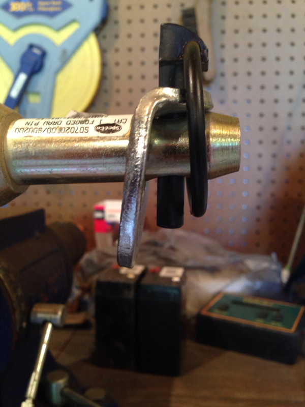

Here are a few pictures of what I am getting when hooking up.

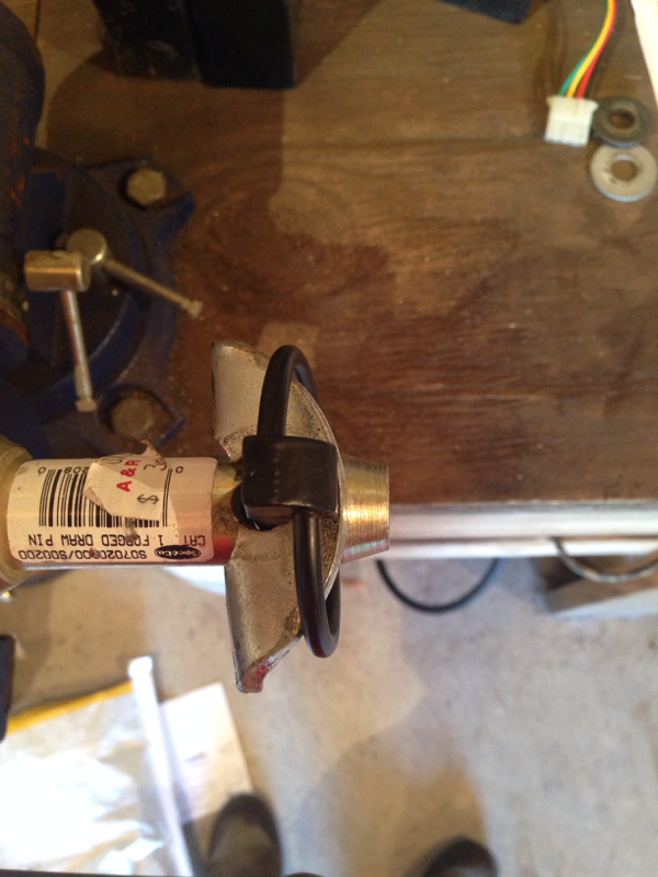

Modification made to washers with grinder. Is the consensus this should solve the issue of the lift arm sliding off the lift pin? Only other thing I can think of right off would be using a bolt with locknut.
No. Based on pics, your problem is mostly due to use of cat 2 washers on cat 1 pins. The grinding will just help a little. Get some 7/8" washers

One of the things I struggled over when ordering was whether to go with straight Cat 2 or the Cat 2 to Cat 1 since I currently do not have any Cat 2 implements. Did not realize there were Cat 1 and Cat 2 washers. If the lynch pin closes how will the size of the washer change how it functions?
   / Pat's Easy Change Vs Quick Hitch #120
I read your quandary on which size to get since your implements are cat 1.-- Good question on the washers. ... Couple of things. Note how the bent flange eliminates the web on the top washer portion. This can let the washer come past the linchpin at the top. -- Combine that with a washer with hole much bigger than the Cat1 pin and its more possible for the washer/Lpin to rise and the washer to bypass the Lpin at top and tip out and down over the end of the cat1 pin. ... ... See if you can contrive to cause this by hand. If theres any way you can do it with the Lpin at least partially in the hole you can bet that the shakin and bangin of non sedate implement use will do it sooner or later.
Your modified Cat2 Lwashers should definitely help, but if the Lwashers for cat one are big enuf OD they would be much better. Std 7/8 washers would be better still because there is no bypass potential. The modified std washers of ? gwdixon hold the washer in its outward position as well for easy hookup.
