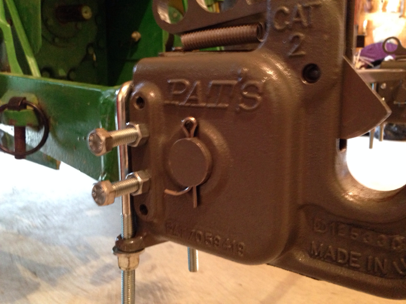

Here are the pics deere. All parts that were shipped were used except for the extra bent washers for the three point pins. ray
This is exactly what I was looking for. Think I will just disassemble mine and reassemble like yours. Have you had yours like
this for a period of time? Any issues with anything loosening due to vibration, etc..?

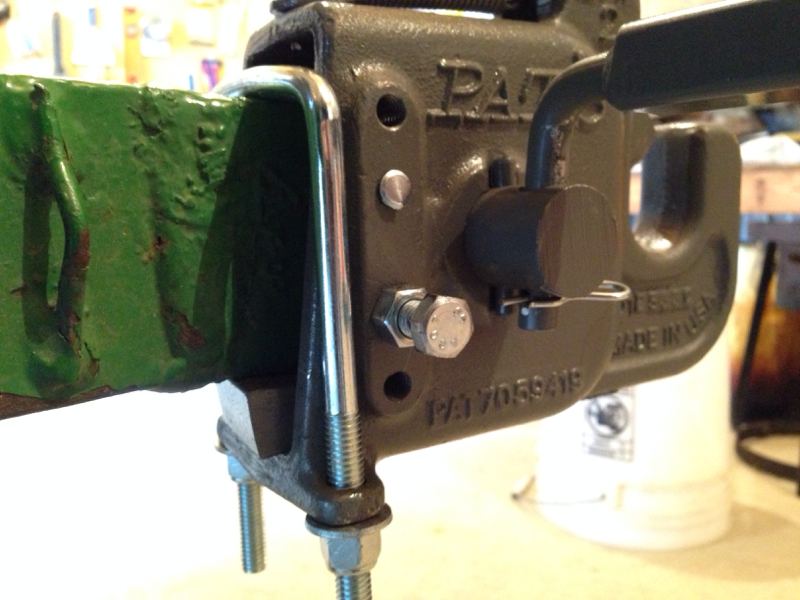

Got it all swapped around and had one bolt on the last turn snap off. Always got to be one to give trouble! Will get an extractor and remove and replace it soon.
Hooking up to heavy 8' disc harrow was effortless. Need to evaluate length of top link as it seems to be extended to the max and could leave little room for adjustment if needed. It created no issues with disc harrow as it seemed to have enough length to level it as needed.
This also has me curious about the rotary cutter shaft. May go ahead and hook to it to see how that fits too. Have seen some comments where they had to be extended with use if the PEC.
Last decision to make will be whether to paint JD Green. Thanks for the helpful comments and pics.

   / Pat's Easy Change Vs Quick Hitch #94
PEC does move your lower link hook up aft about 4".
You may need a longer top link...I didn't, but some TBNers did.
