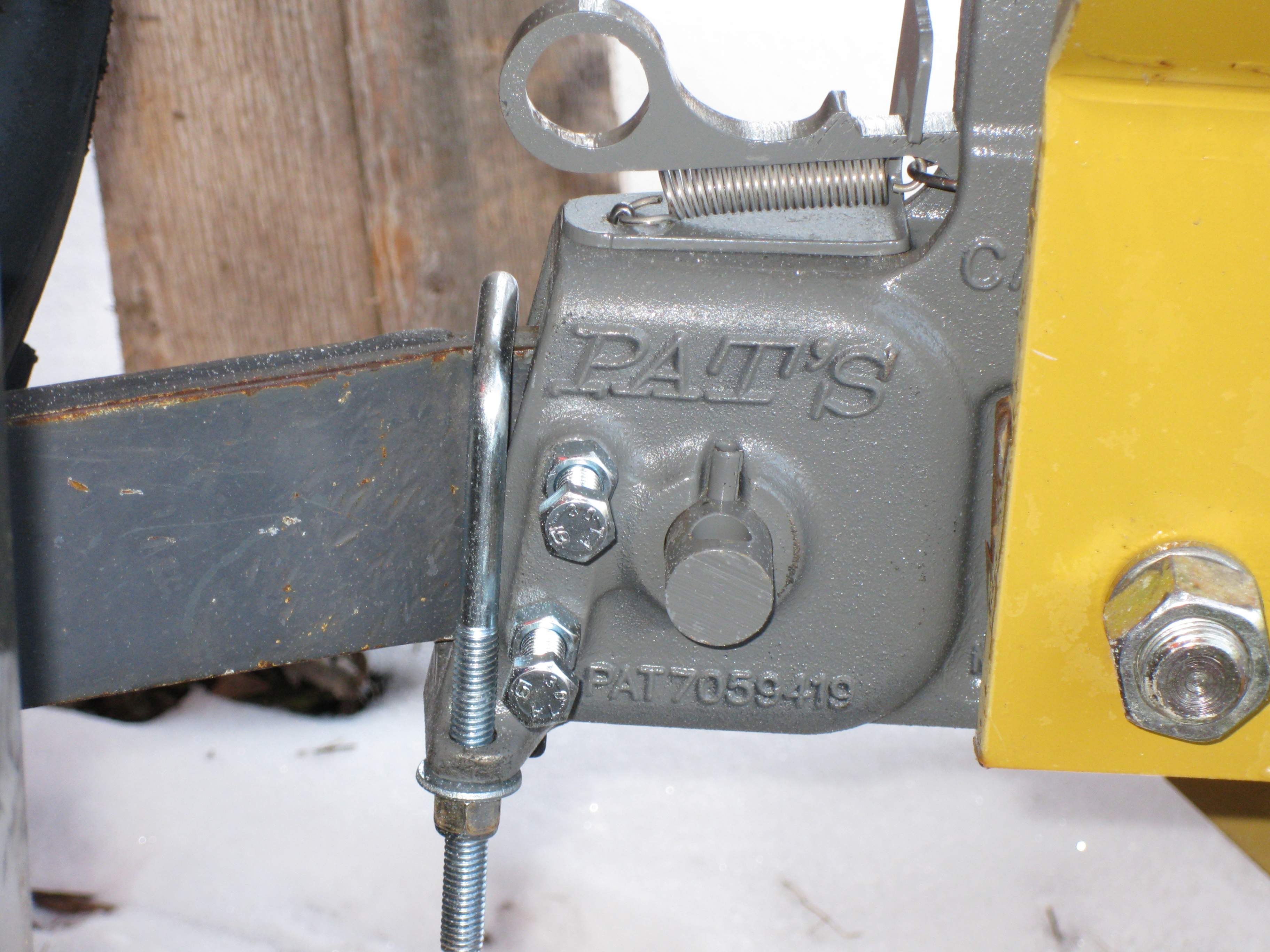

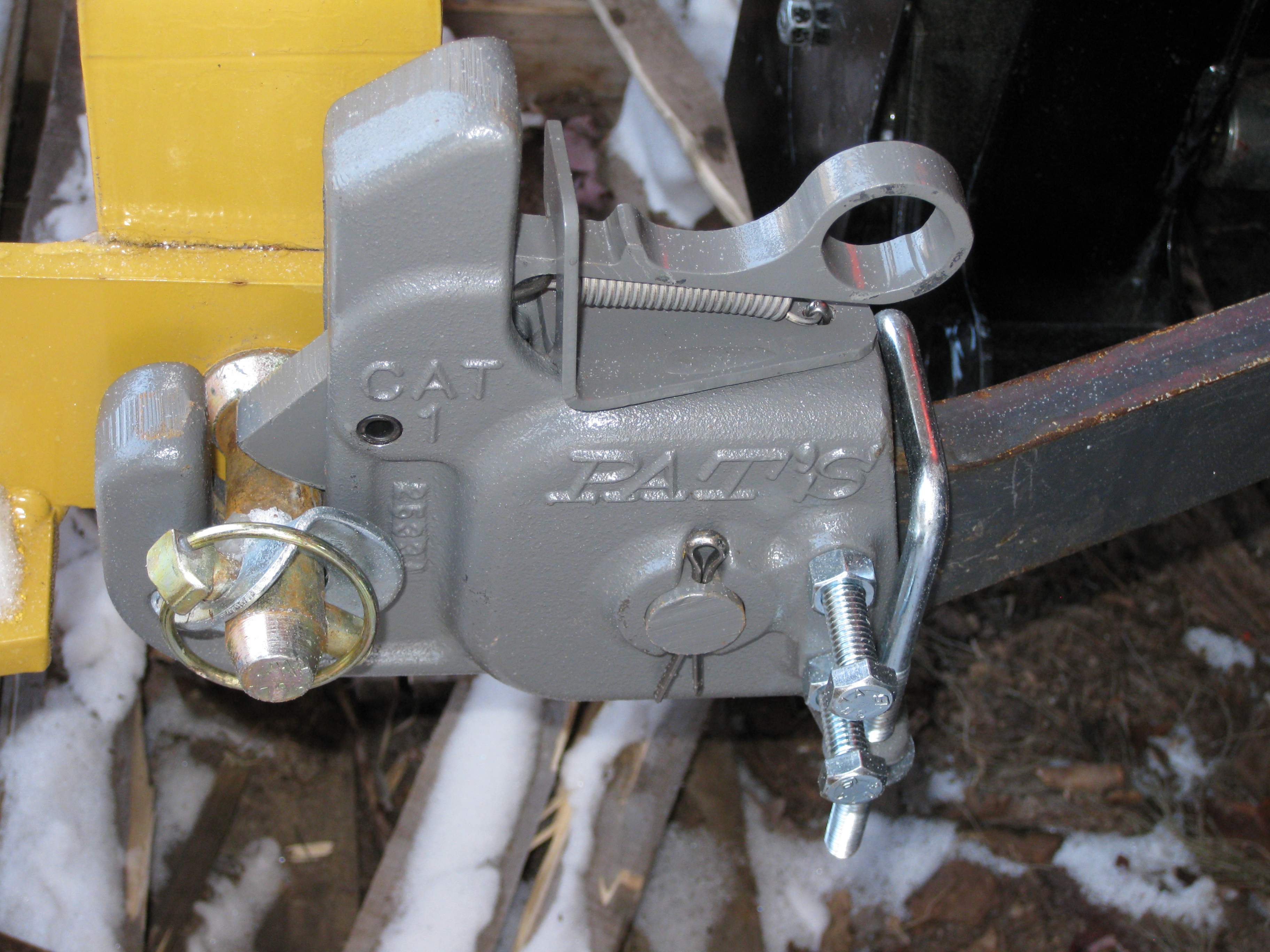

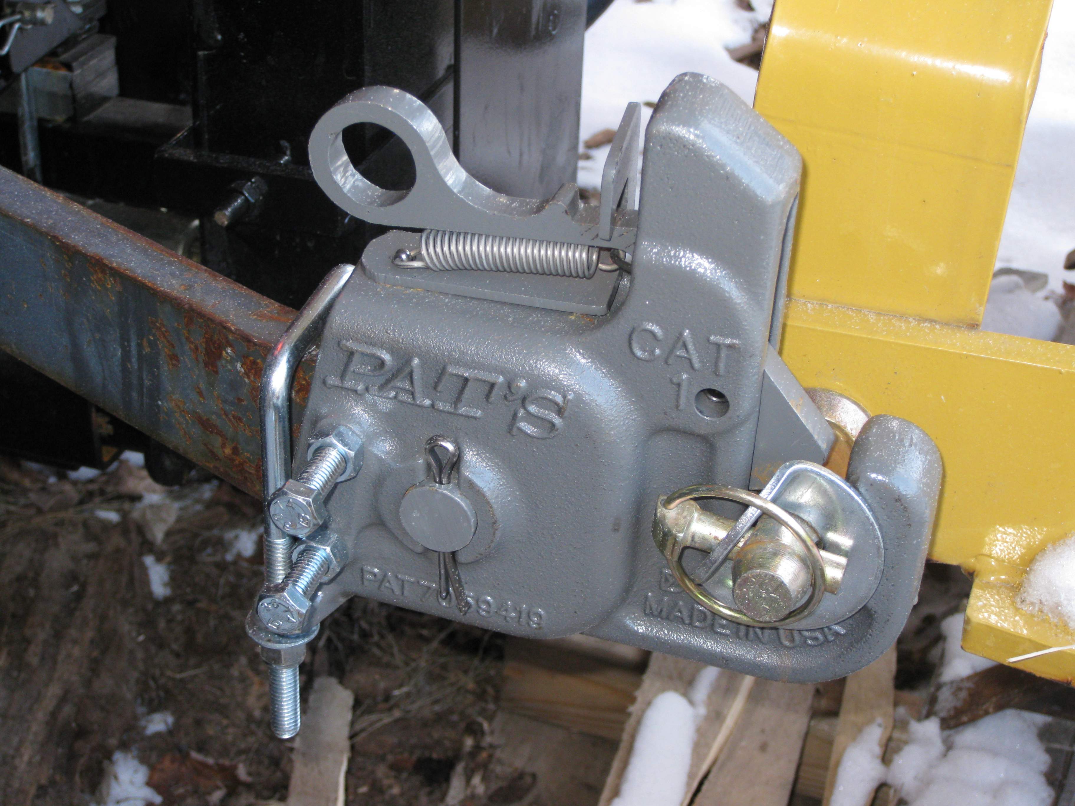

   / Pat's Easy Change Vs Quick Hitch #84
Would it be possible to post a pic or two of how you have yours installed?
See attached. Does this help? U bolts have two nuts, the hex bolts do not.
#85
See attached. Does this help? U bolts have two nuts, the hex bolts do not. <img src="http://www.tractorbynet.com/forums/attachment.php?attachmentid=352460"/><img src="http://www.tractorbynet.com/forums/attachment.php?attachmentid=352461"/>
Yes.
I put two on the U-bolts, but none on the hex bolts. Based on material sent, it seems the intent was to put the 4 lock nuts on the 2 U-bolts and the 8 single nuts on the 8 hex bolts. Seems there has been a change from Allen bolts to hex bolts. I didn't initially think about running the nut all the way on the hex bolt then tightening the bolt then running the nut against the PEC.
Is that your interpretation if the manufacturer intent?
   / Pat's Easy Change Vs Quick Hitch #86
Yes.
The company that makes Pat's Easy Change is pretty small. They probably ship the fasteners they have on hand which might be why you got the hex bolts. You could call them for confirmation, if you like. They're a friendly crew down there and I'm sure they'll answer any questions you may have.
BTW, this may have been posted previously...when hooking up an implement, I suggest you use the black lynch pins rather then the zinc plated ones. The black pins have more tension and are less likely to come off (which means you lose the pin and washer...and the lower arm may come off the implement).
I did lose the washer and zinc plated pin more then once when mowing...and it can be a real PITA hooking that lower arm back up on a slope (been there!). When I went to the black lynch pins, I never had another problem...but be warned, they really snap shut! I had the bruised fingers to prove it.

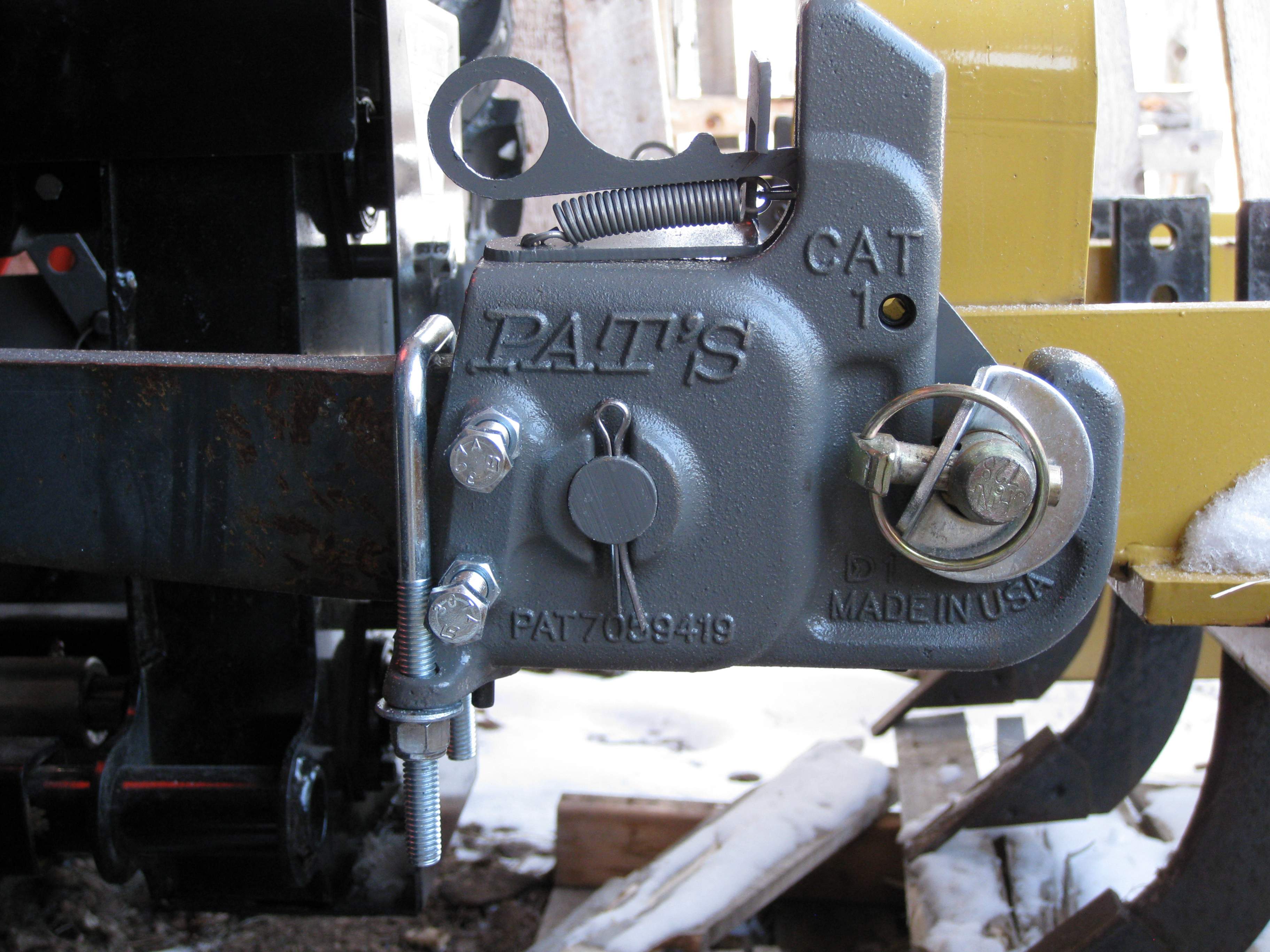

#89
Deere i'll post some pics tomorrow morning . ray
Thanks.
May take Roy's advice too and contact Pat's to get their intent on installation. Seems a consensus on how it is supposed to go together.
   / Pat's Easy Change Vs Quick Hitch #90
Here are the pics deere. All parts that were shipped were used except for the extra bent washers for the three point pins. ray
