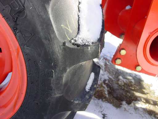

We have a pic of an L5030 on R-4's stock. There is about 6" between the loader bracket and tire with the wheels straight.

And here we see stock ag's on a L5030, about 3" or so clearance with the wheels straight.

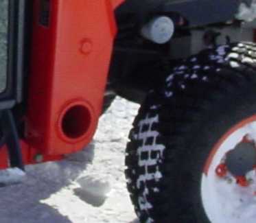

Here are the turfs, again with about 6" like the R-4's.
