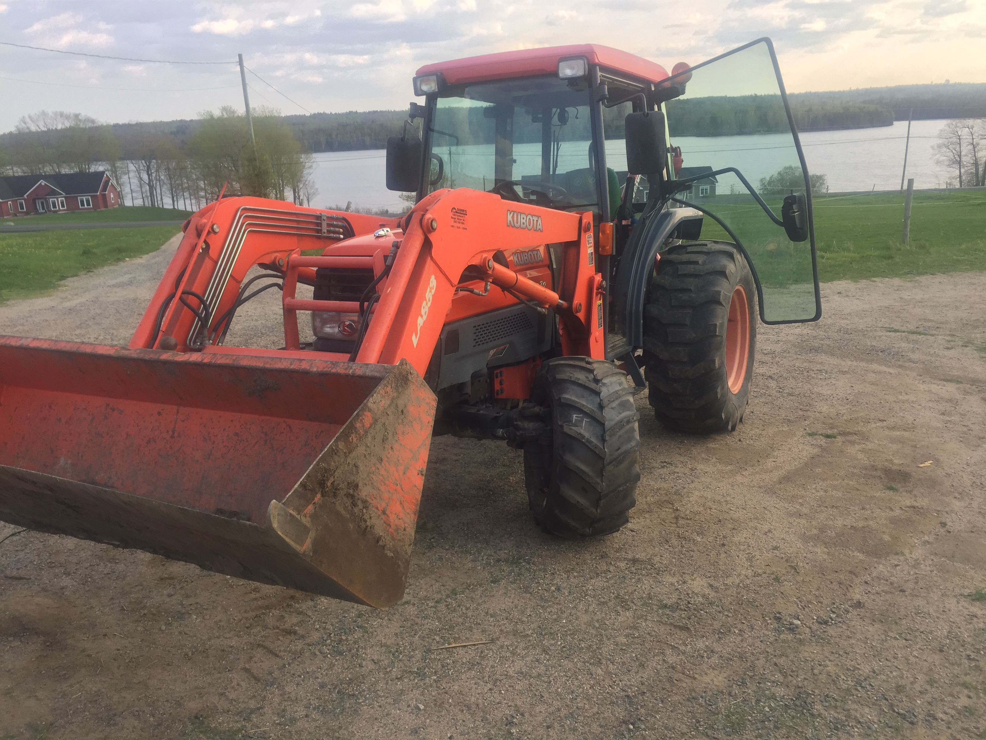

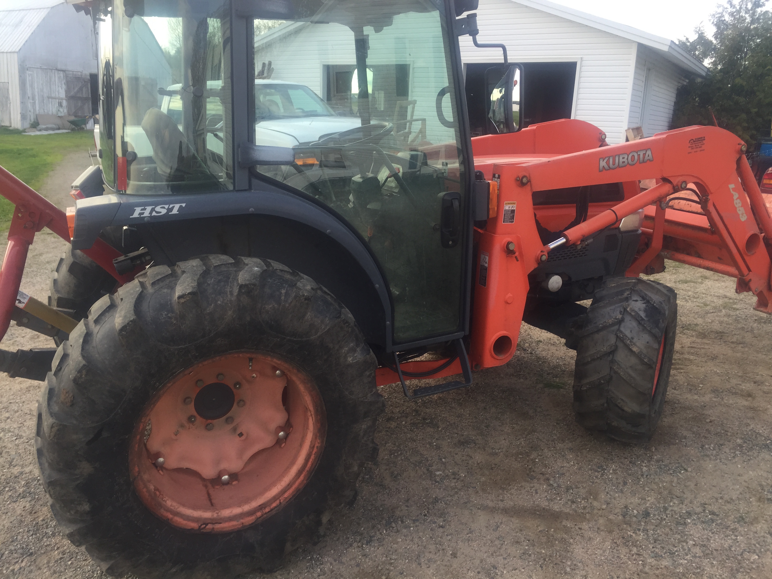

I still have my L5030HSTC, its now 13 years old with a little shy of 2500 hours on it. It wore out the 4th set of front tires so I finally tracked down a wider tire for it.
Tire - R1 31x15.50 R15 (33x12.50 R15 would also work) - These are used on trenchers and manlifts, cost about 200$ each.
Rim - L6060 ballon turf 15" rims - used with bald tires, 90$ for the pair.
Fits perfect, no rubbing on an L5030 throughout all axle positions. Much better floatation and finally no more R4 tread.
The rears have about 1000 more hours in them but I have a set of R1W's coming off my other tractor to slap on.
