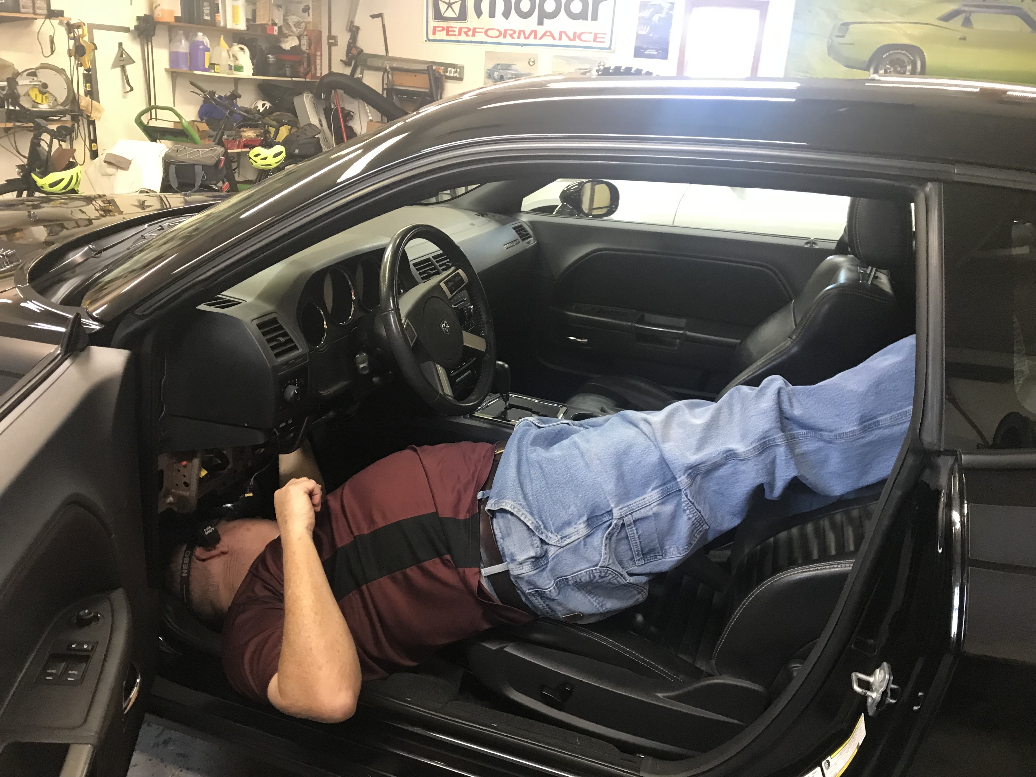

I’ve replaced blend door actuators on two different vehicles, a Dodge Challenger and a Chevy Impala. The Impala was easier, I went in through the glove box but not exaggerating when I say I spent about twenty minutes taking one bolt out and back in.
The challenger as you can see required an awkward angle.

yea do it once, you learn very quickly to simply pull the seat out. generally 4 bolts and a couple connectors.
/ Pickup HVAC Problem #7
I thought about pulling the seat but it didn’t look that easy to me. I might have been worried about the air bags too.
/ Pickup HVAC Problem #8
generally requires you to disconnect the battery, there are airbag sensors in most seats now
/ Pickup HVAC Problem #9
There’s an actual side airbag in mine in that picture. Probably not really that scary.
