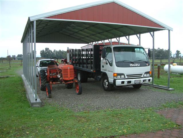

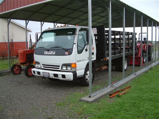

I thought about doing that on my 2001 F150, but then I found a good deal on a 2004 Isuzu NPR/EFI stakebed (8x14 ft bed, 49500 miles, 6L GMC LQ4 V-8 gasser, $11K on eBay). You're right--it's a lot easier to load than a pickup. I bought about 800 lb of seed a few weeks ago---palleted and fork-lifted by the seed guys onto the stakebed, no muss, no fuss.
Good luck.

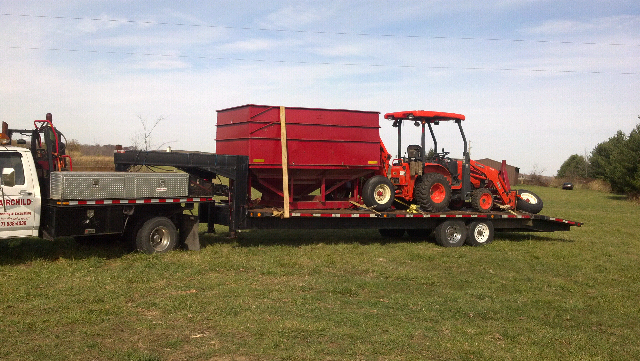

For a work truck flat bed is only way to go, but with a hoist they are priceless.
Here's a picture of one I built. There's a tread on it some were on here.

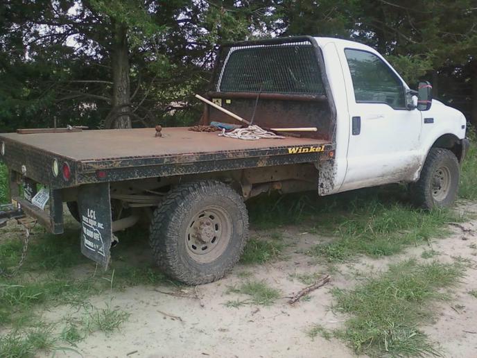

Why not? When I haul hay on a SRW its 9" over each side at least (36-40" x3 bales). As long as the cross fork notches don't fall on the bed edge.
Beaver Valley Supply Company - Winkel Flatbeds and Balebeds - The F350 srw pic is the style I'd like.
