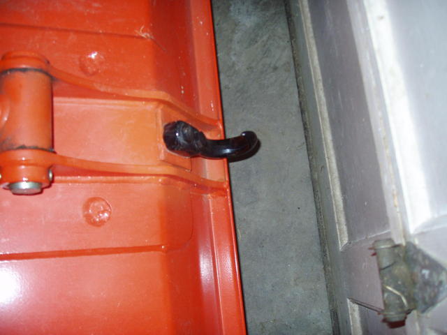

I was asked several days ago by a member if I could post some pics of my bucket hooks, so here they are.

You didnt ask me!!!! /forums/images/graemlins/mad.gif /forums/images/graemlins/smile.gif /forums/images/graemlins/smile.gif /forums/images/graemlins/smile.gif
Thats how I did my tow hooks also 'cept as close to the edge as I could and angle toward the middle more. Started with big washers and bolts and then later welded.
I had the tow hooks already plus I had an abundant supply of new seat belt webbing from work that looped over these better than iit would a grab hook.

Rat,
Very nice catch on the lock washer! I noticed it myself as soon as I took the pics several days ago, it has since been fixed. I found it under the bucket, darn things are slippery!

I had some of those on my last tractor and they were handy. Somewhere along the line, I must have side loaded them and it bent the bucket where they were mounted. Maybe it was tying off a central load to both hooks with too short of a "Y". No big deal on that old bucket but It would really show on your new one.

I used the same type of hook but added two pieces of steel plating on top and inside the bucket to distribute the forces more and not bend the bucket.

jhagerty,
Great installation, especially if welding is not an option.
I personally favor grab hooks on the outside ends, and a slip hook in the middle.
What I did was weld a piece of angle on my bucket and then weld the hooks to it. Not practical if one does not have a welder though.
The 2x2x1/4 angle on the top lip adds a lot of strength, and compliments the added strength of the tooth bar on the bottom lip.
I've attached a photo to show what I am referring to. I know I could have stitch welded the angle, but I needed welding practice and it beat welding on scrap for no purpose... /forums/images/graemlins/blush.gif
PS...this was on my B2910 bucket...but it would work the same on any bucket size...don't have a loader on my BX. /forums/images/graemlins/blush.gif

Thanks Henro,
I’m really interested in learning how to weld and then picking up the equipment. It’s no doubt the best way to go. I just need to find the time
Your set-up looks great! I may also add something in the middle as well.
I definitely see the possibility of bending or distorting the bucket when using hooks so I intend to be very careful, not to mention the tipping factor if you go to heavy.
