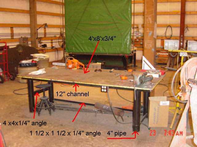

on welding tables anybody got any pix & measurements. also got some xpanded metal to weld on the back of my grapple to keep debris from falling thru. i`ll weld a piece of the back of the hood guard on the tractor .

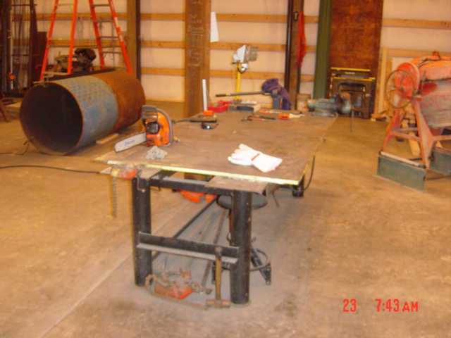

Excuse my shop, it's generally not such a mess!:eek: At the time of this picture, (quite a few years ago) I had a few projects going at the same time.

A welding table is nothing more than a wooden table that you would build with plywood top, 2x4 frame and legs. You just substitute steel plate for the plywood and angle iron for the 2x4 frame. Legs are your choice, pipe or what ever you have available. Sheild arc's pictue of what looks to be an 8'x4' table is typical but depending on your shop size can be cut down to about any size you want. You need room for a vice on one corner. I like to put a shelf underneath (this can be angle iron frame with 3/4" plywood decking) to store the miscellaneous tools so they are out of the way but close at hand. There are all kinds of customizing that can be done after you get the basic rectangular table made. You can add angle iron in the shape of V on one side to lay pipe and steel in when fabricating, put electrical receptacles under neath so your dont have to have extension cords running every where, since you alway need at least 2 or 3 power driven tools to do any welding activity, that would be 2 grinders-one with brush other with blade and a drill motor, maybe a chop saw, band saw, jig saw etc. Then where your underneath shelf comes in is keeping squares, level, maybe some socket sets for disassembly work prior to welding, channel lock pliers, vice grips, pry bars and of course the trusty shop hammer for adjusting the fit up a bit, chipping hammer or needle gun for cleaning the slag, dont forget the faceshield for grinding, safety glasses, welding hood, cutting googles and marking pens or soapstone. This is usually what I end up having out for a simple repair before I am thru.
