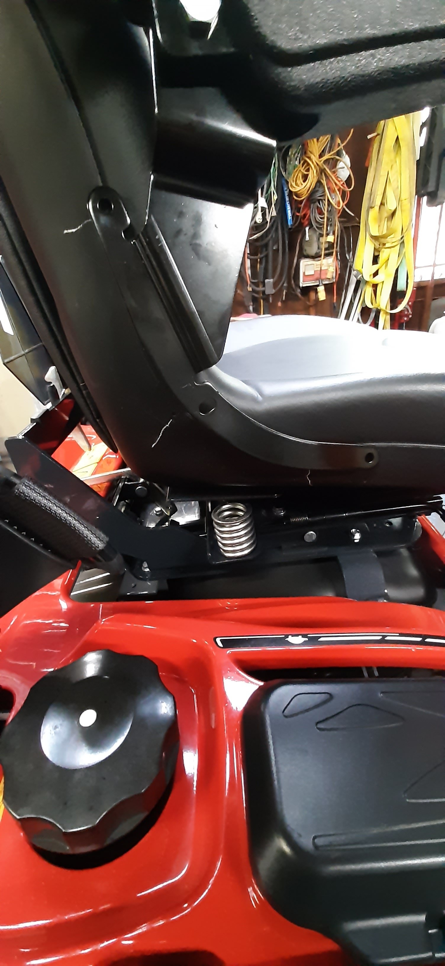

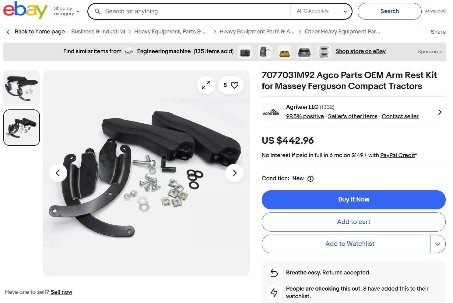

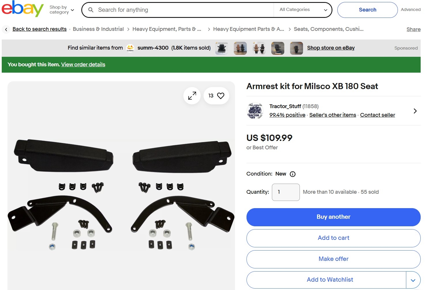

Looks like everyone has exhausted trying to find the exact arm rests cheaper than the AGCO price. I just received the Milsco XB-180 arm rests today and they are very close and will give it a go with slight mods. Rubber is also soft and not hard plastic.

Just for the record concerning the arm rests, no information that I can find for brand of seat.
If you are looking to order the factory Arm Rest Kit - AGCO Part Number 7077031M92
You can try this seller from Ebay - 7077031M92 Agco Parts OEM Arm Rest Kit for Massey Ferguson Compact Tractors
If you order the ones for Milsco XB-180 from Ebay - Armrest kit for Milsco XB 180 Seat
What you will receive is Uni Pro Armrest Kit 7947 as shipped from Great Nothern Equipment per the packing slip, made by K&M Manufacturing - KM 123/125/128/132/133 Armrest Kit
WITH Instructions included for Milsco XB-180 :rolleyes::D:ROFLMAO::LOL:

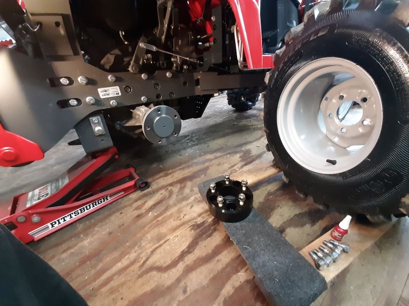

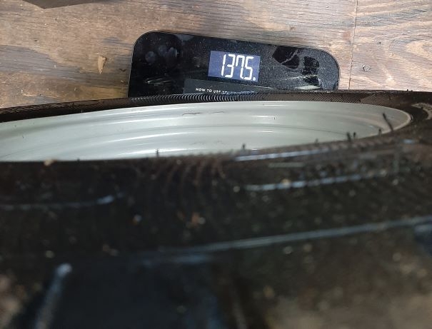

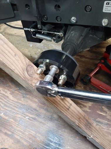

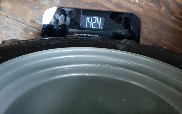

Wheel spacers installed, 2" from Bro-tek. Will require non-impact 22mm socket which is the largest one I had. Tires are filled from the dealer, I weighed each one for reference. Wonder what the empty weight of the wheel and tire are ........

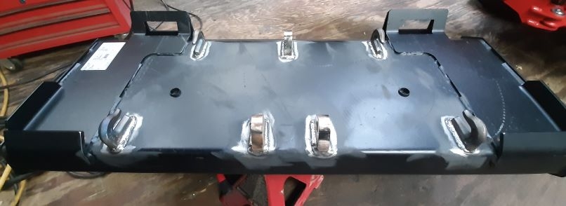

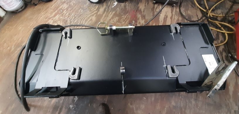

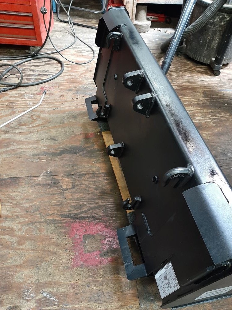

Bucket hooks and clevis tabs welded. Goal here was to be one and done to cover all the options. Future pin on hitch planned for the center. Will modify as needed, black buckets are friendly for this.........

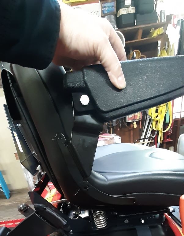

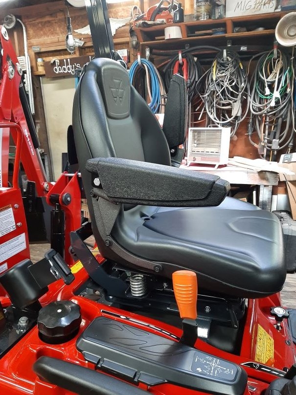

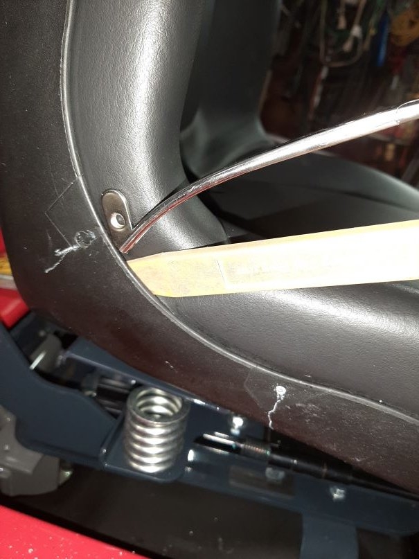

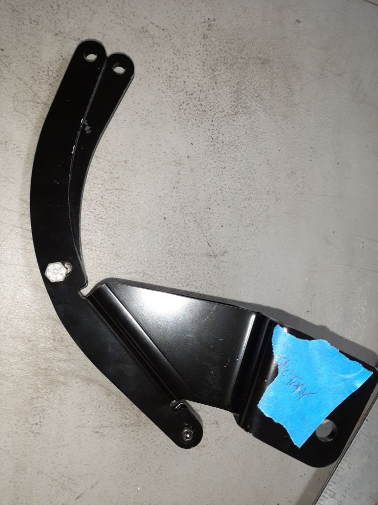

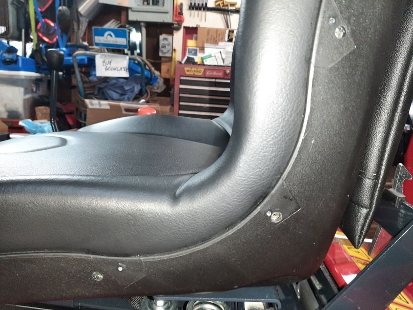

Arm rests were a PITA to install, but worth the effort and money. Had to adjust brackets in vise and tried not to scratch. Needed to test out a paint color anyway for future project, oh well. BTW this seat sucks as compared to others. Maybe next year something better. No way to live without arm rests on this tractor.

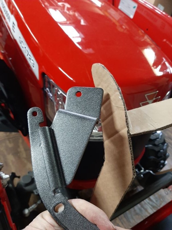

Retail Rems Sentinel Guard installed. Well designed and easy install. I loose fit all the parts and was able to hang it that way. Only thing I hate is the factory bracket is heavier maybe 12 ga. and the Sentinel U shaped bracket is 14 ga. I added 2 tie wraps 125# rating through the 2 front holes around the stationary shaft.
