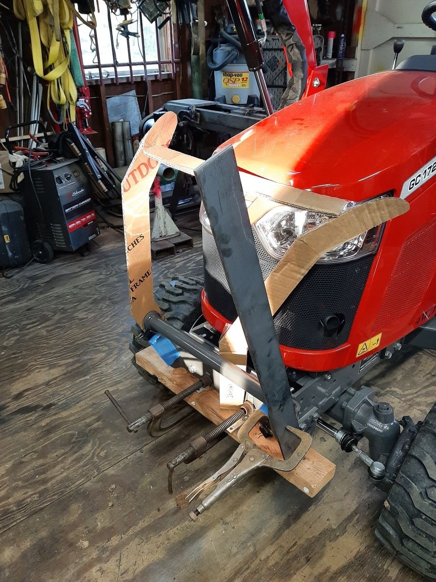

I would be happy to pay a fair price - Not cheap can mean anything though:)

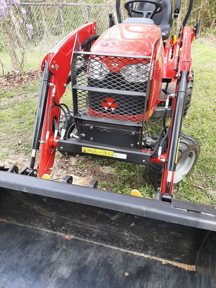

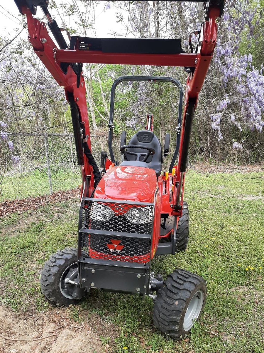

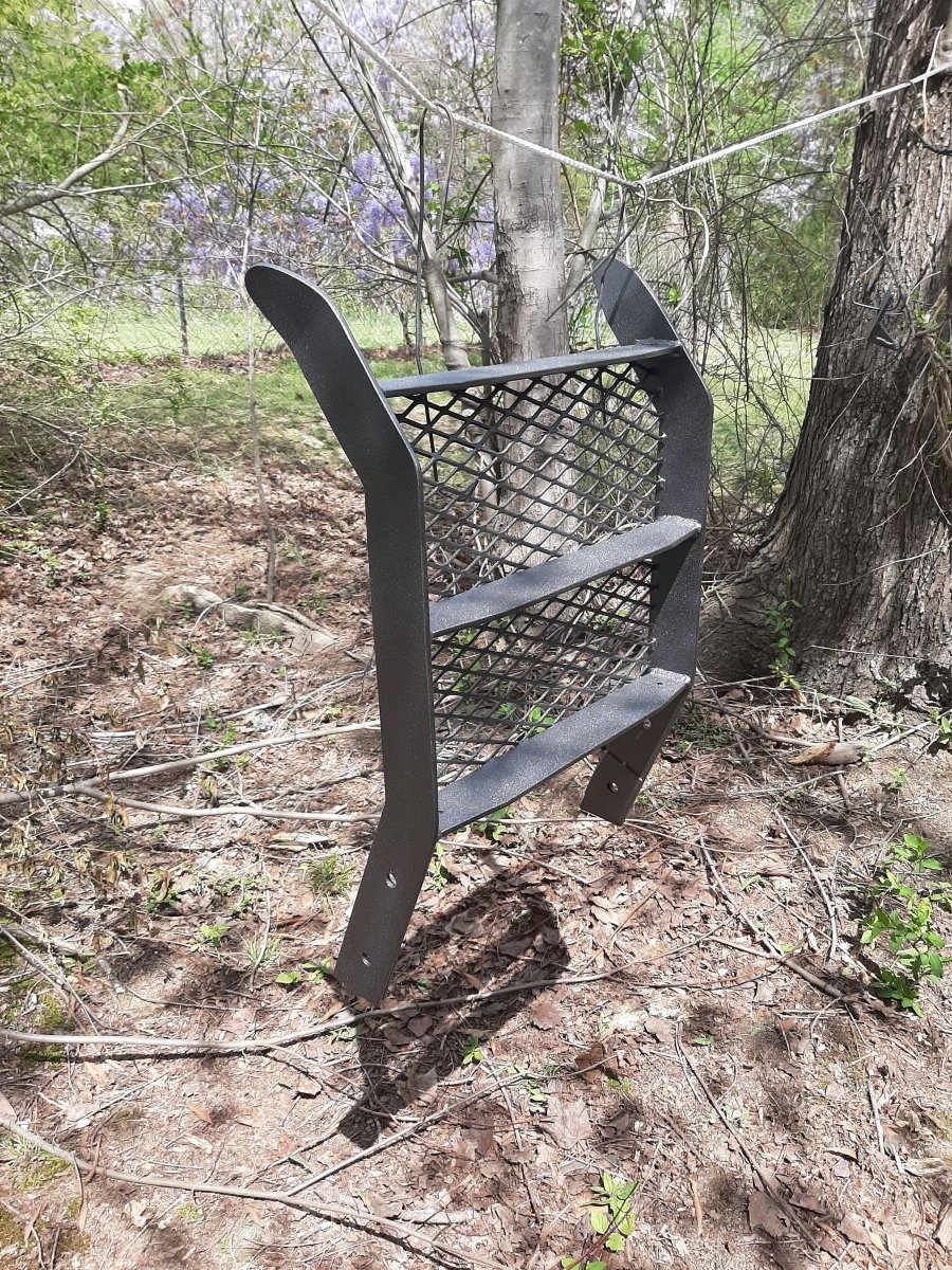

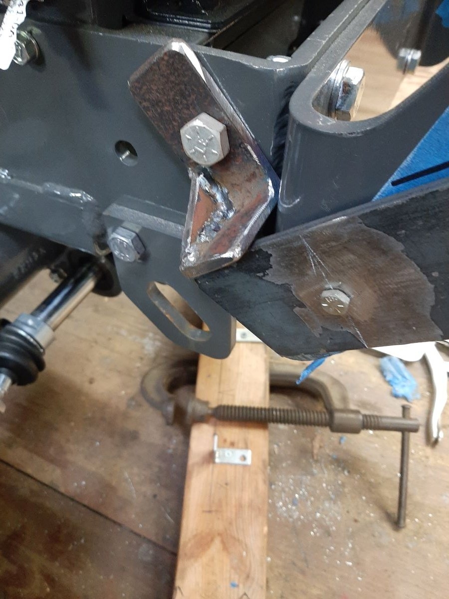

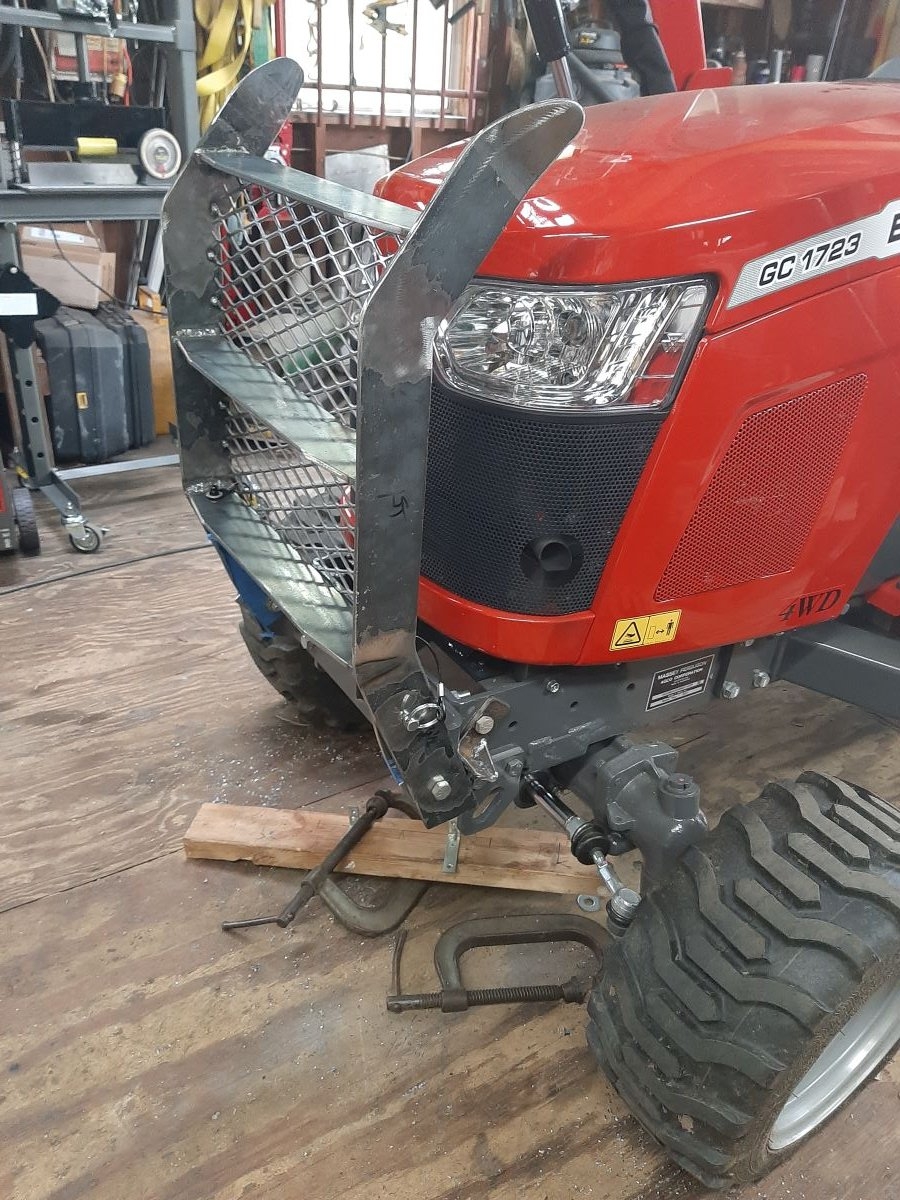

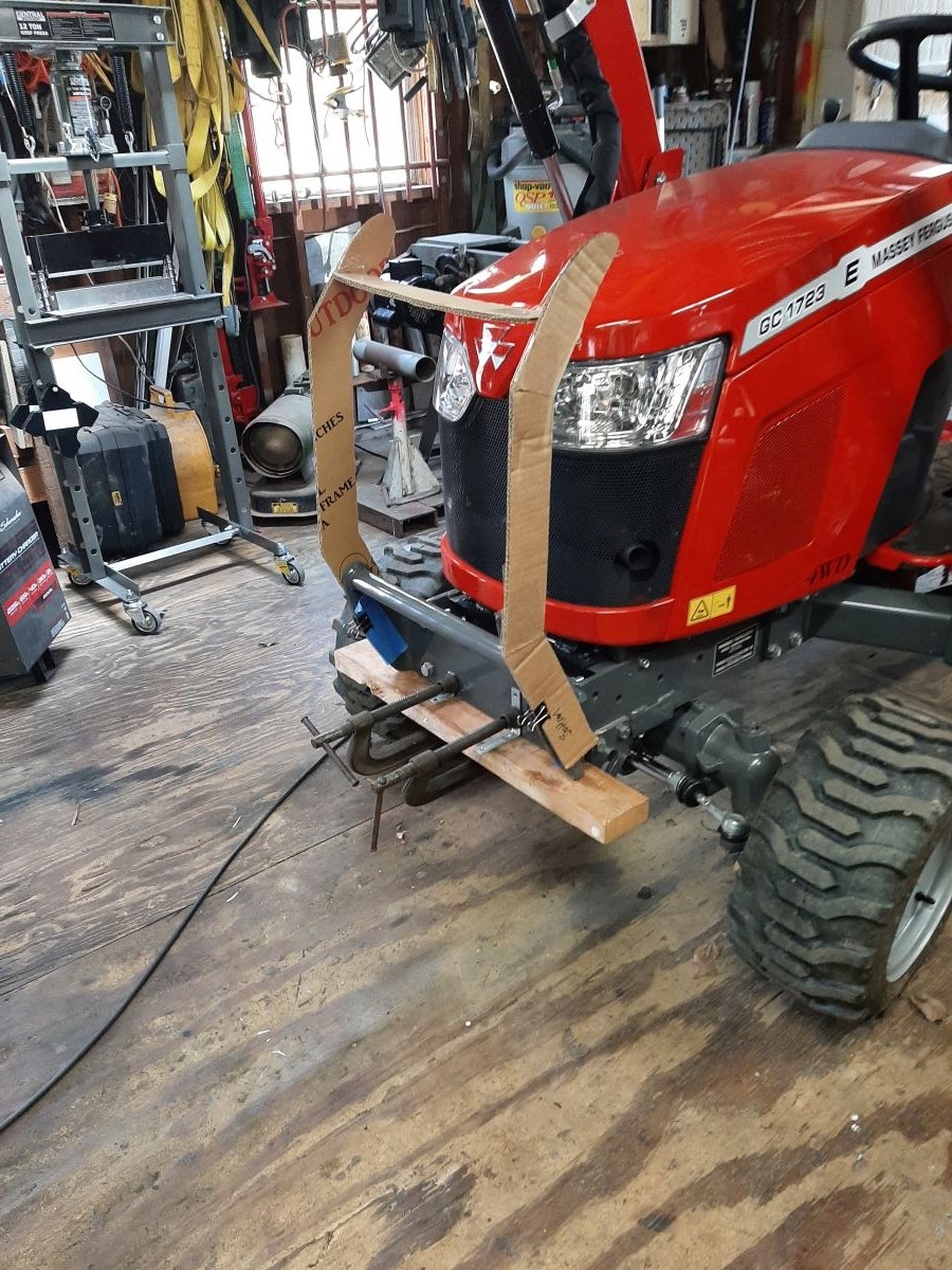

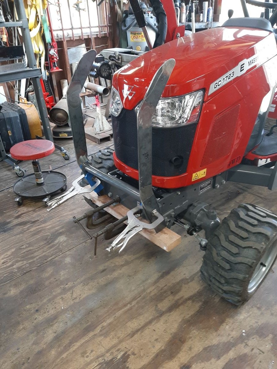

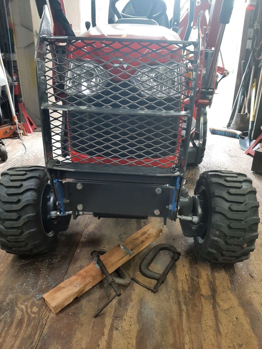

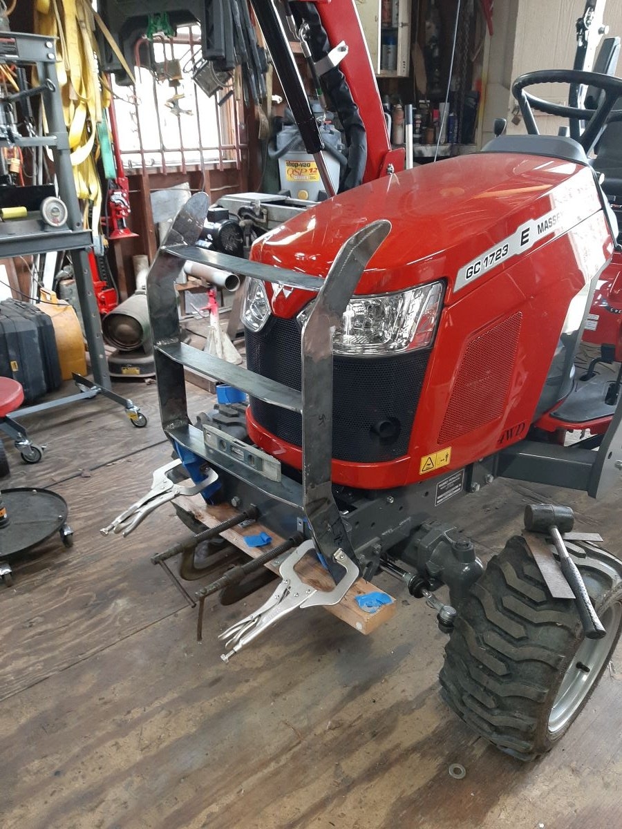

Let's hold that thought for now about the brush guards 😁, but yes it will be a future endeavor. Boating and vacation season is kicking in.
