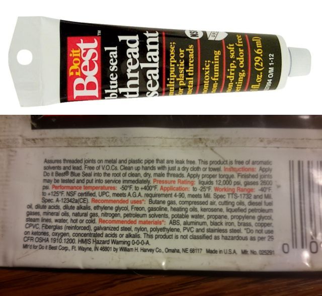

Hate PTFE tape, it commonly referred to as a sealant but its actually a thread lubricant designed to allow you to put more turns on fitting to tighten it to cause better thread interference (seal)...
Have better luck with most every type of threaded connection using product below be it plastic, brass or steel...
D.

I hate NPT for hydraulics too but it's on a lot of fittings. Loctite 545 is made for sealing threads on hydraulic connections. It works much better for me than the Permatex goop for hydraulic threads. It's an actual sealant not just thread lubrication. With it I don't have to torque the fittings down quite as hard.
