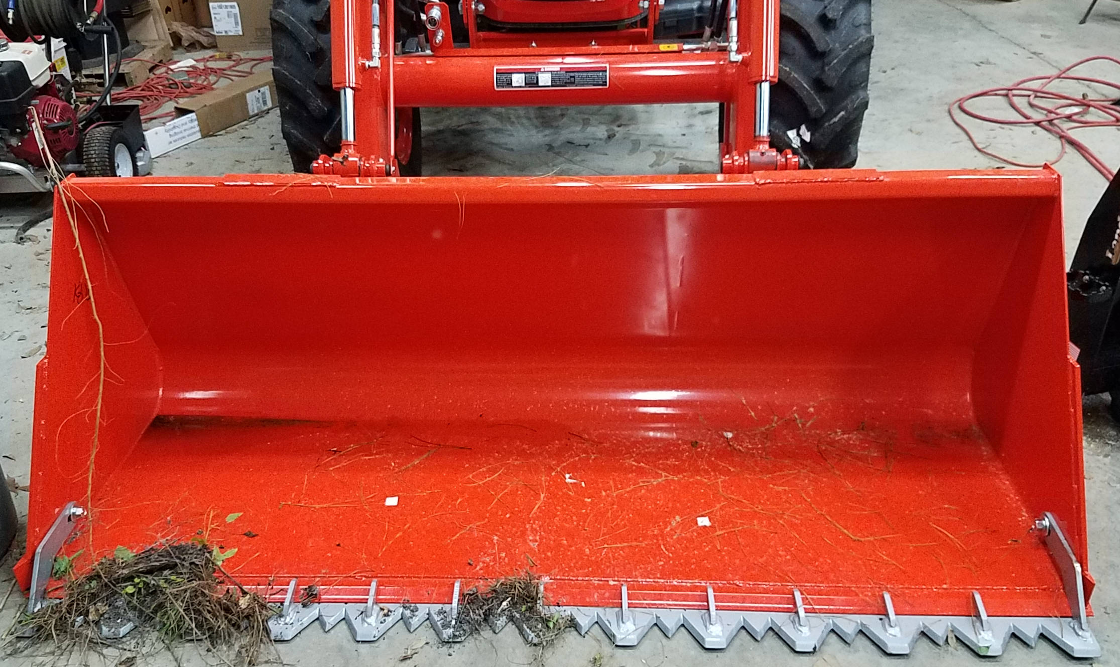

So today I put my piranha bar on my 84" bucket and went out and found a 4.5" 5" diameter pine tree. Put bucket on float with heel on the ground and bar up an inch, backed up about 2 feet then rolled forward into the tree with some momentum. Raised and curled and popped that pine out root and all. The bar caught it in the W shaped tooth and cut half way through.
Thank you all for talking into the piranha bar

I want to clear area I let get over grown and its covered with small pine but are too big to be brushogged. This way I can pull them or cut them with the piranha and clean them out with grapple. Grapple will get tested next week, will try find one about the same size.

My Piranha bar is a one off weld-on with a well used commercial long bottom bucket. M59 TL. Aggressively Wrestling a 36” oak stump (8-10’ root ball) managed bend the outside corners. The sides were worn back about 2”. Should have and will extend the side cutting edges. I don’t feel it was Piranha bar problem but my install.
