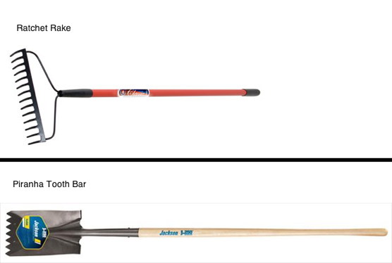

OK, a lot not everyone☺! Dont plan to dig with either. Primary use will be brush clearing as shown in picks.
Not trying to be argumentative but what's the ratchet take advantage?
   / Piranha Bar #12
The Piranha is for digging. Only. It tears out brush by digging it up. You use it going forward, I own a Piranha, but I don't have your kind of growth.
The ratchet rake is for raking. You use it mostly in reverse. It tears out brush without digging. It is a much neater solution for your type of brush. I do not own a ratchet rake.
It is POSSIBLE to remove a Piranha, but I sure wouldn't want to be the one doing it. I consider its installation permanent.
   / Piranha Bar #13
It's easy to unbolt the Piranha. Mine needs a couple light taps from a hammer to get free of the bucket. The biggest issues with removing it are that it's heavy and has sharp edges, and you have to find a safe place to put it. I take it off when I'm loading material that's on pavement.
I used mine to rip out some brush. It works on smaller diameter stuff. The edges are sharp enough to cut stems, and the points can grab them so you can pull them out of the ground. It's not all that good at gathering up material. A grapple works better for my brush, where there's a lot of material that's larger than the Piranha can handle. A lot of my brush requires a chain saw.
A trick for brush hogging where there might be rocks is to go forwards and run the loader really low so it'll find the rocks before the brush hog does.
   / Piranha Bar #14
I have a Piranha Bar and it definitely tears out brush and saplings by catching them on the teeth and ripping them out by the roots. I have similar undergrowth to yours. Might depend on how much power your tractor has, too. Will be doing a little more of that. Also slices through my clay soil like butter. I sometimes want to remove the sod before working an area, and it would clearly do that too. Very multi-purpose implement for my needs. Also agree, very easy to install/uninstall. Two bolts. I even did the installation myself.
I have decided not to go for a grapple *at this point* (though they do look very useful!). I can clear my trail with the Piranha bar then use the pallet forks to haul everything to the burn pile.
To clarify: I have much more need for digging/leveling than for brush clearing (I like to leave brush wherever I can). That's why the PB suits me.
   / Piranha Bar #15
TomIre, based on your stated uses I would get a RR. I have the Piranha and have to agree with Jeff. The RR is for brush clearing and the tooth bar is best suited to digging. The Piranha will happily dig out brush but it is rough method of doing what the RR is designed to do.
I will be getting the RR in addition to the Piranha as they both have there purpose.

This is all really helpful and I very much appreciate everyone's input. I'm thinking now that that are different tools. Like any tool you can use it different ways. Seems to be some overlap between the capabilities of the two. Started out thinking piranha but leaning towards RE now. Maybe I should get both too! Also see why the RR should last as it is designed, I think, to sort of back drag the brush so the strap doesn't get the stress i thought.
Thanks again, I'll head back to YouTube and keep reading here. Maybe I'll have a eureka moment! Probably either took would work just used differently.

Wanted to thank everyone for their posts and input. The penny finally dropped for me yesterday while watching some RR videos on YouTube! Ordered a RR today. I think it will do exactly what I want.
