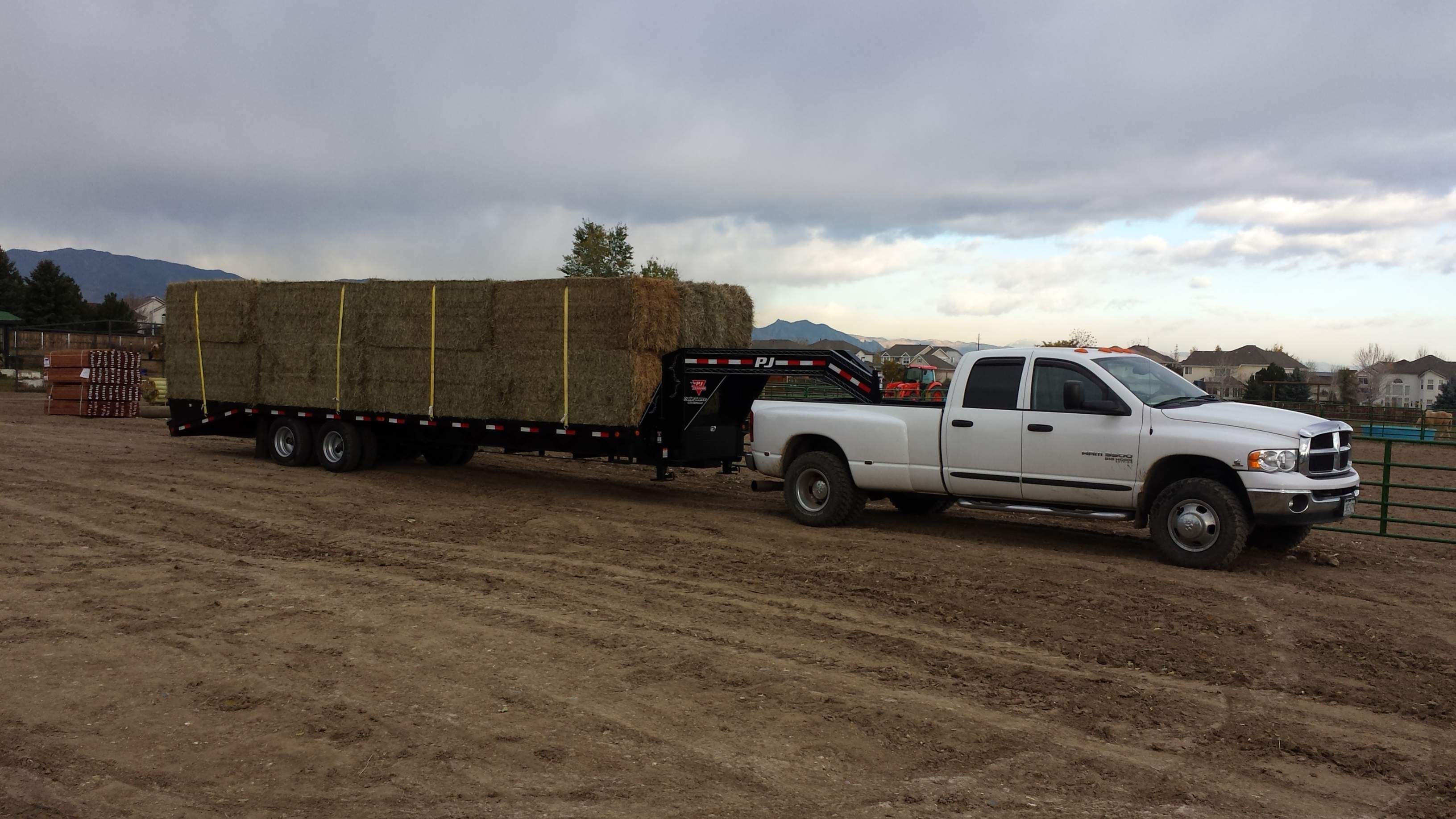

After strong debate over buying a $25-$30k flatbed class 8 straight truck with tandem 20k duals which would allow me to haul 10ton on the truck and get a trailer later for a combined 20ton load, I ended up buying the 25k PJ with tandem 12k axles. I'll be selling my current dually for a 2014 ram 3500 37,500lb GCWR! With this setup I can LEGALLY haul 10tons of hay per trip with 5 year/100k warranty on truck and 2 year warranty on trailer. Navigation, heated seats and all the luxury new trucks offer. I strongly recommend anyone heavy hauling to test drive the new 3500 with Aisin 6spd trans and integrated engine brake control. These trucks are seriously impressive and 100% built to haul. They REALLY got it right this time. (I'm a ford guy too) The Aisin transmission is designed to work with 40% more torque than the 850ft/lbs the new cummins puts out. Just very impressive setup all around.
Anyway, here's a pic of the first haul with the PJ. New truck to come soon. :)
   / PJ 25k Trailers.... No Dexter axles?? #19
Nice setup!
How much for the truck? :laughing:
Just kidding, I don't have the money anyway.
   / PJ 25k Trailers.... No Dexter axles?? #20
beautiful trailer, my next one is going to be a PJ with a hydraulic tail. You can go atleast another row higher on that trailer to truckin! :D
You should have held out for another year though. Ram is coming out with an air ride rear suspenion in the HD trucks.
