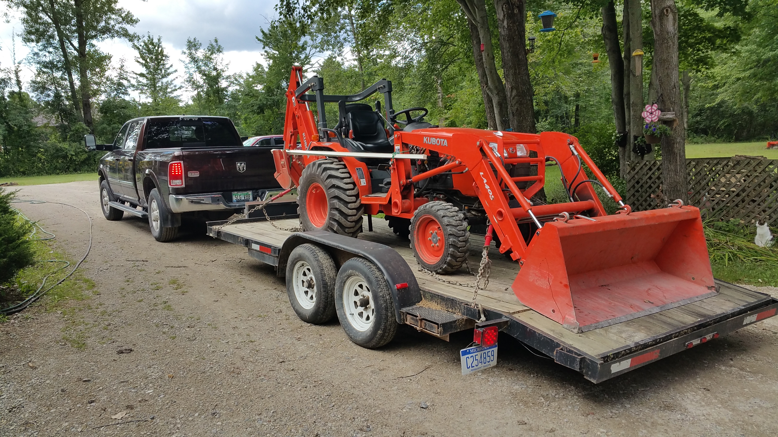

I know that I may be a freak in this respect, but I have a 25' long 9,990 titled gross (2 x 6K lb axles) flatbed and would not want to go shorter. Actually, if I were replacing mine I would go to 30' long and stay at the 9,990 titled gross. I've never ran into a time that I thought to myself... "I just cant haul this load because my trailer is simply to long." But I tried to get 2 Wrangler JK 2 doors on it to haul to Colorado and found that it is just not long enough. I can not get 2 demo derby cars on it until after they are smashed. Going to do driveway jobs with the Kubota with the backhoe, loader, box and rear grader blade it is a REALLY tight fit! 5 more feet would be nice.
My truck is a 2017 Ram 1500 Hemi with the Max Tow package that has the 3.92 gears, bigger trans cooler, engine oil cooler, integrated trailer brake control and class 5 hitch. It is rated for 9,460 lbs. max trailer weight. I do run a 14,000 max weight distribution hitch to push the weight to the front wheels as well.
