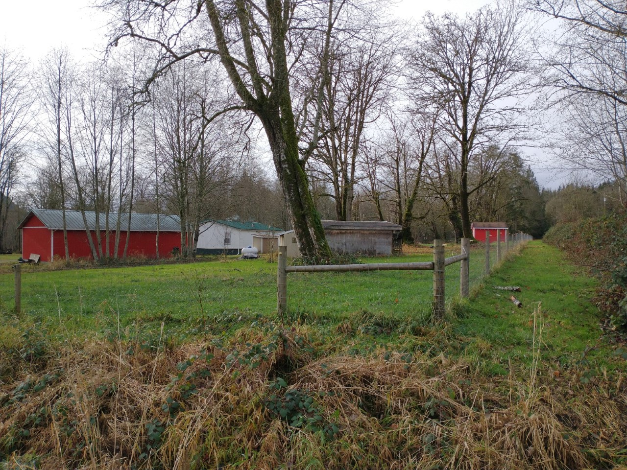

Tired of maintaining part of my fence line by hand (yes, when I put in the fence I was aware that it would be difficult- it was the best [only?] real routing that I could use that wouldn't cause issues elsewhere). Am wanting to, at least, be able to get my riding lawn mower down along the fence line in the foreground (the other fence line is readily maintained using either my B7800 or NX5510).
Problem to solve: I need to figure out how much area to build out from a fence corner that is bound on its sides by ditches. I have finally come to the conclusion that I'll be looking to do a deck and pier approach (vs. trying to build out a berm [one ditch belongs to the county, in which case I have to watch how elaborate I look to get): I don't think that I could trust a berm setup to last. The point of constructing such a path is to allow me to get, at least, my lawn mower around the fence corner, if not also my B7800.
Picture taken from the county road (county ditch in foreground, though not highly visible due to growth). I have a bit more width up along the upper fence line, where the blackberries are along another ditch. In that corner where the ditches come together and straight out from the fence corner the ground slopes down. I might have 5'(?) of navigable flat area along the county ditch (it then widens up a bit).
My riding mower's wheelbase is 48", width is 48 1/2" to 56 1/2" (wider for foldable shoot); spec'd as having a turning radius of 16".
My Kuboa B7800's wheelbase is 65.6", width is 53.8"; spec'd as having a turning radius of 6.9'.
I'm _guessing_ that with my riding lawn mower that I could get by with a path build-out for it's wheelbase/width, which are both about 48" (16" turning radius is essentially moot given it's so tight). Due to the slope on the ditch shoulders I still have to build out in order to level the travel path. The B7800 would take a lot more, but how much?

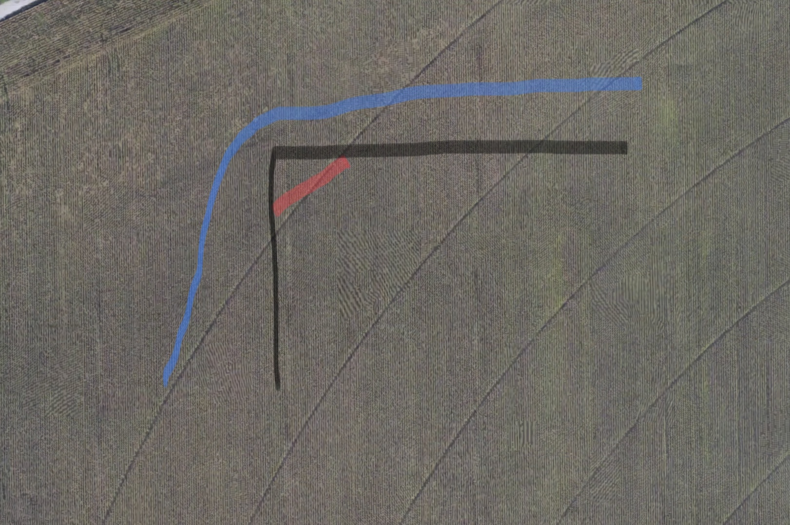

I'm guessing it looks like this with the blue being the ditch and the black being the fence.
You can't make the outside corner between the ditch and the corner of the fence.
So cut the corner by moving the fence to the red line. Why do a bunch of earth work when you can just move the fence?
   / Planning on a travel path
#11
Yeah, yeah, OK... Gotcha.😃 Coupled with the notion of putting in a gate as cqaigy2 suggested (put across the space/line you have in red) might be a worthwhile solution to consider. I'll try looking at how I could make this work, if it could be made to: if I can retain my H-braces as end posts and put in new H-braces then that'll reduce holes to only two [note: I've got my posts set almost 4' in the ground - I used a skidsteer with an augur to do them- more to consider, though I'd still have had to figure out how I was going to drill the holes for the piers, so this might end up being easier in that regard]).

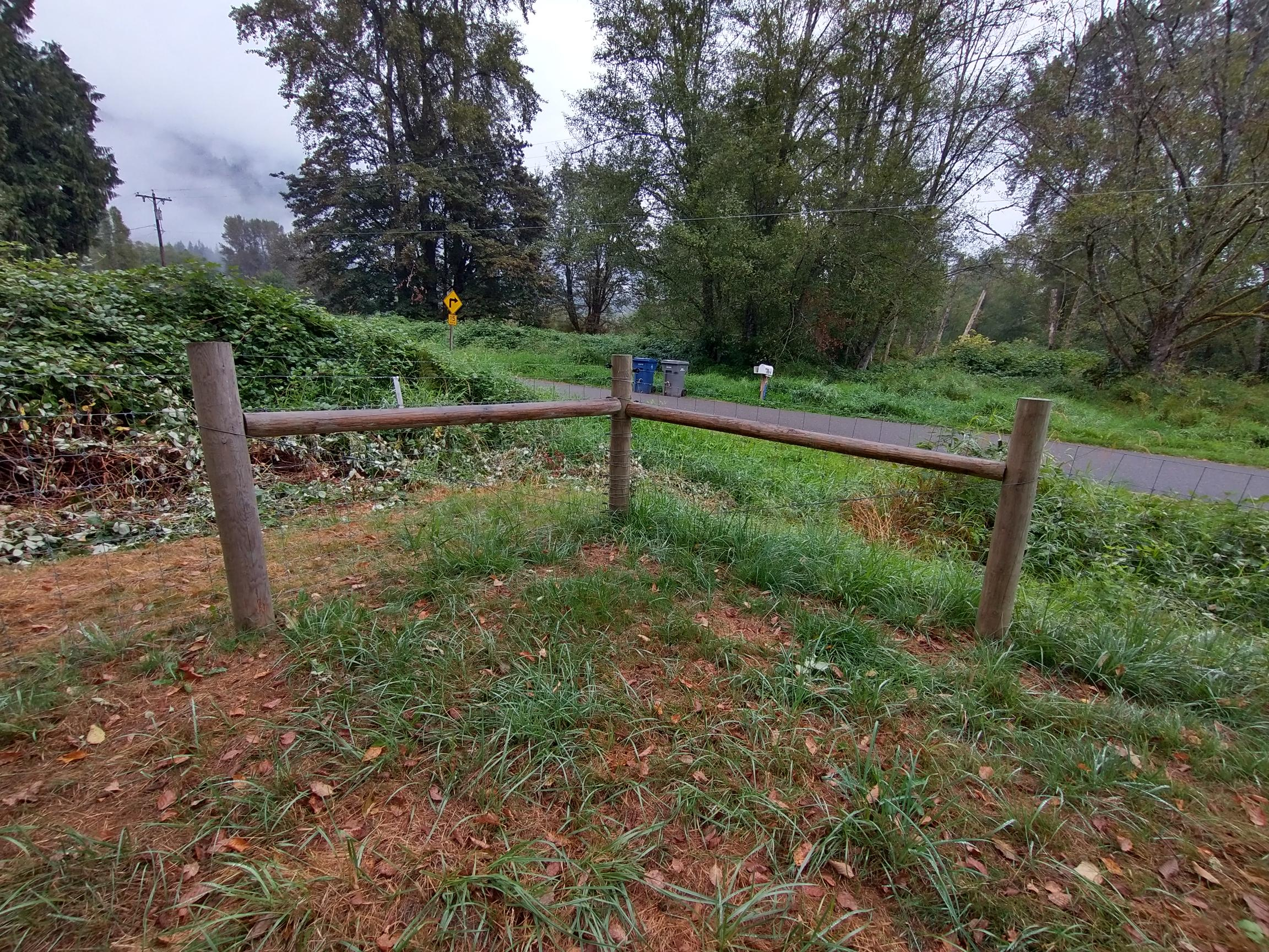

For what it's worth, here's a picture from the inside of the fence. A bit better portrayal of the situation. I'd measured the distance between the H-braces and I've got roughly 12', which is a good size for an opening. Also did a quick measure of how much lateral room along the outside that I have and it's about 5': this widens up a little bit further down, in which case it's really about navigating this small area (again, I _might_ have to do a slight shoring up but it isn't likely going to be much or very difficult). Appears that I have a shot at being able to get my B7800 out here; it'll be a squeeze and there's no place to turn around further down- BUT, even going really slowly and backing it'll still be far more quick than doing this by hand!
Here's what lies further on down (dead end!):
