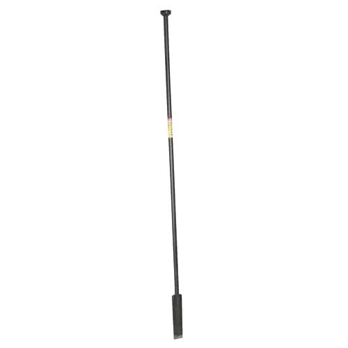

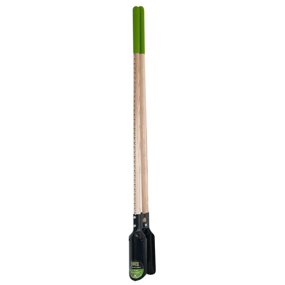

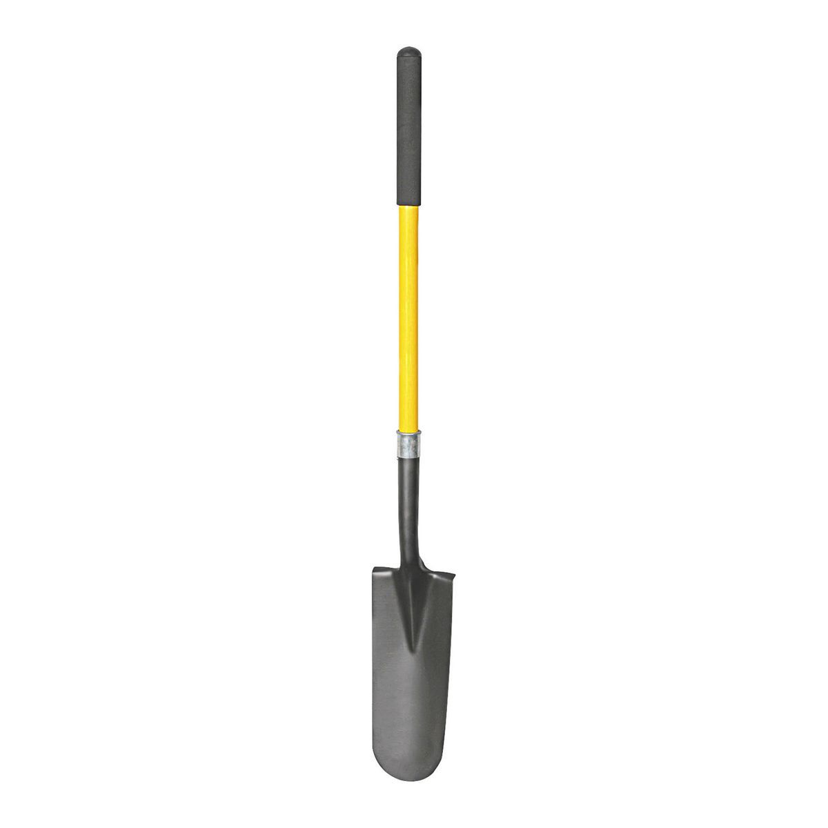

I’m talking about a hand operated post hole digger like this, a long handled shovel, and a digging bar like this if I hit a rock. Those are small holes and they don’t have to be 2’ deep. You generally want to make a hole twice the size of a container in diameter, and not much deeper. Tip the plant out of the container, and put it in the hole. Maybe add some loosened soil under it to bring the plant up to the same height it was in the container, score up the roots if it’s root bound, add soil around it, pack it in and water. Maybe mix in some balance fertilizer to the soil that you backfill with before packing it down. Make a little dirt moat around the outer edge of the hole to hold water and off you go.
0B1C9F49-08A1-4855-A1A8-E22D49F7650D.jpeg 3D77FDA6-DC47-4847-8CB6-7525BAC3E0A2.jpeg

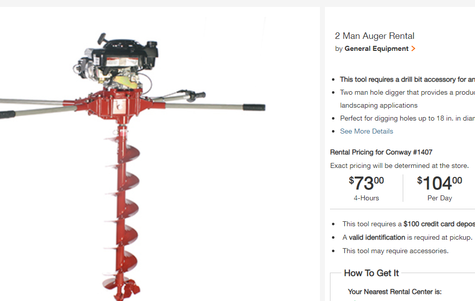

If you have someone that can help you the 2 man augers are really good. This one is at Home Depot by me. I assume you would have one nearby as well. It will deal with rocks and roots pretty well. If you hit something too big just move a foot or so and try again, if it can't move a foot skip it and come back with a rock bar and manual post hole diggers for that hole.

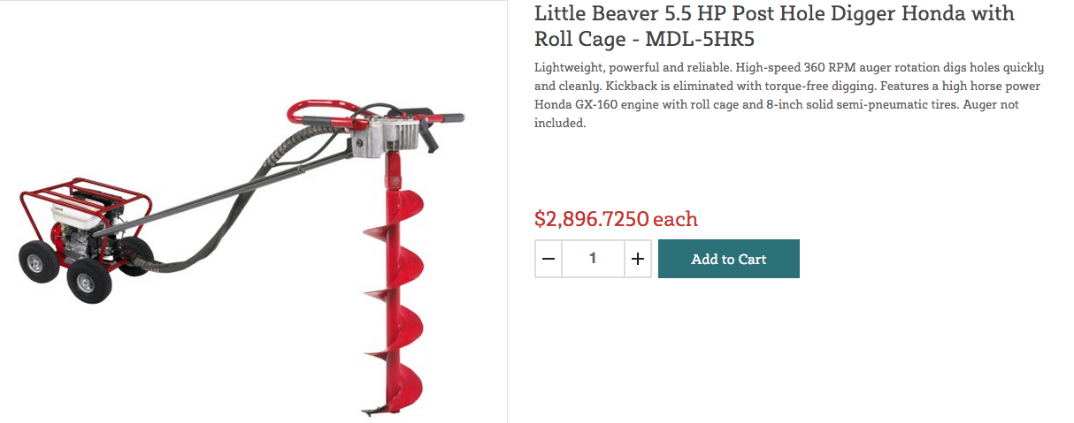

They also have these. I have not personally used one but I have heard they work well also.

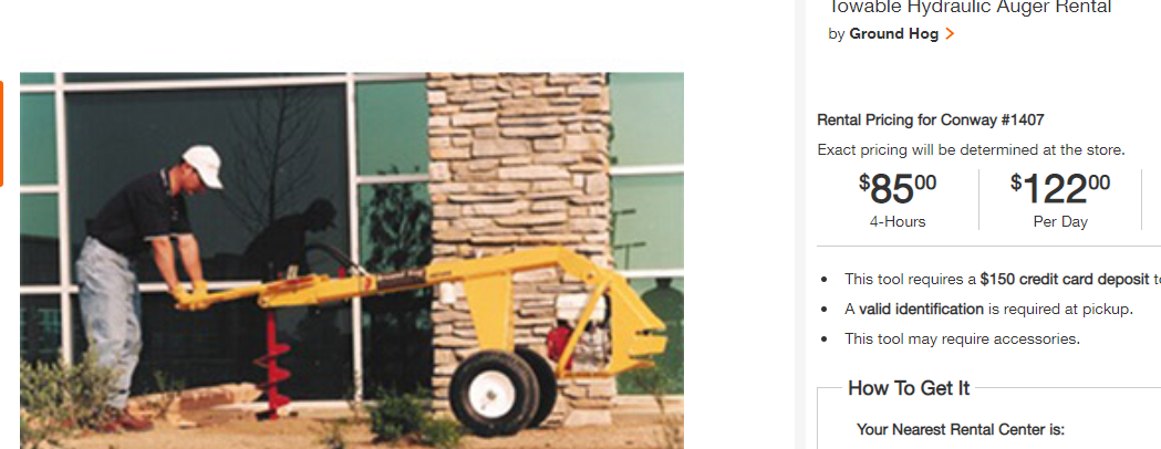

Here is another option similar but different than Ground Hog. Find a place that rents the below.

I could use the workout but 50 holes in half a day? These holes would be bigger than I first thought. Still. That's a ton of work but I'm up for it.
