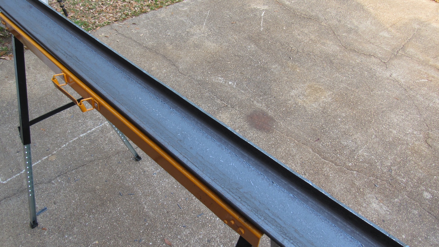

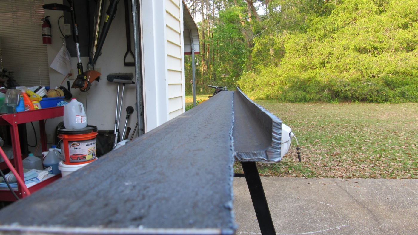

I bought a Colossal Tech Cut 50F with pilot arc off eBay that I am pleased with. It is 240V only. I didn't have a 240V outlet handy so I run it off my 10KW diesel generator. At full power it draws 26 amps and the output reads 54 amps. Don't have a bunch of time with it yet but what I've done seems it will do what I need. Only cut up to 1/4" so far. All my cutting has been 3/16" to 1/4" stuff. I set the amps to full and the air pressure to around 60 psi. Only had to change the tip consumables one time.
This was my first long cut on a 1/4" angle I cut one leg off of. The slag chipped right off with a hammer.
