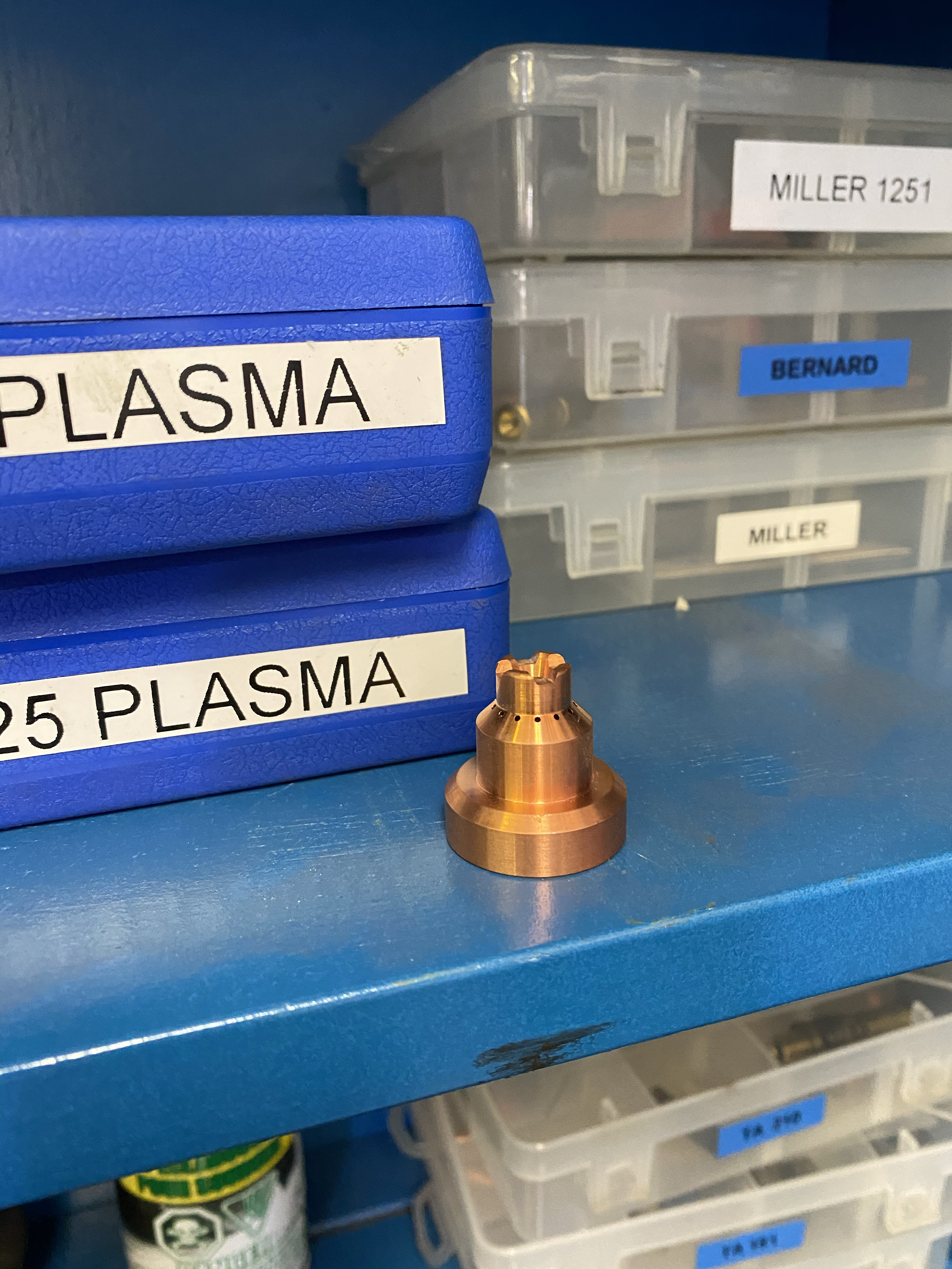

From reading a lot of older posts, I see where the Hyper Therm allows "Drag Cutting".
Does this mean you can drag the electrode on the workpiece instead of having to maintain a certain gap? Do other machines not allow that? Does it eat up consumables faster if you drag it on the workpiece?
You can drag cut with hypertherm, it's actually the shield that contacts the work peice, doesn't effect the nozzle. The biggest killers for consumables is piercing and blowback from traveling too fast.
Yes, they make drag cutting tips. That's pretty much all I do is drag cut against a straight edge or freehand for shapes.
On the Miller, the drag tip is essentially a standoff that helps maintain a correct electrode distance from the workpiece.
/ Plasma Cutter recommendations. #33
Miller drag shield
Left to right: Miller 100 amp drag shield, 40 amp drag shield, 40 amp gouge shield, 40 amp tip.

I love my Hypertherm Powermax 45. Little experience with other brands, but my HT cuts through pretty much anything that conducts electricity. I don't even grind paint or millscale off, I make a clean spot for the ground and cut away.
Edit: there is no standoff required or drag shield for the Hypertherm. The screw on end (forget what they call it ) can be dragged right across whatever you're cutting.
Huh? I bought Hypertherm drag shields for my 45.
/ Plasma Cutter recommendations. #37
I’m pretty certain you are both correct. Hypertherm calls it a shielded consumable. Creative marketing at play.....
/ Plasma Cutter recommendations. #38
Yes, my 45XP came with a drag tip. Don't know the formal name for it.
/ Plasma Cutter recommendations. #40
It's just a sheild/deflector for drag-cutting, there are about 7+ different types of shields for the current Hypertherm air plasma's depending on application, not including the different amp rating shields for some styles.
