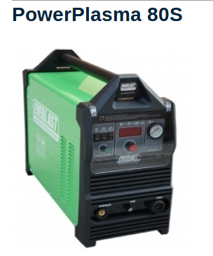

Looks like the Cut 70 has been discontinued, they now offer an 80 amp machine also I mistakingly said the machine had HF when in fact it is called ( Pilot Arc ). I sold my plasma cutter but will be soon buying this new model.
Cutting heavy scrap with plenty of amperage I would get about two hours from a consumable, cutting light metal 1/4" to 1/2" about 4 hours, the nice thing is that the consumables are inexpensive if you purchase off of fleabay by the 100 lot.
Here is the new machine in Cdn dollars, PowerPlasma 80S PowerPlasma 8S Plasma Cutters | Everlast Welders
