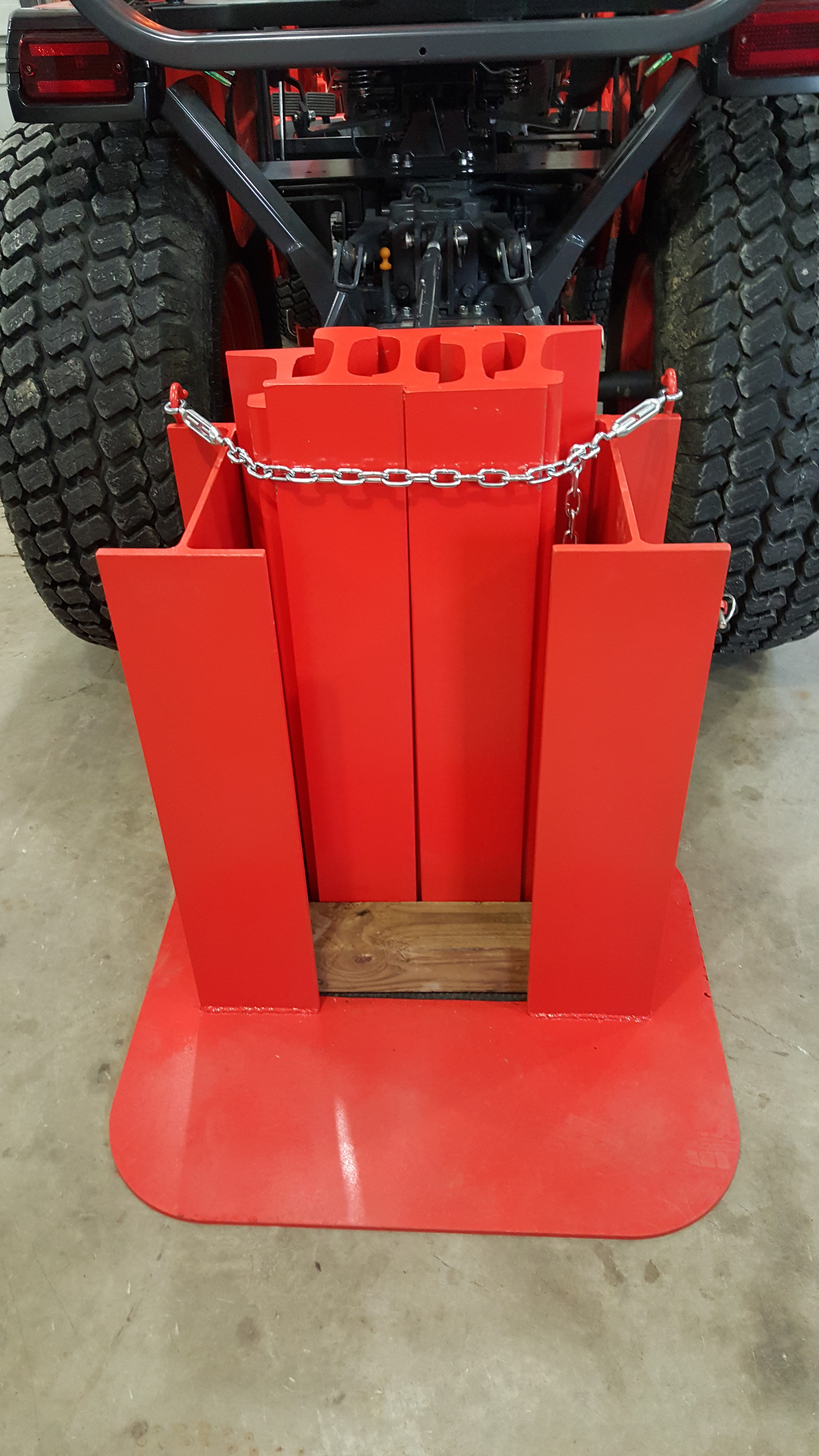

Congrats again on your new tractor Milo. You will love it. Mine has been a workhorse and performed flawlessly. One thing I can save you some time on is that I designed an adjustable ballast box, and did alot of experimenting with weight, that to do max loader or grapple work, you need 600-700 lbs of ballast to keep it planted good. This is without loading the rear tires, as I mow my yard with mine also, and didnt want the extra weight in the spring mowing season. Enjoy your new tractor!!

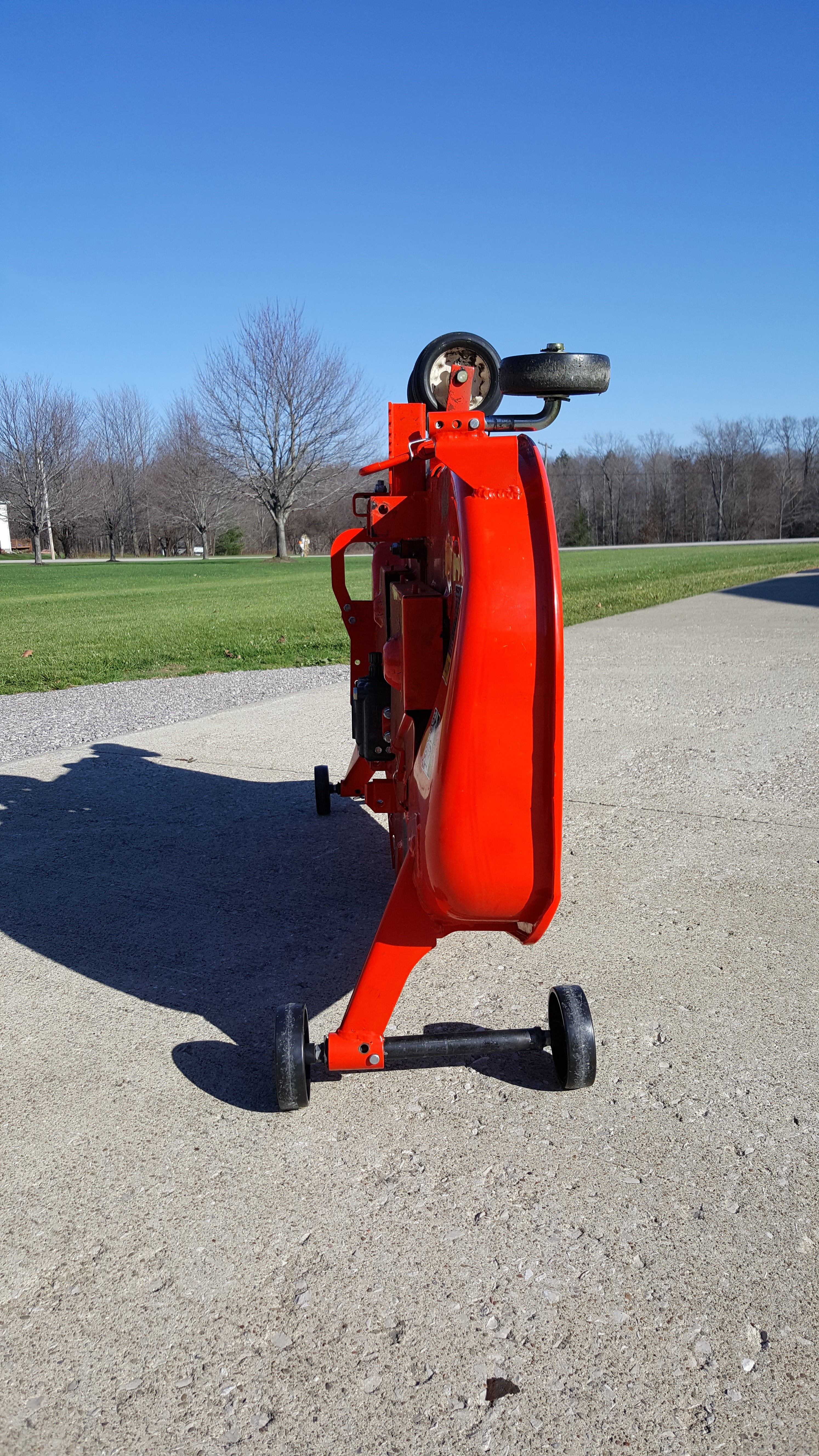

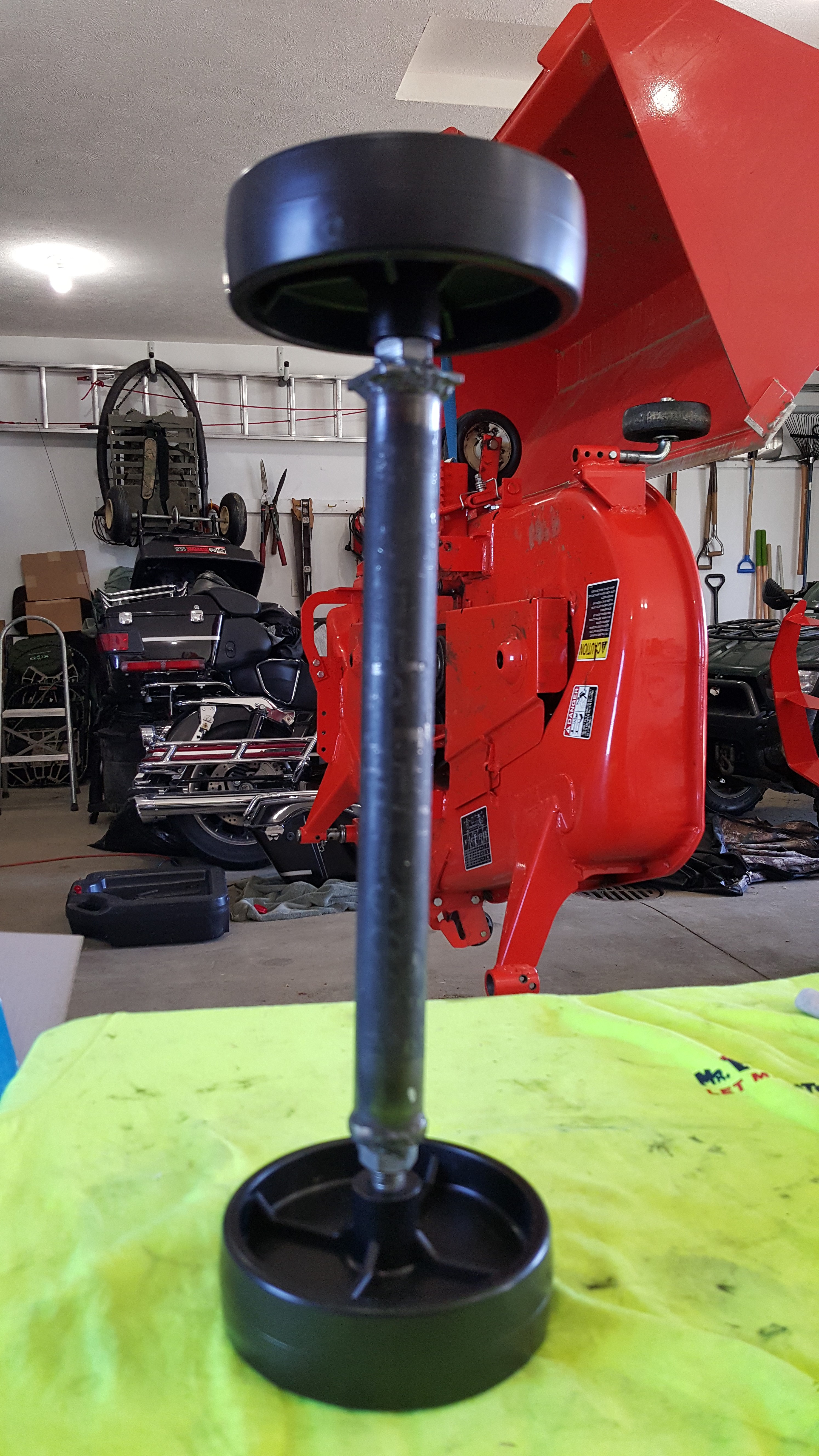

A friend of mine has a B2650 with the 72" deck also. He has been very happy with it. Another fab project I did was to make a set of wheels to store the mower deck upright for the winter. Makes it very handy to store it up against the wall out of the way. It is sturdy enough to pressure wash the bottom of the deck while standing up to get ready for storage.
