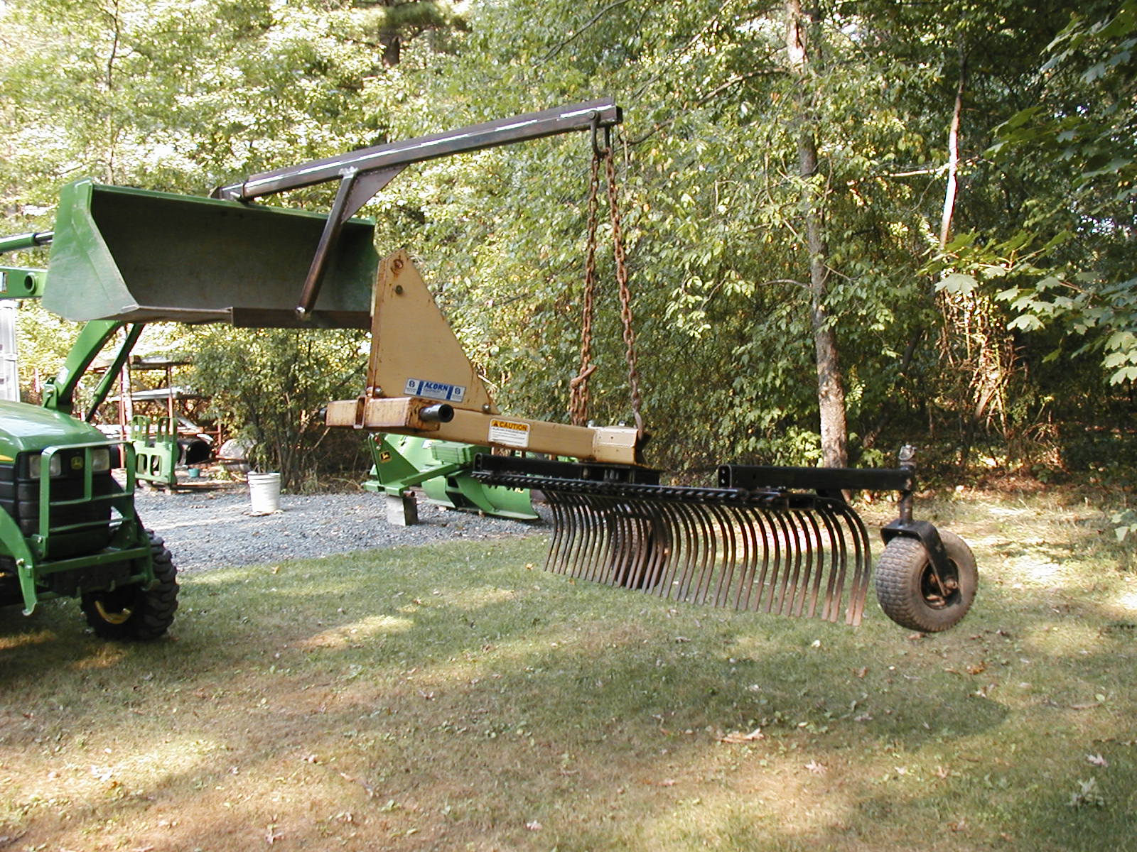

With the bar attached so I was able to to lift and haul all these cut trees to a remote staging area. (a 3 year off and on project) that stretch was unpassable muck before that swalehole was put in.
There's also a slot low under the axle between the rear tires you can insert the bar and secure with a drop pin for this handy tool to become a draw bar. There are situations that arise you want the lowest possible towing center of gravity to avoid flipping the tractor.
You can also put a variety of ball hitches on the holes provided. I suppose the many holes were for the older pre 3PH farm equipment that's still serviceable even today.
It's a very handy device.
Here's another pic of it supporting an easy on/off light tool carrier...after a few incidents with logging chains I came up with that to NOT keep tools of any kind in the bucket.

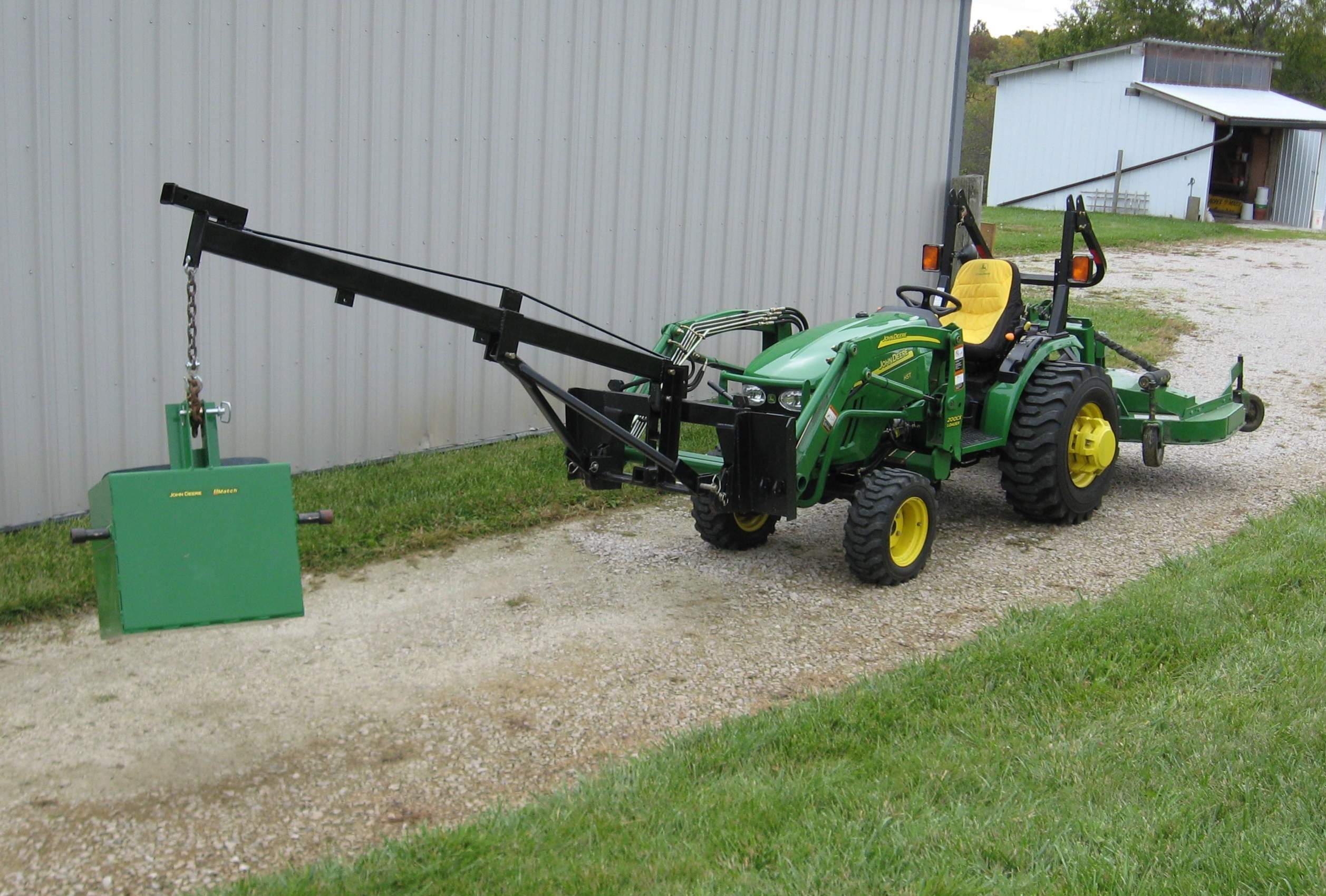

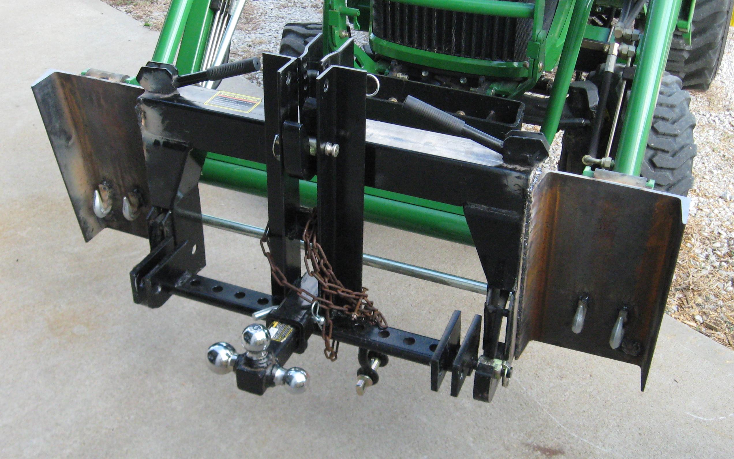

I used one as the basis for my three-point receiver hitch. This hitch also serves several other functions, such as support for my boom pole.
That's an awesome looking boom pole and adaptor.
I love seeing all this multi use contraptions, makes want to go back out to the laboratory and and bring something to life!
I made a boom pole for the receiver on my bucket, not sure of it's capacity but has come in handy, I'm trying to come up with a way to use it on my 3pt QH.
