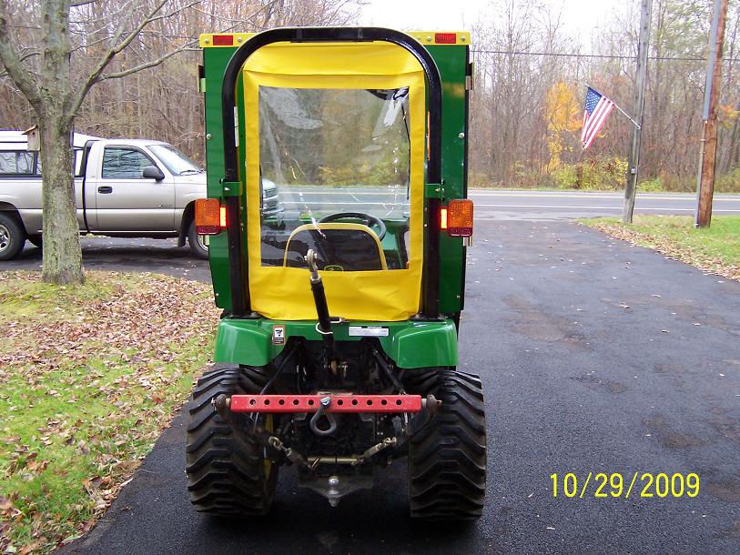

I pin a clevice to mine, and skid logs all winter in the snow. Its great, because you can drop it all the way down, then chain the log tight, then you lift the 3 point arms n drawbar, and all the weight of the log gets transfered onto the tractors rear tires and makes for unbelievable traction. It also keeps the logs from rubbing thru and getting dirty. The heavier the log, the more traction I get! :D

You mean like this?
(That's what I do, too.)

Yep, but I use a chain hook style clevice, so it hooks right into the chain.

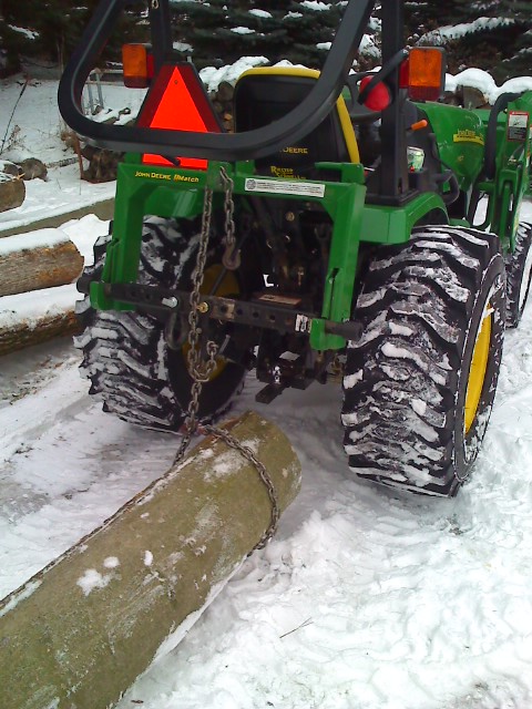

^^^^ exactly how I do it, but instead of a normal Clevis, I have a chain-hook clevice. Instead of using a normal clevis that has a hoop to loop the chain thru, my clevice just has the "grab hook" on the end of it, so i just slip the grab hook of the clevice over the shortest possible link of the chain, and go. No need to wrap all the chain around stuff to use up the extra slack.
maybe this pic will help, its hard to see, so look close!
