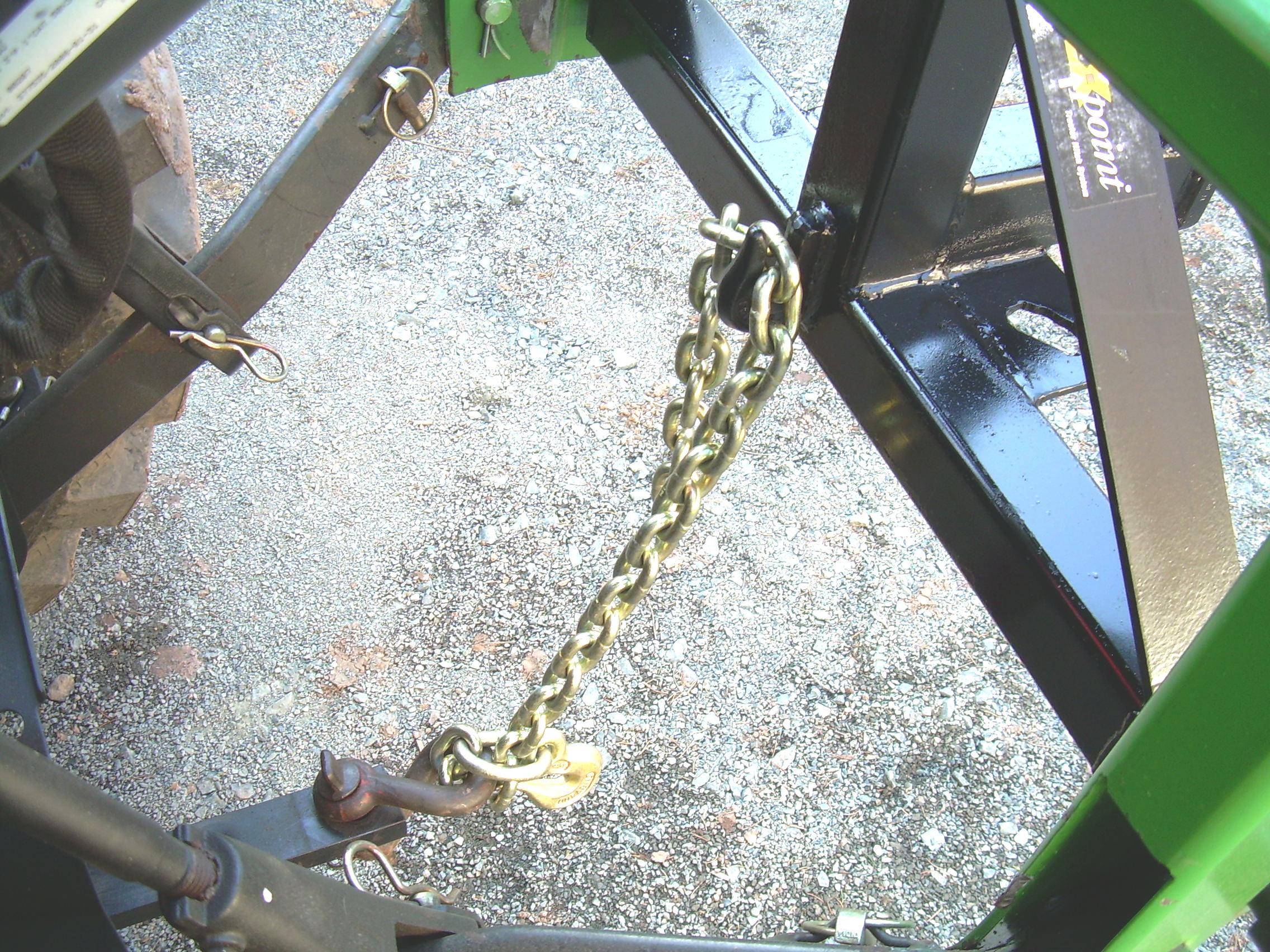

Great thread. I have an additional question. What do you do with a sliding drawbar? I am familiar with the horizontal drawbar, but what do you do with the sliding one? I assume one end attaches to the pin under the PTO at the bottom. Can I bolt the sliding drawbar to the horizontal drawbar and then put a trailer hitch on it without worrying about the bar rolling? Will it effectively keep the bar from going up if I lose tongue weight since I don't have downpressure? Is there anything else you can do with a sliding drawbar?
Not sure exactly what your asking, but don't attach the fixed draw bar to the 3pt Horz bar or your gonna break something.
They make a locking device for the horz bar to keep it from rolling, it attaches to one of the 3pt lift arms and holds the HDB.
Also if your not familiar with that "sliding draw bar", you have to slide it in under the axle and pin it in the middle of the bar. It's not designed to pin at the end and swivel side to side. It should be fixed and rigid.
It comes in handy for safely pulling things by attaching a clevis type device.
JB.

"Will it effectively keep the bar from going up if I lose tongue weight since I don't have downpressure? "
GT,
As mentioned, you probably wouldn't want a rigid connection for this. Most people just attach a chain with some slack in it between the tractor drawbar and the three-point receiver hitch. You still have to make sure you have enough slack to be able to raise and lower a little bit without reaching the limit of the chain. You also have to have the chain short enough to keep the hitch from reaching the upper limit.
   / Please Explain the use of a ToolBar/Drawbar #19
GT,
Yeah, I read "bolt and it scarred me. It wouldn't reach to bolt them anyway I guess.
I do the chain thing as when I dump a 5 ton dump trailer it puts a tremendous upward pressure on the hitch just before it unloads.
JB.
