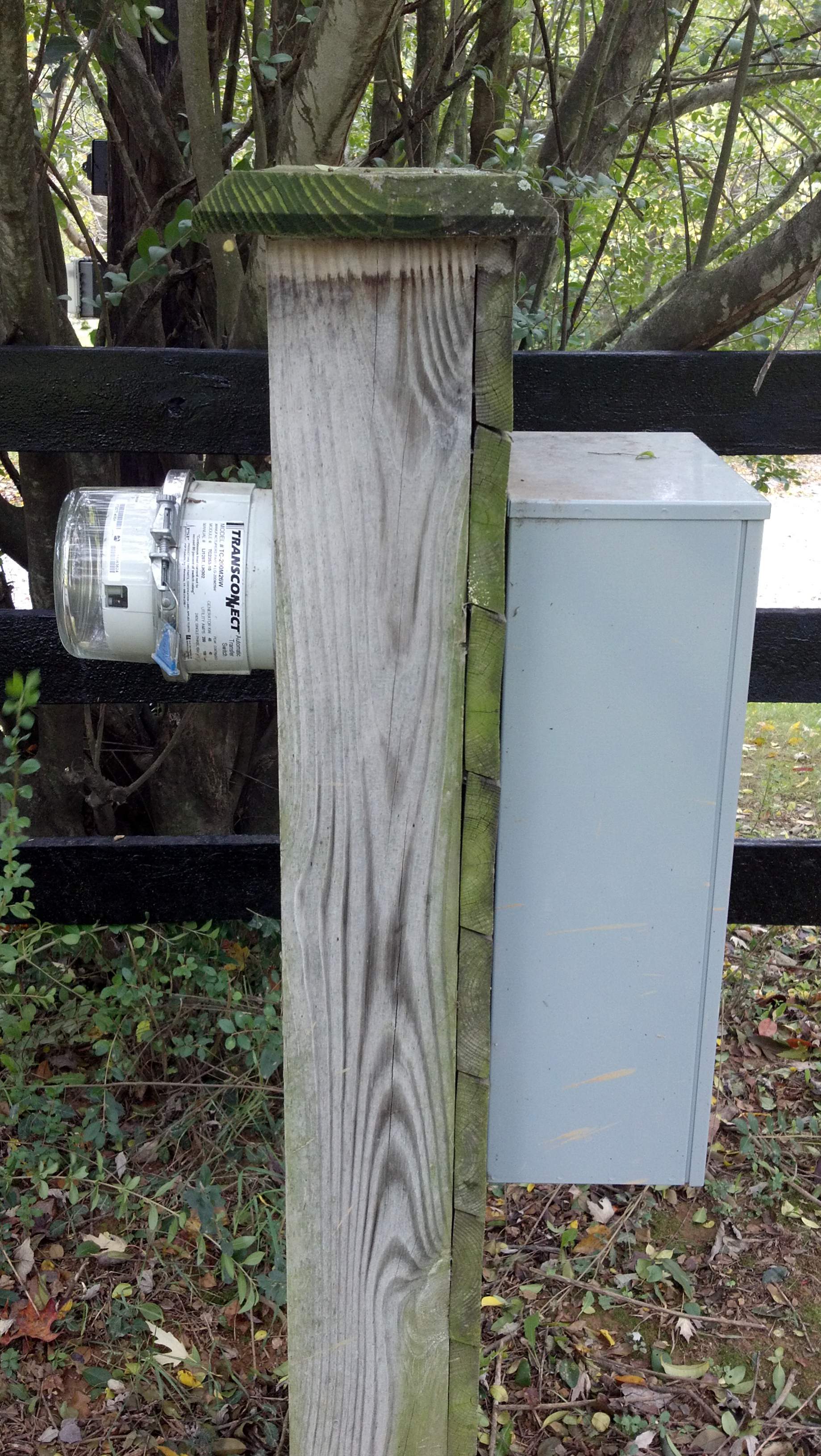

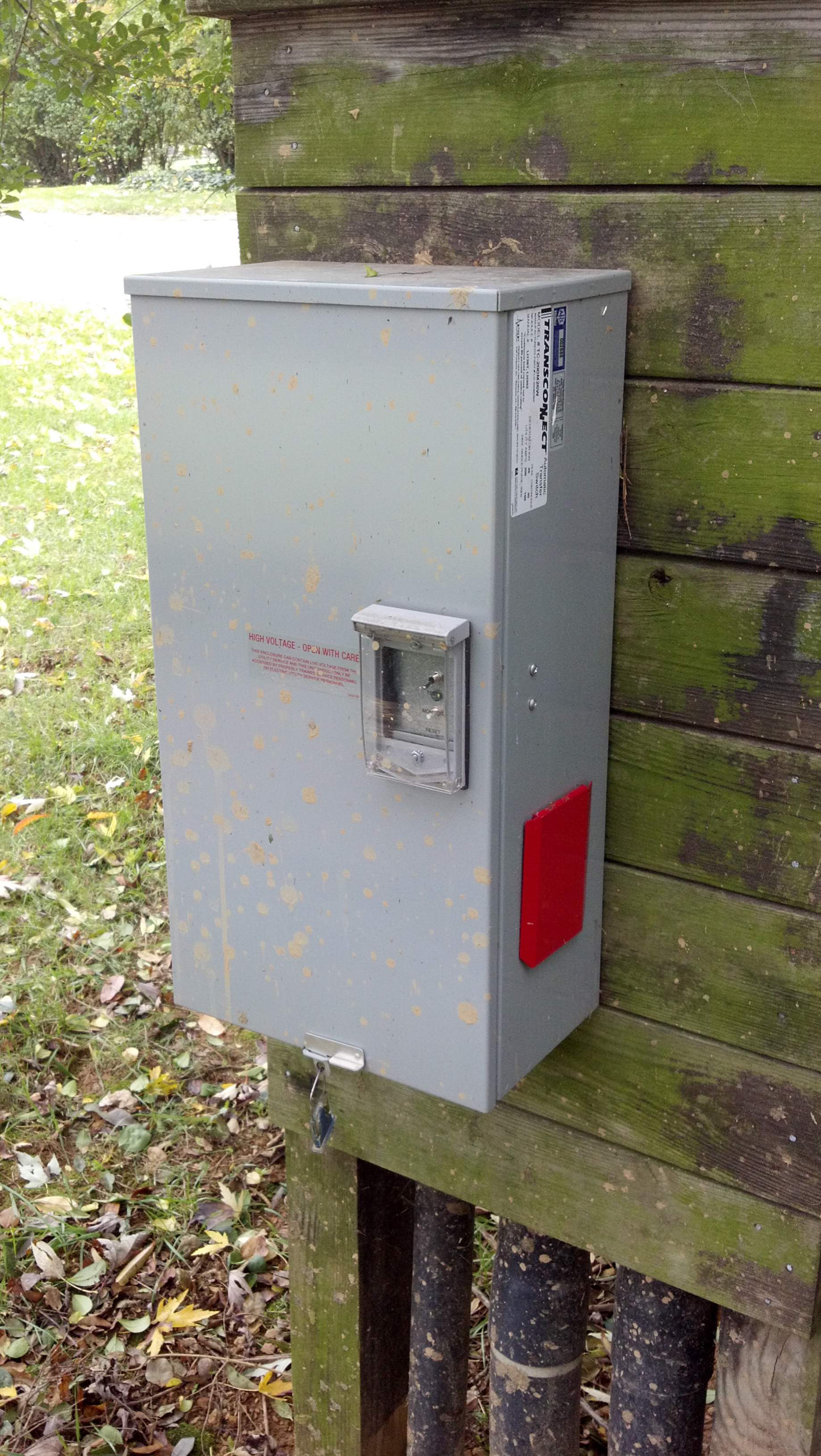

Hi Mike,
On your TC-200M26W meter base transfer switch, is the feed going to the generator coming up though one of the conduits inside the meter base enclosure? It doesn't appear to be external like on the Generlink.
Here's what my meter base looks like:
I wonder if that Transconnect transfer switch will work with it?
Here's a shot from 2005 when I was running the house on the PTO generator. It would probably not have been as bad if I had the proper receptacle installed by the meter base. I'm pretty sure the way I had it hooked up (see picture above), was not up to code.
Howdy,
The connection is actually run back into the meter box and is tapped into the box on the back of the mounting.
click the picture for a zoomed larger picture.
It is a 2 piece design. If you look at this pdf from thier website, you see the 2 piece design. TC-200M26W pdf You would just have the 2nd box mounted next to your meter with its pigtail either back to the collar, or wired back into the unit with short piece of conduit feeding to the 2nd box which houses its brains. (electronics)
and, the TC-200M26W unit favors utility power. That means when the utility power is restored, it waits a short while to make sure its a steady 60Hz and 120 volts on each leg, then transfer back to it. That is when the power blinks off for about 30 seconds, and then comes back on from the utility. :)
