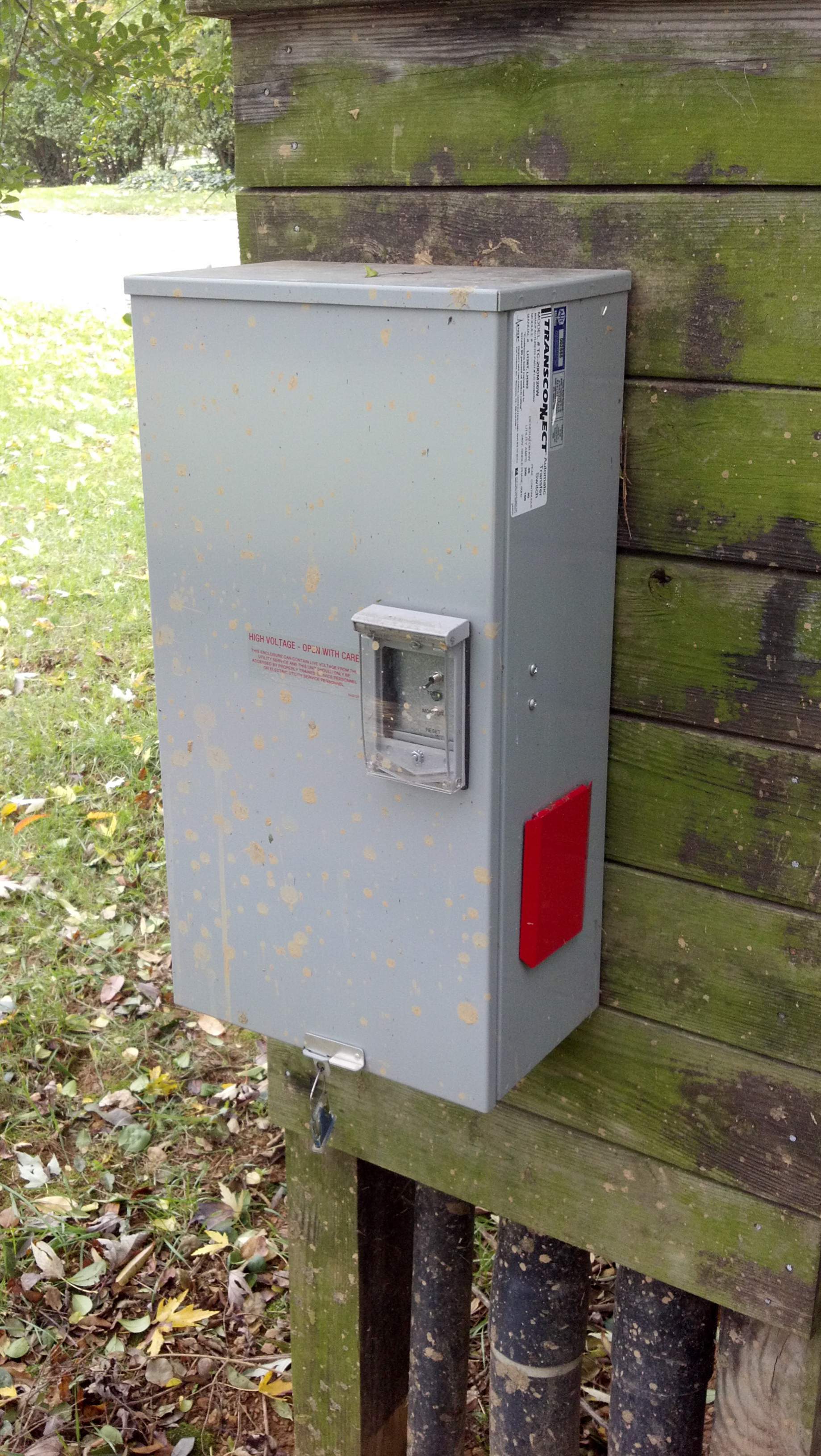

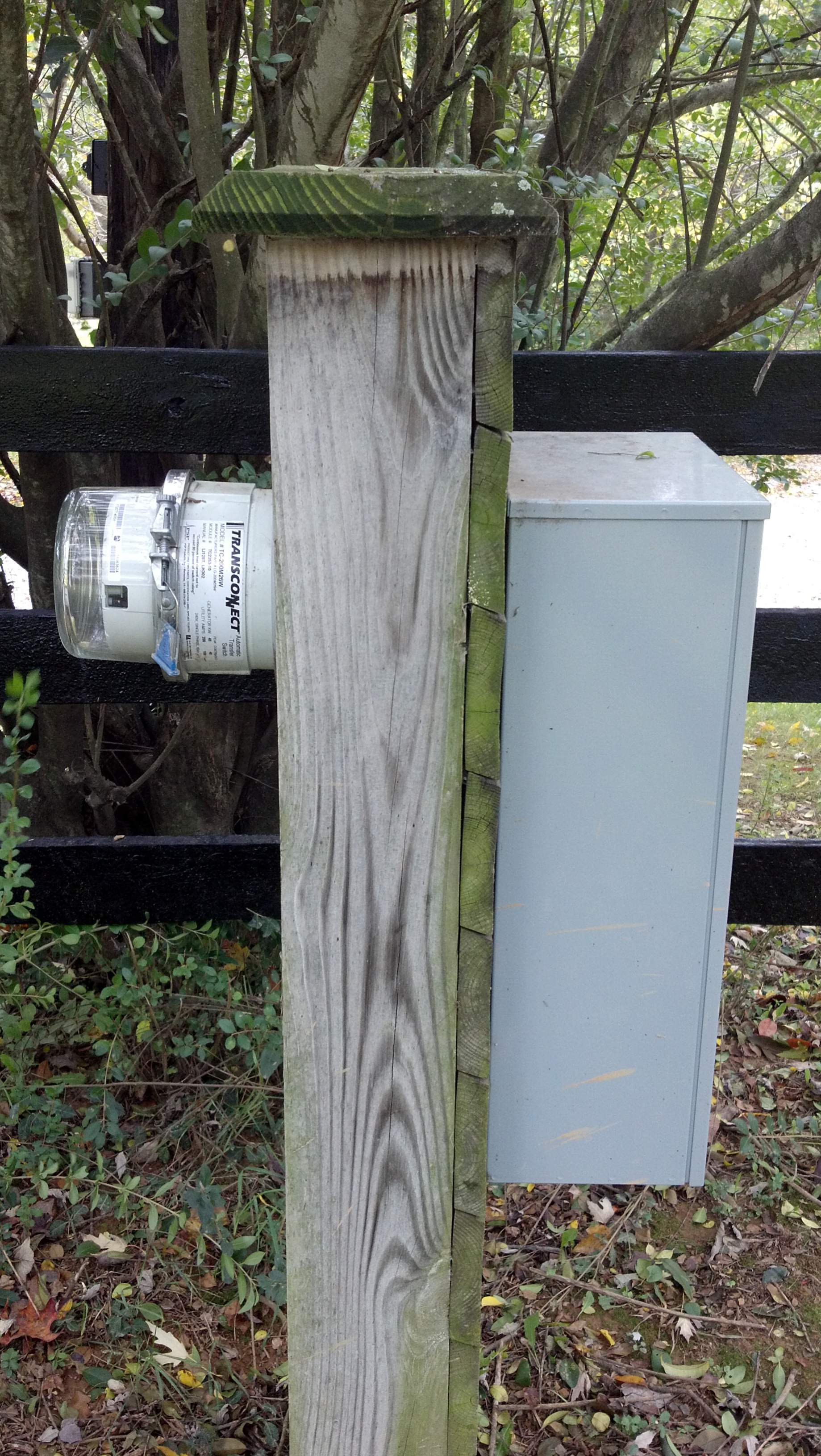

Howdy,
The connection is actually run back into the meter box and is tapped into the box on the back of the mounting.
click the picture for a zoomed larger picture.
View attachment 272582View attachment 272583
It is a 2 piece design. If you look at this pdf from thier website, you see the 2 piece design. TC-200M26W pdf You would just have the 2nd box mounted next to your meter with its pigtail either back to the collar, or wired back into the unit with short piece of conduit feeding to the 2nd box which houses its brains. (electronics) and, the TC-200M26W unit favors utility power. That means when the utility power is restored, it waits a short while to make sure its a steady 60Hz and 120 volts on each leg, then transfer back to it. That is when the power blinks off for about 30 seconds, and then comes back on from the utility. :)
Got it. Thanks!
How does the cost of this unit compare to, say ~$2000 for a "regular" 400A transfer switch?
   / Please post your generator choice and experiences #65
Got it. Thanks!
Howdy,
This link is from the utility for the prices they have. rec-electrical-services
A regular 400 amp transfer switch $2,400, electrician to install $200-800, permit $100, utility to pull meter and re-install, any other expenses.
PSP Products TC-200M26W was installed by the utility in about and hour, makes it easier to power all my dual 200amp panels at house, 100 amp panel at barn, 100 amp panel at shop, 60 amp panel well. One central hookup, to everything.
