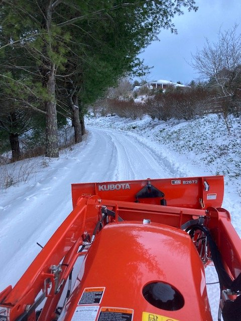

Headed down our drive plowing; a hill is on the left and a ravine is on the right below the pines:

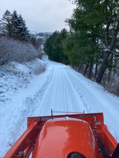

Headed back up our drive, not plowing while climbing, only on the descent:
